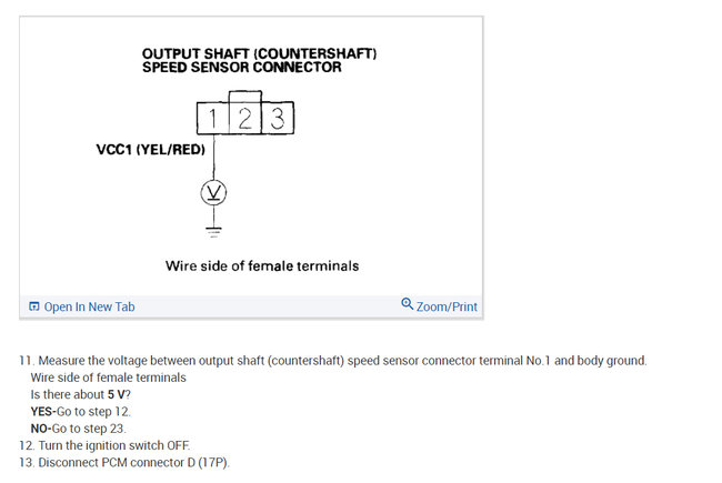

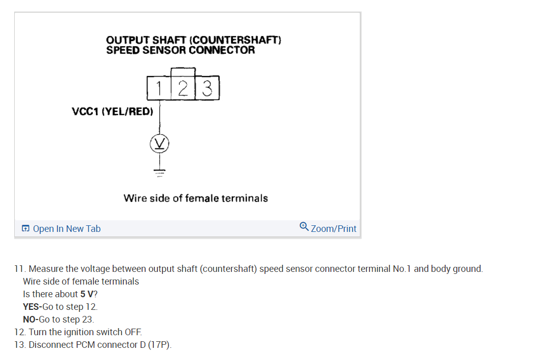

i replaced the output shaft sensor i had to drill it out and now it wont move or delays shift or not at all like it's not registering gears.
Sep 3, 2021 at 3:10 PM
Good evening,

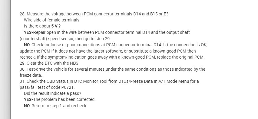

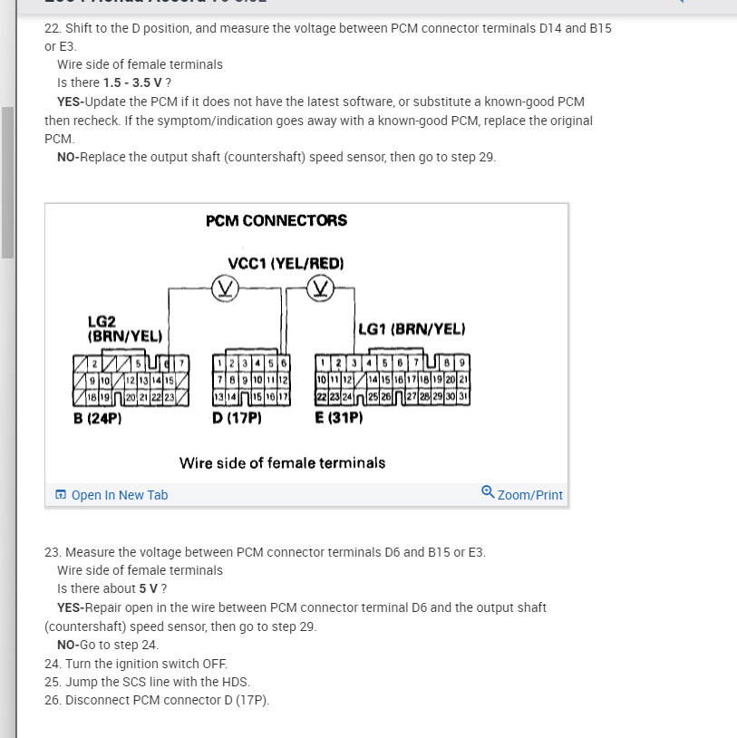

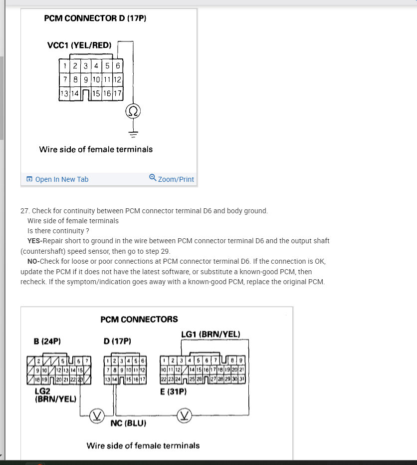

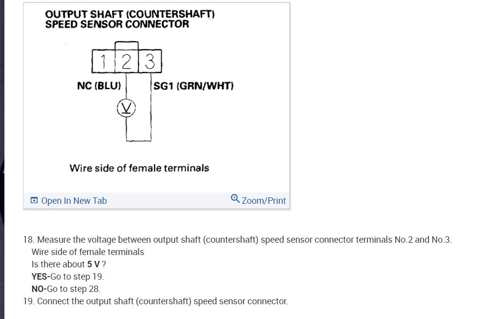

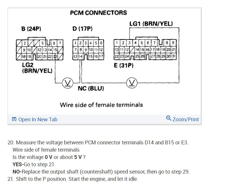

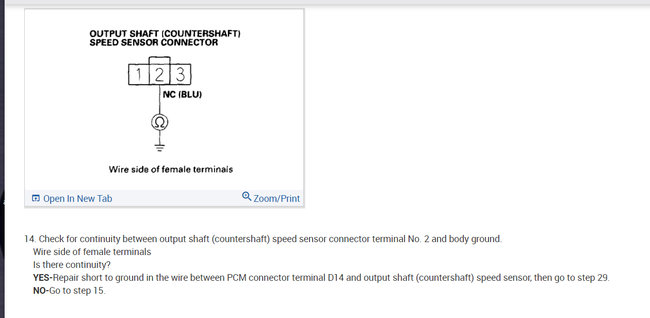

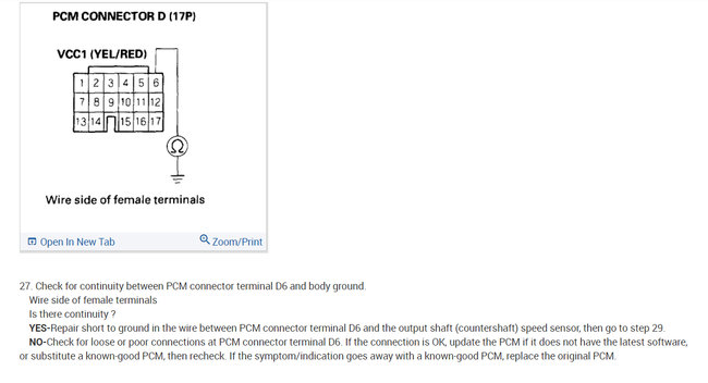

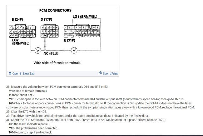

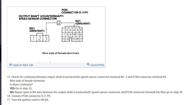

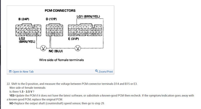

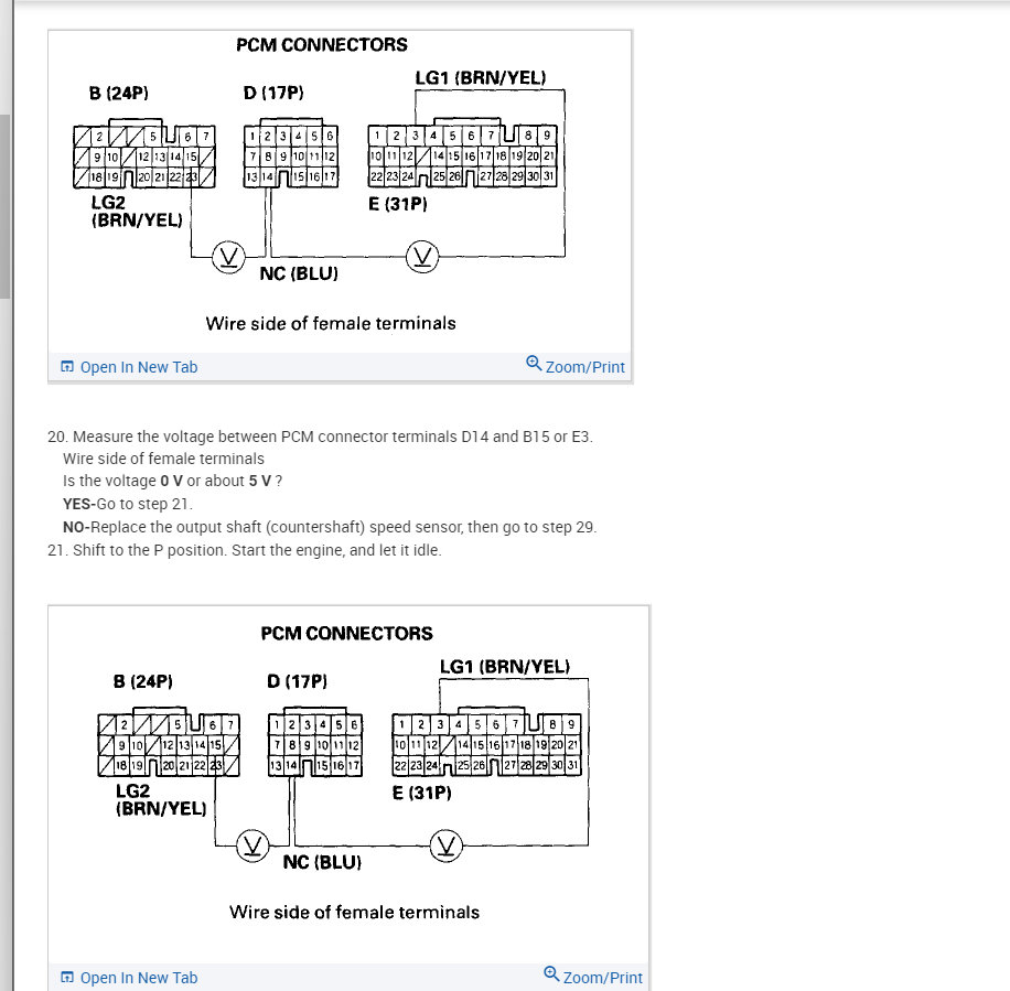

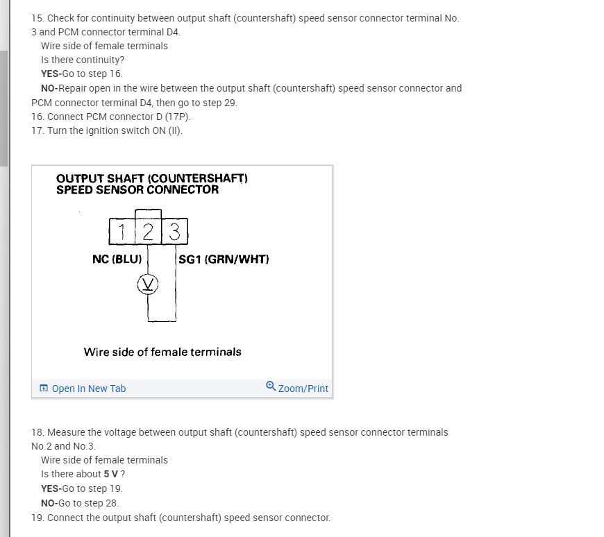

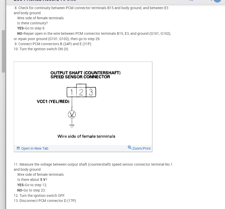

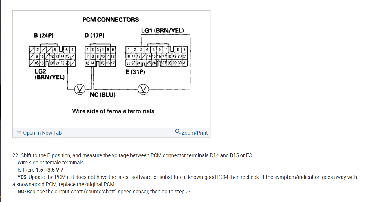

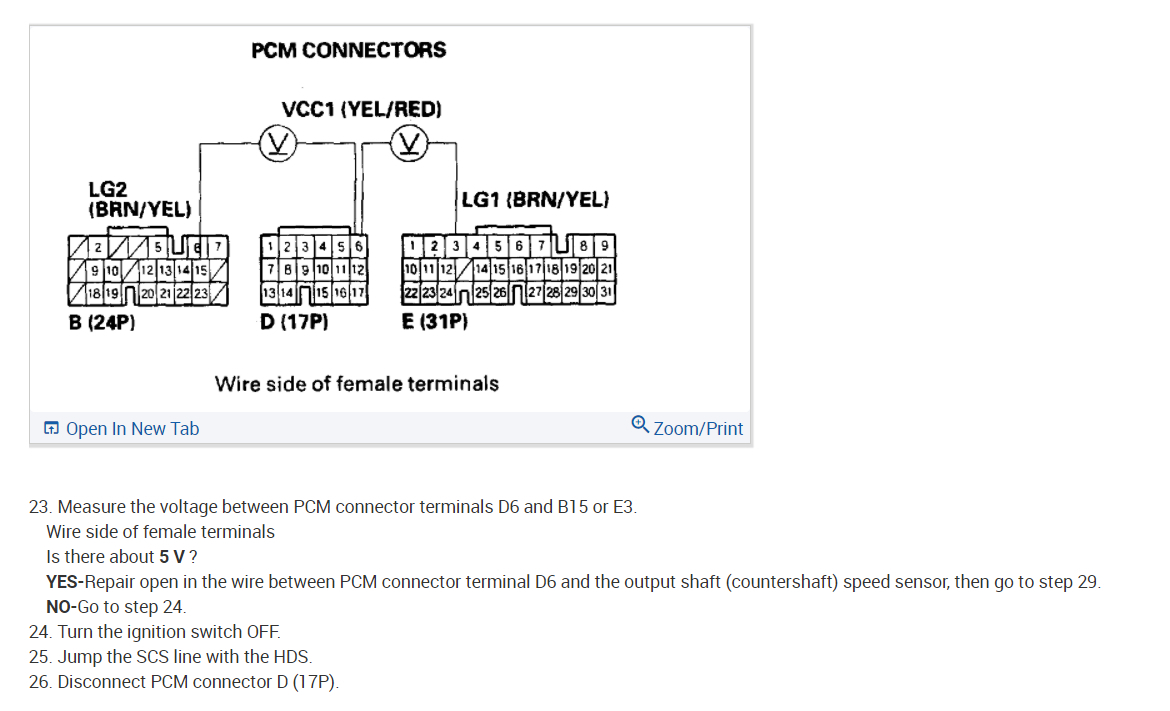

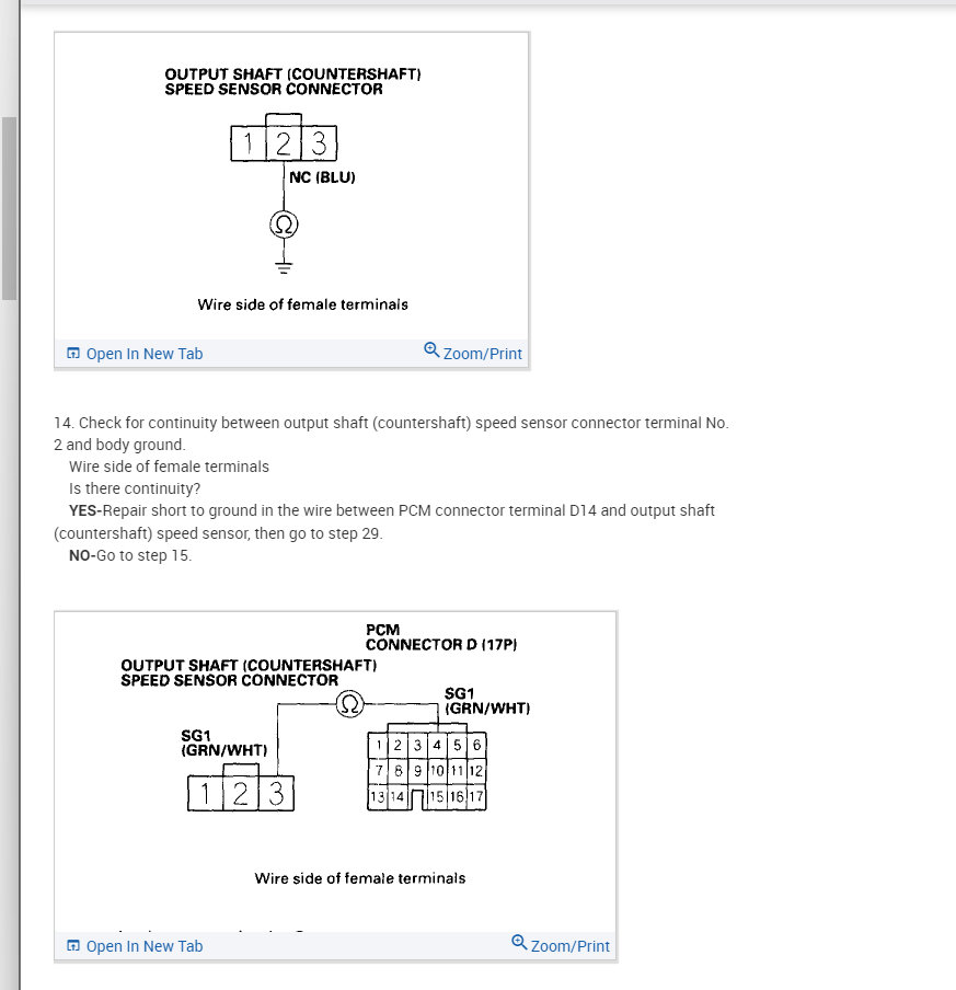

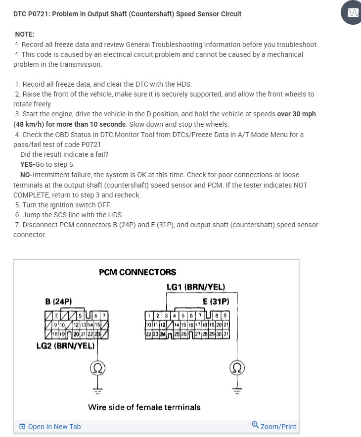

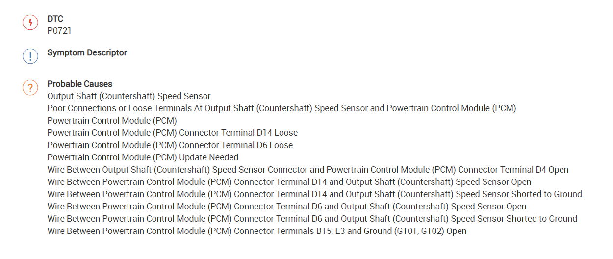

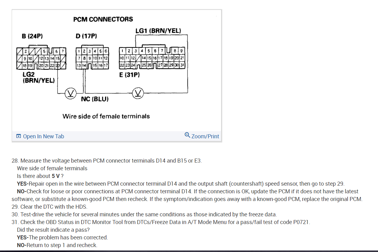

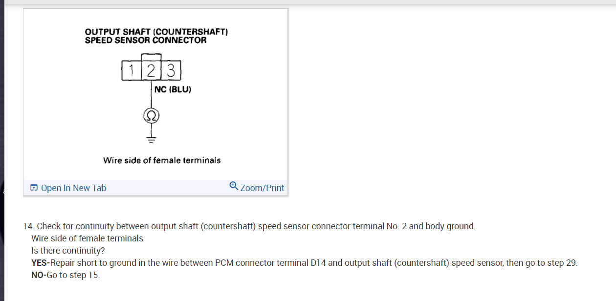

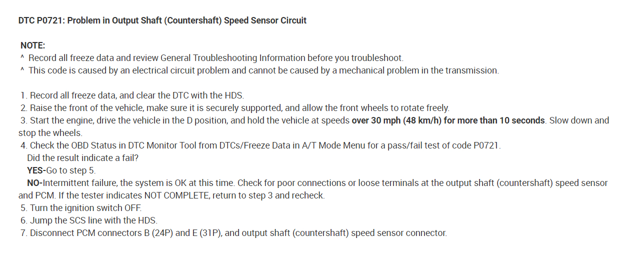

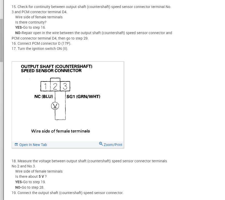

The 721 code is for the output speed sensor circuit. It could be wiring but if it moved prior to you replacing the sensor, I doubt that it is it.
Are you sure you did not damage anything inside the transmission when you drilled it out?
I attached the flow chart for you for the code below.
Sep 3, 2021 at 5:47 PM

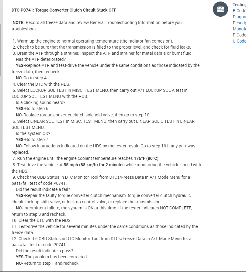

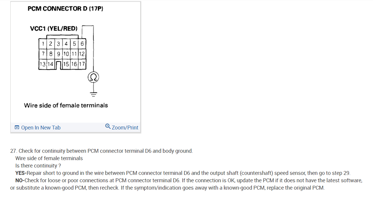

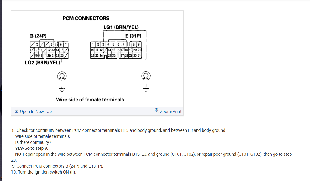

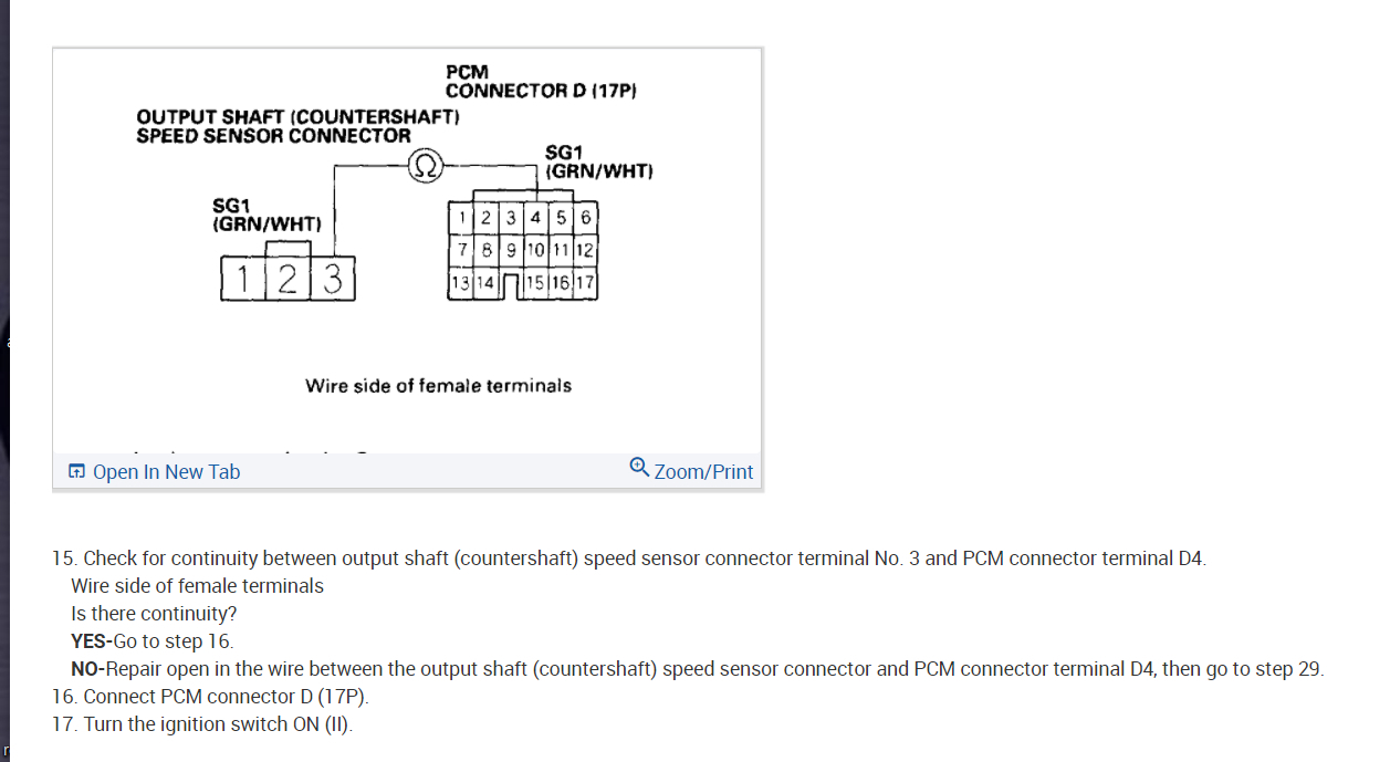

The P0741 is for the torque converter clutch solenoid getting stuck off. Clearly this is going to be related, so I attached the testing below.
However, the P0721 is the one we need to chase. I am attaching this testing as well.
Here is a guide that will help with testing the wiring:
Please run through the info below and let us know what you find.
