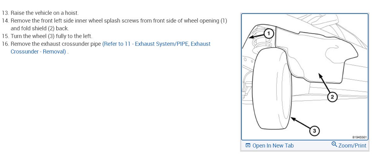

Transmission not shifting, codes P1745, P0933, and P0869?
2015 DODGE CARAVAN
182,000 MILES • 3.6L • V6 • 2WD • AUTOMATIC
KAMEEL HALLOUL

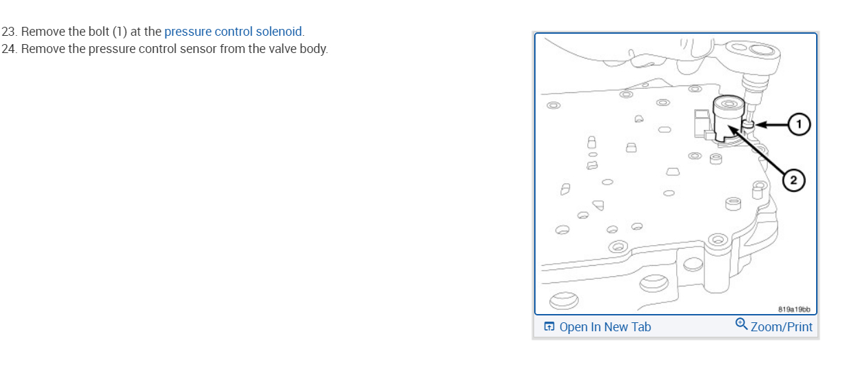

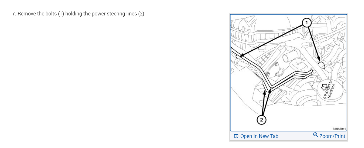

The transmission is not shifting, and I have a few codes popped up: P1745, P0933, P0869. What needs to be done?
Apr 23, 2023 at 12:28 AM
  • 55,423 POSTS

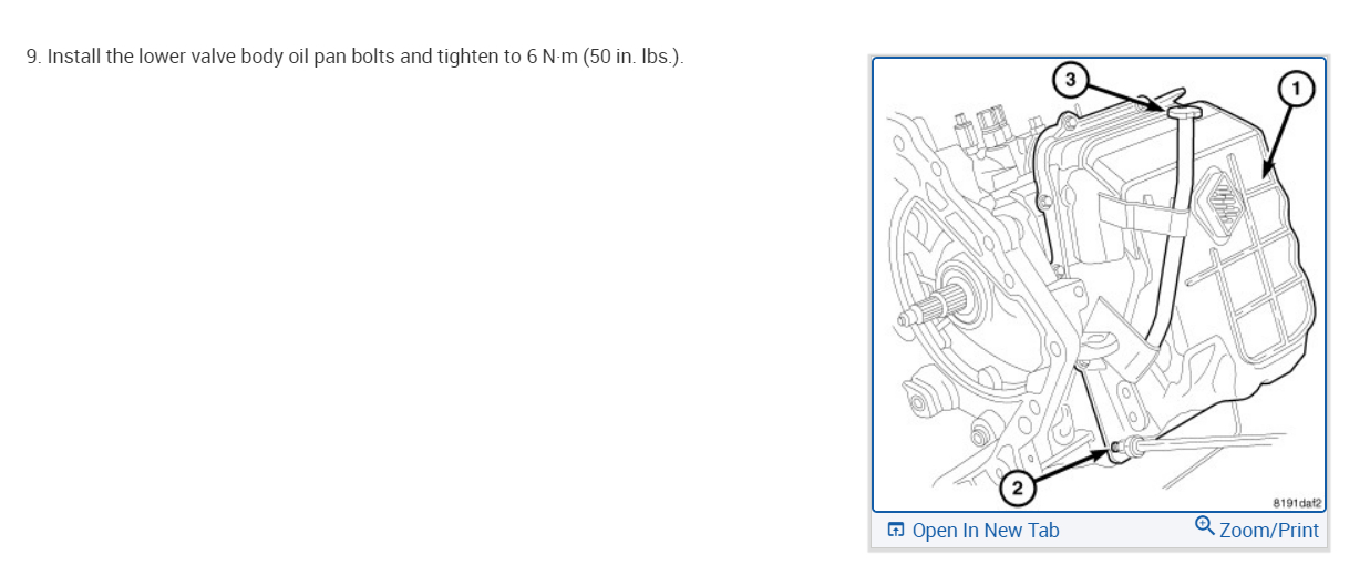

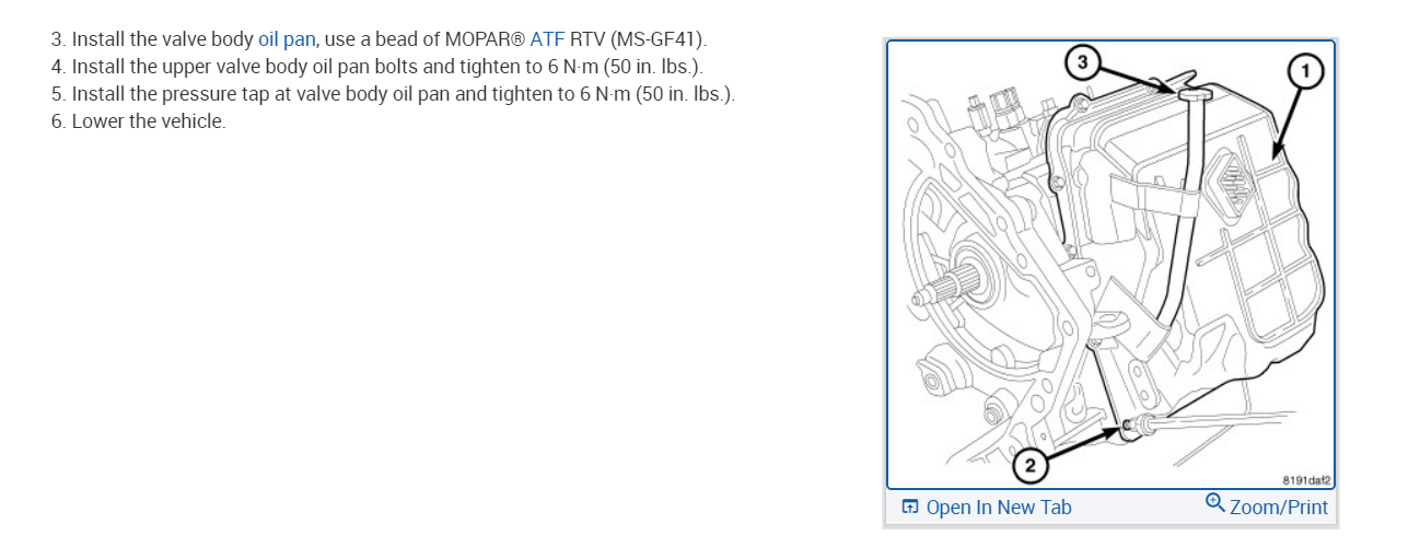

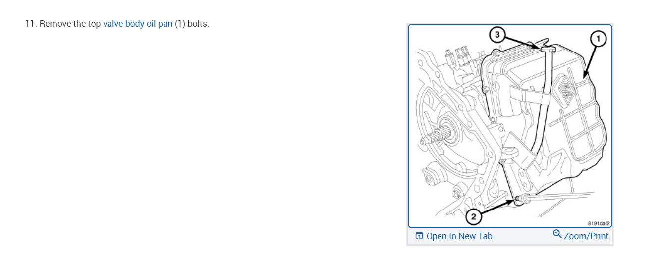

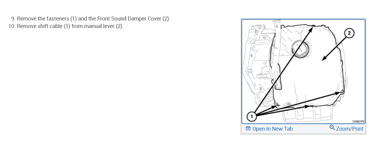

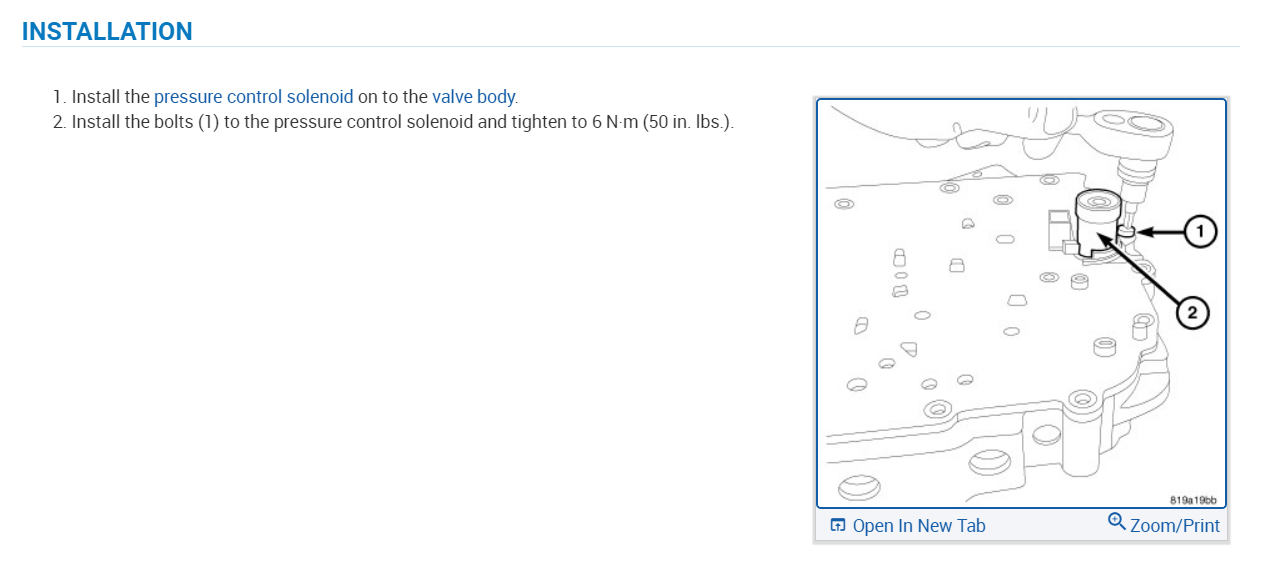

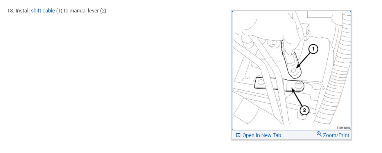

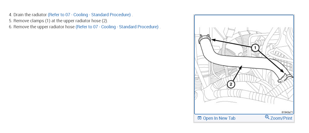

Here are the code definitions:
P1745 - Transmission Line Pressure Too High for Too Long:
P0933 - Hydraulic Pressure Sensor Circuit High Input:
P0869 - Transmission Fluid Pressure (TFP) Sensor Circuit Intermittent:

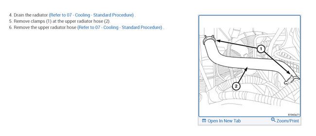

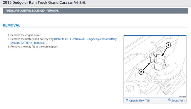

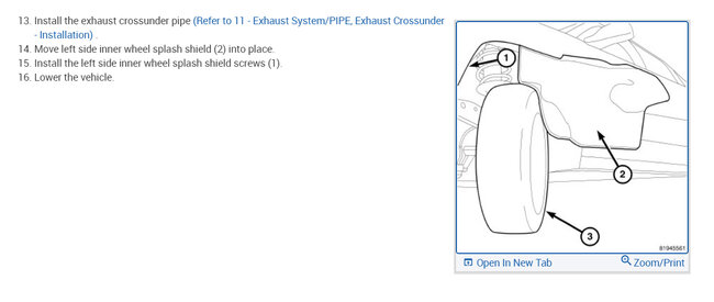

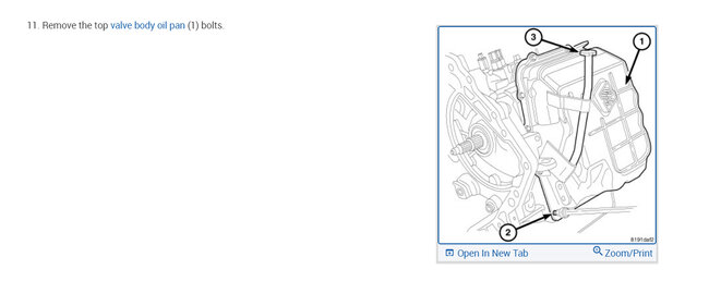

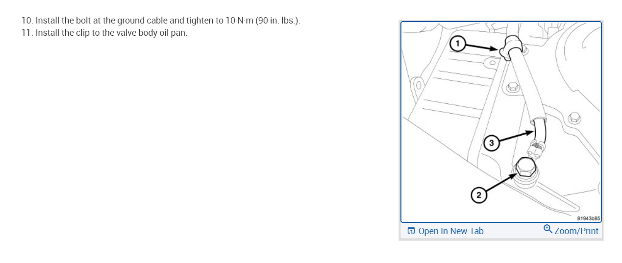

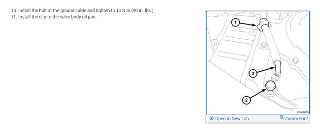

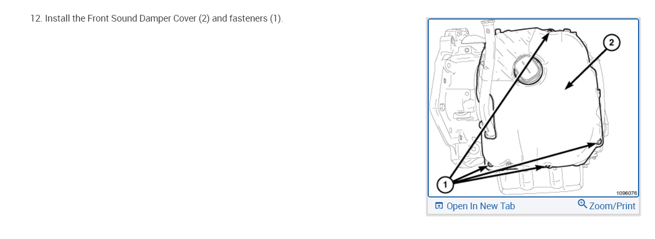

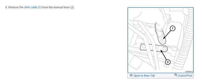

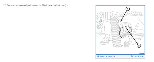

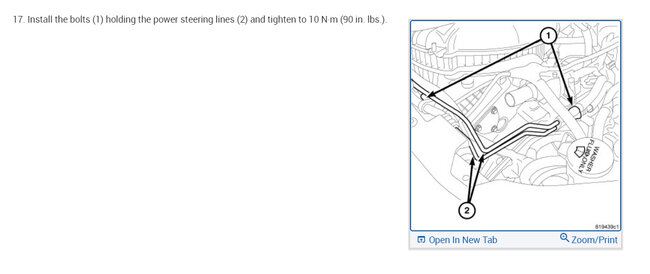

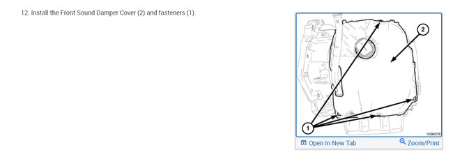

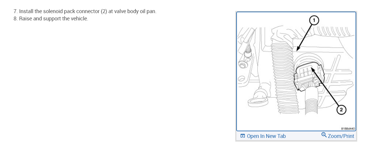

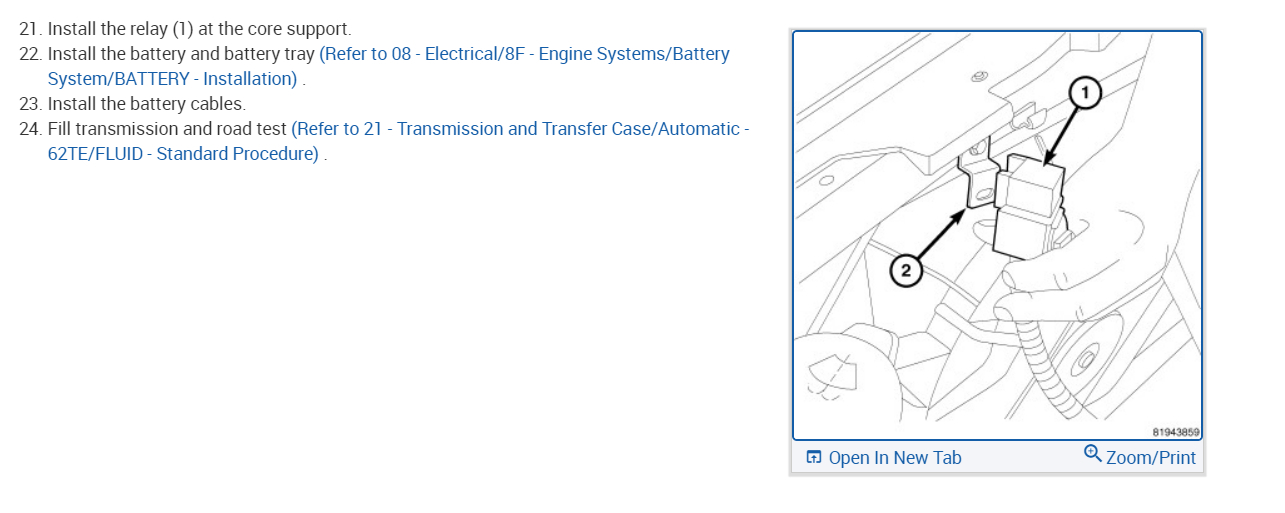

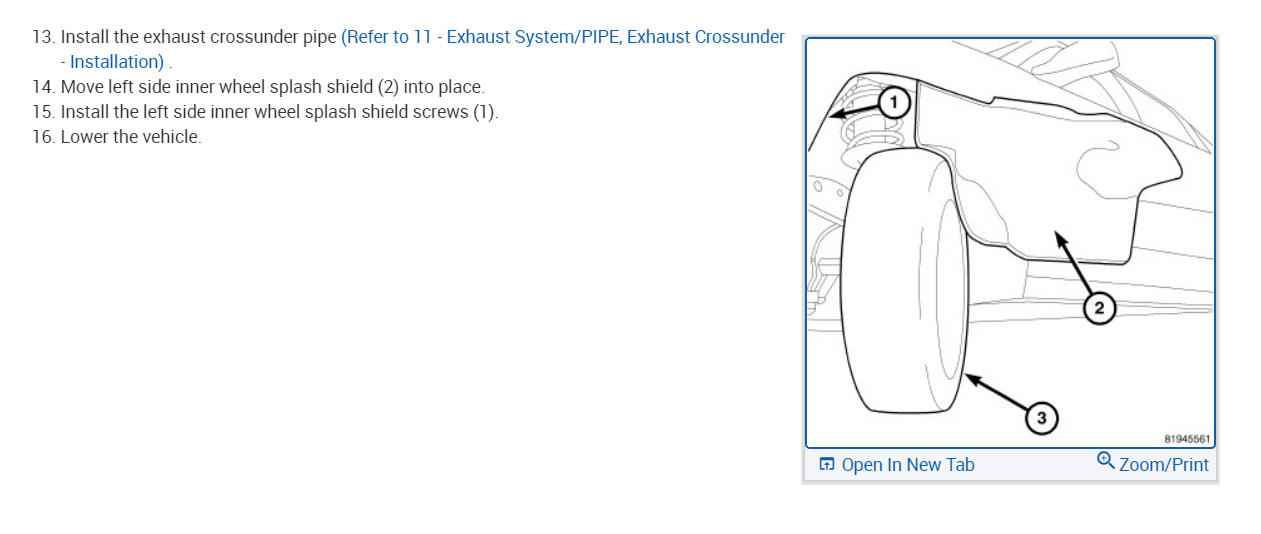

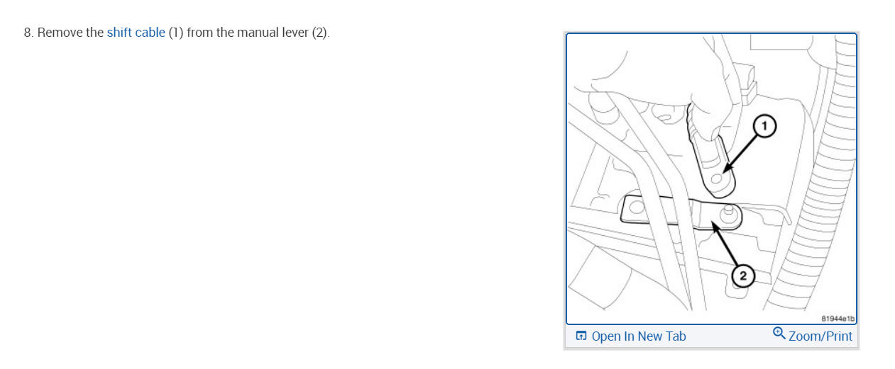

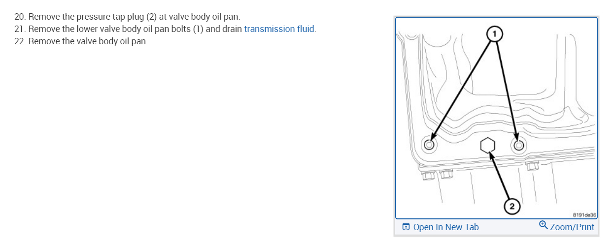

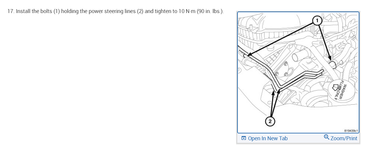

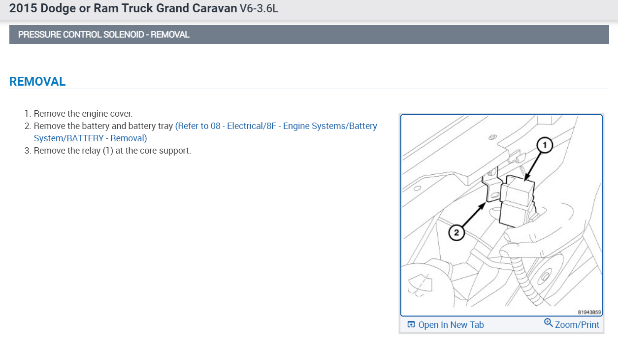

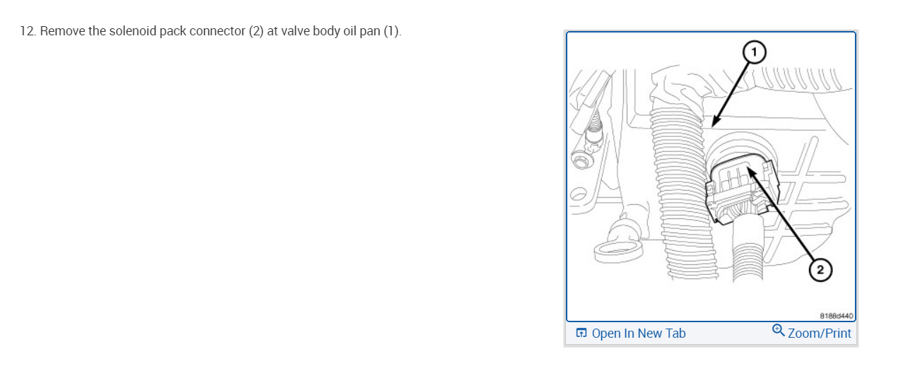

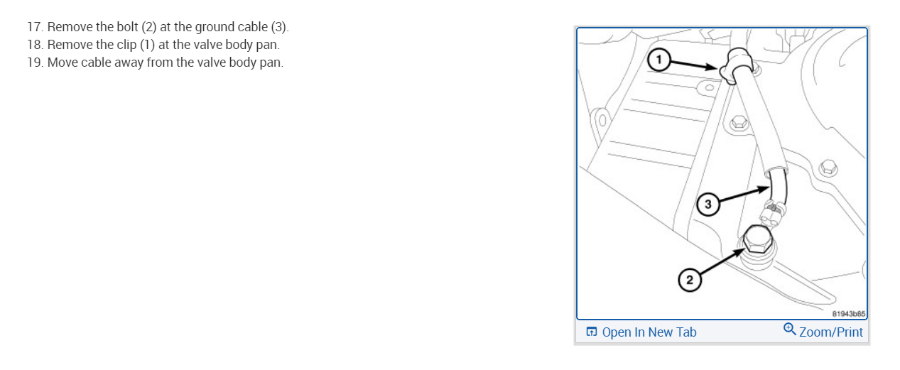

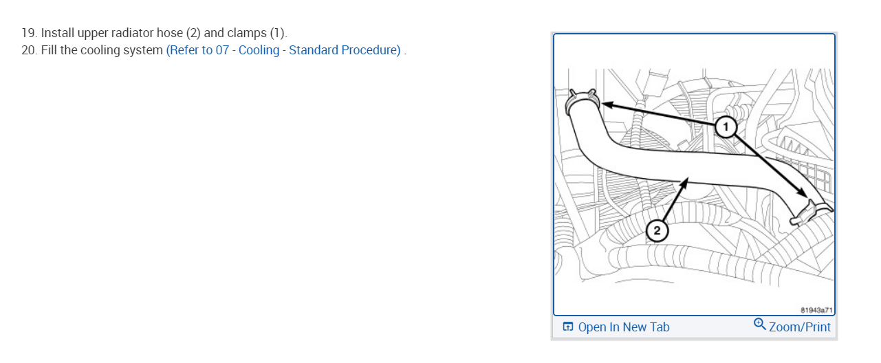

I would check the transmission fluid level and if okay here how to change the pressure regulating solenoid out for a new unit. Check out the images (below). Please let us know what happens.
