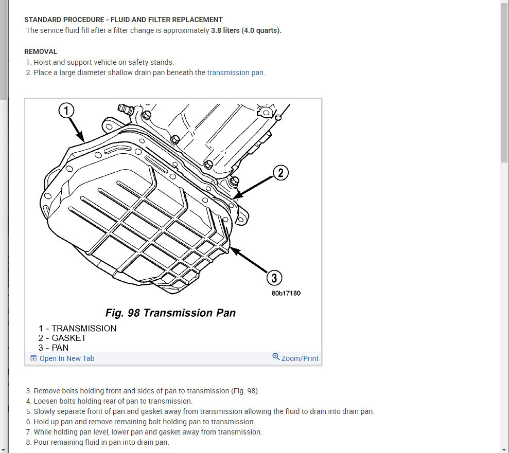

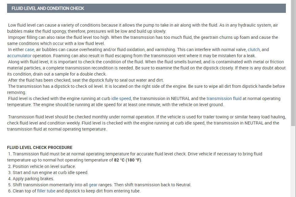

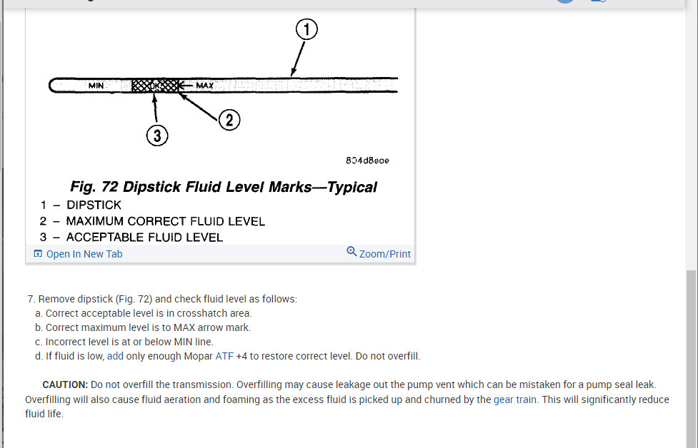

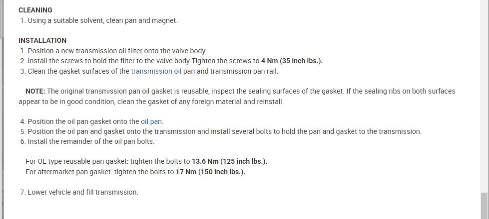

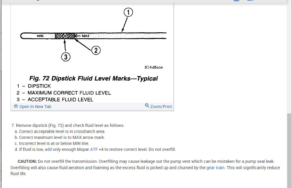

The most common cause of this is low fluid or poor condition. So let's start with checking the fluid level and condition.
Please see the process below and let us know what you find on this.

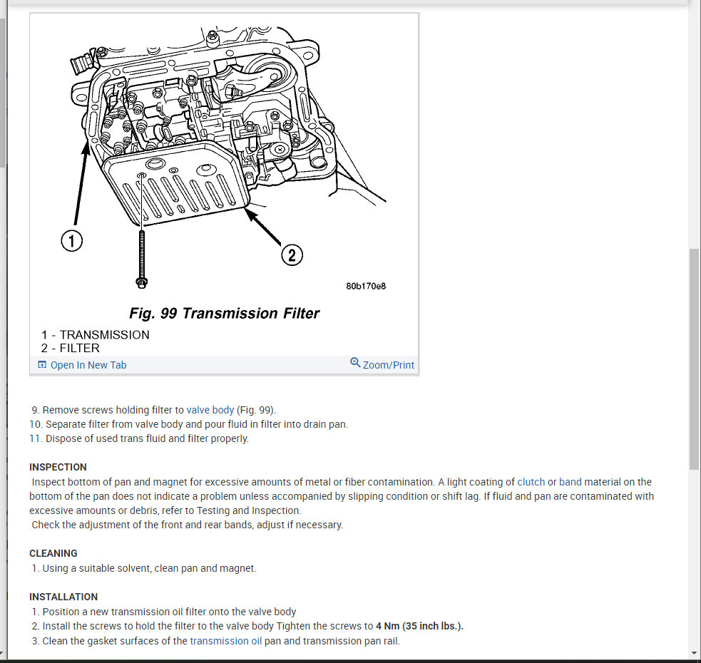

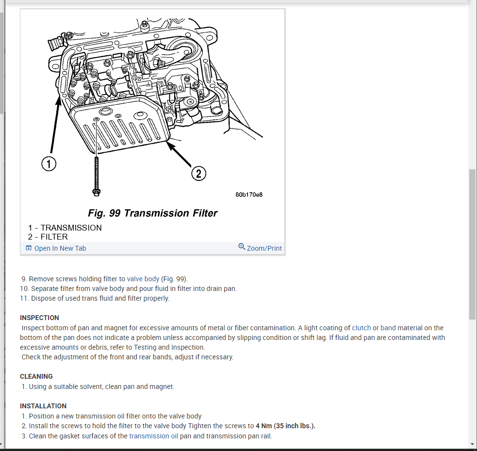

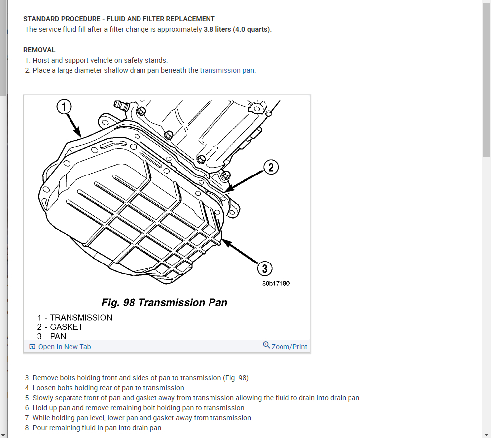

If the fluid is not the issue then we may want to change the filter if you have not done this in a while. This process is attached below as well.
The fact that this happens so intermittently, it would make sense that it is fluid related so let's start with this and go form there.
Thanks

My fluid was checked yesterday while cold and it was on the max line and it was ink not dark.. I have owned my truck for 3 years have never serviced the transmission..

I am going to check it while it's warm..
Aug 7, 2021 at 12:43 AM
Okay. Yes, it needs to be hot or the reading will not be accurate. I have found on these trucks that if they are low they do not show it when cold just because the do a pretty good job of draining back to the pan.
So it needs to be hot and running to get an accurate reading. Even if it is not to the full/max line, I would fill it to that line just to be sure that filter is not sucking air. I had a 1998 Dakota with a sister transmission to yours and that is what would happen. The only difference was it was only momentary and then it would bang back into gear. However, it would act like it was in neutral and just rev. Is that what yours does when it stops shifting?
I figured it out because it seemed to do it mostly on hills and fluid is the only thing that knows you on a hill as it rolls to the back of the pan away from the pick up.
