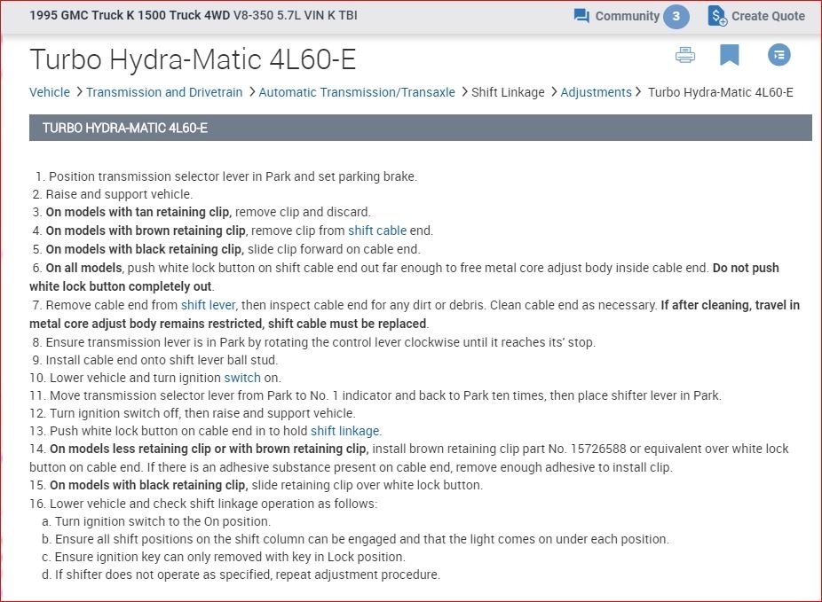

I have a k1500. My transmission will not shift unless red lined. First to third. Skips second and haven't tried for over drive. When I go from park to reverse, neutral, drive etc. Reverse the little marker goes away, neutral is drive, drive is third, third is second. There is no 1 option. Any ideas? No check engine light. I'm at a loss for ideas on what to do.

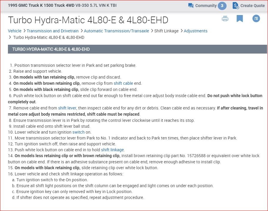

It sounds like the shifter is out of adjustment if I am reading this correctly. This can cause shift issues because the manual valve in the transmission is not seated in the correct location which will not direct the fluid to the correct location inside the transmission.
Go through the adjustment procedure first and then retest the transmission. If there is still an issue we can go from there. I attached the procedure for both transmissions because I don't know which one you have.

On my transmission where the linkage is. It is angled more at a angle like this, but there is also a black box behind it, but I didn't see one in the pictures. Upon research I believe it is a neutral safety switch? It is either a 4l60 or 4l60e but pretty sure it is the E model. Do I just undo the cable and move that little black bar that hooks up to the cable? I'm sorry I'm not too familiar with this.
