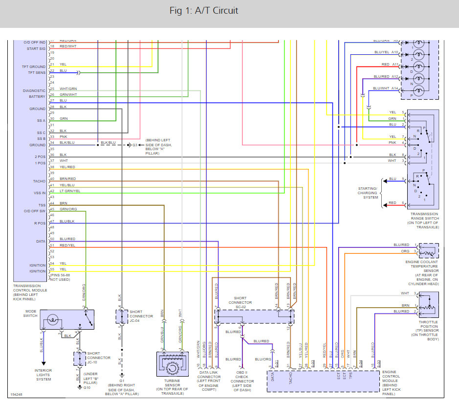

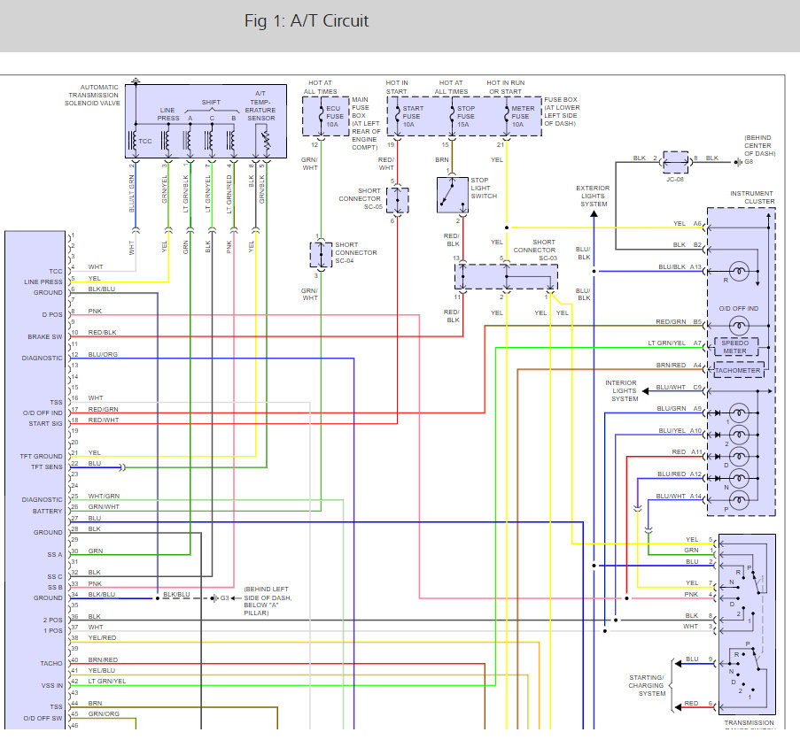

It sounds like you have a shift solenoid that is not working. I would test through the winding's to see if there is continuity. Also, check the four fuses that run the system. You can see which ones from the diagram below.
Here is a guide to help us get started:
Also, there is a ranger selector switch I would test as well.
Here is the transmission wiring diagrams so you can get started.

The wiring diagram shows five solenoids? Can you upload pictures oft he valve body so I can point them out?

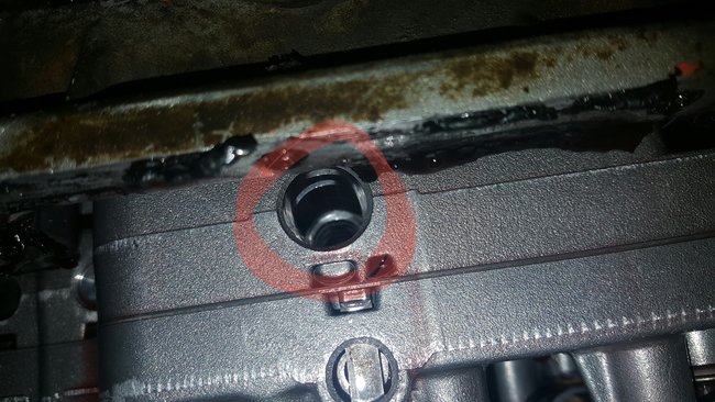

dear,
this is my valve body, totaly it is only 4 solenoid, 1 for tcc , 1 for pressure cotrol solenoid and 2 for shift solenoid, dont understand hiw shift work with that 2 solenoid. on more think i just notice that my actual valve body was missing (just a hole but nothing there) the one at the re circle, what it is function and what if it dont have that one?
thank you
sothy
Feb 19, 2018 at 7:44 AM
  • 55,432 POSTS
The hole is weird there was nothing in the pan that maybe has fallen out?

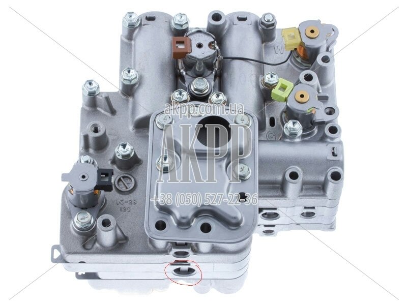

Dear Mr. Ken
Yes that is weird cos i see the other valve body the same to my car was fill with some cover (the first picture), but what its function and what happen when it is dont have like mine?

Not sure. there was nothing in the pan like someone put it together that way? Maybe is for a extra gear like 5th and you don't have it?

i dont know but i have checked the same valve body only that thing is different from mine. same make same year same model, but the differrent is only that one. and i have change all the solenoid but its has the same issue.

so if i have the spare part for that hole, i should be place. thx u very much

Did you do the rebuild yourself? Seems like a valve is missing from the area mentioned.

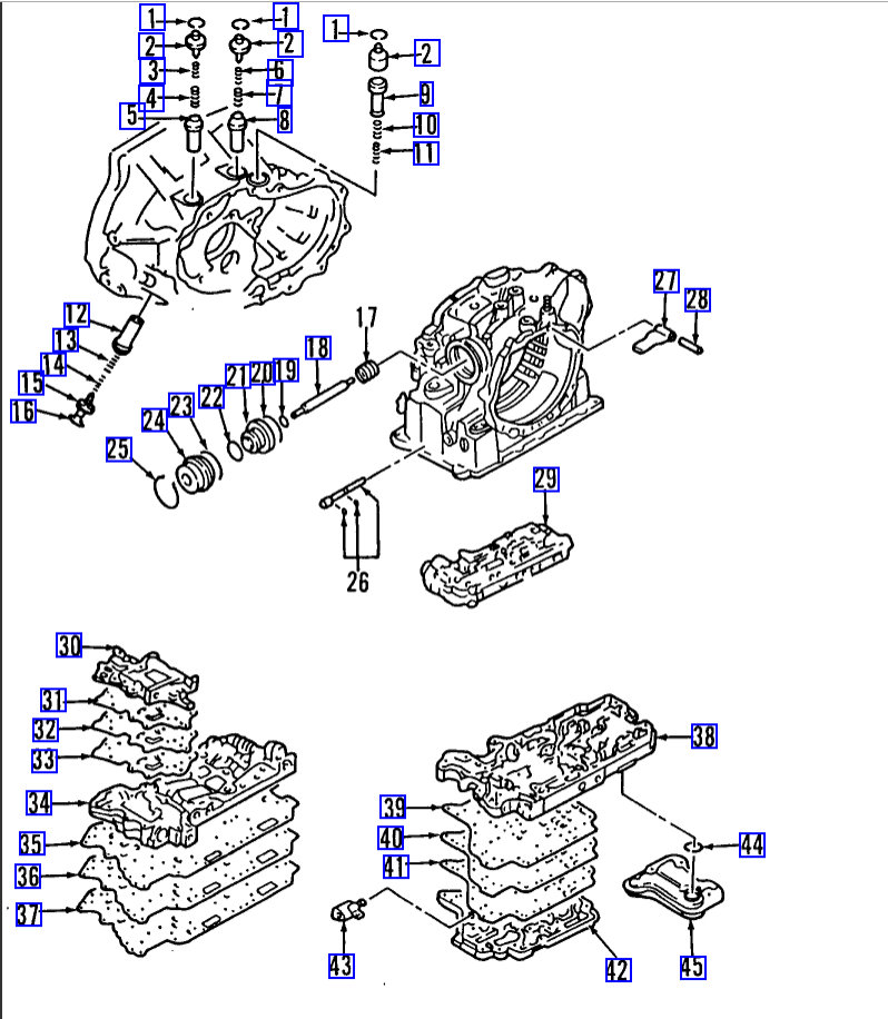

I would try a rebuild valve body and look to see if there is a difference.
Here is a diagrams on how to change it out.

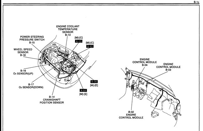

O man, that can cause the issue for sure. I would replace the sensor here is a guide to help show you what you are in for when doing the job.
https://www.2carpros.com/articles/coolant-temperature-sensor-cts-replacement
Here is the location.
Please run down this guide and report back
