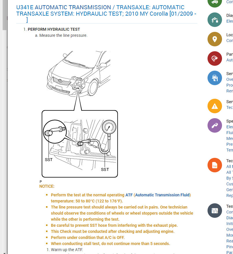

Good morning, the vehicle's transmission was slow to respond when it is placed on reverse before, now it is no longer responding at all even though the engine speed is at 5,000 RPMs. I scanned the vehicle but no codes was found on it memory. When it is placed on Drive, it work perfectly. I decided to replace the fluid and the filter but the problem persist. What could be the problem? Is there any test to be carried out?
Aug 21, 2021 at 5:31 PM

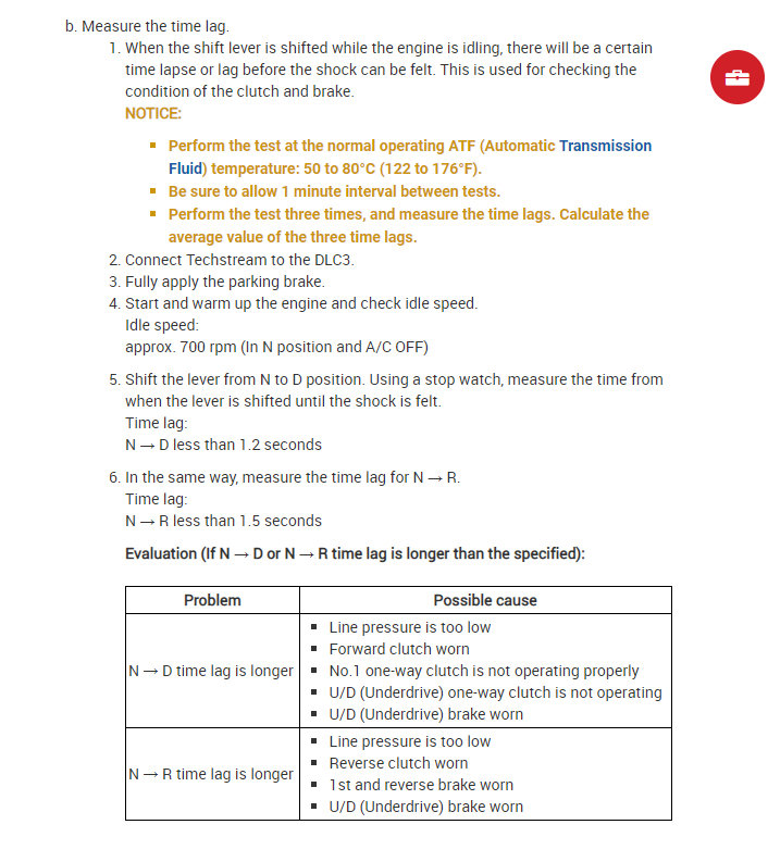

More than likely the reverse clutch is worn or the line pressure to the reverse circuit is not correct. The fact that this started as a lag and now no engagement means the clutch was slowly failing but has finally given out.
If servicing the unit did not help then unfortunately the next step is to remove the pan and look for metal.
If you did this and there was metal or debris in the pan then unfortunately we are going to need to disassemble the unit and inspect the reverse clutch and related drums. I would also suggest doing a line pressure check as shown below but I suspect that is fine if the forward gears are okay.
Please run through this and let me know what you find with this. Thanks

Okay. That would be particles from the clutch discs. How much was there?
If it was a lot then that explains it.

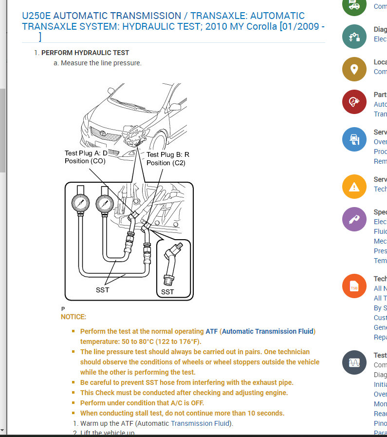

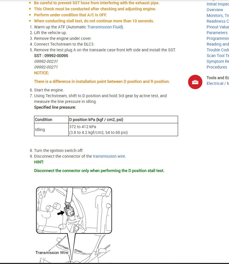

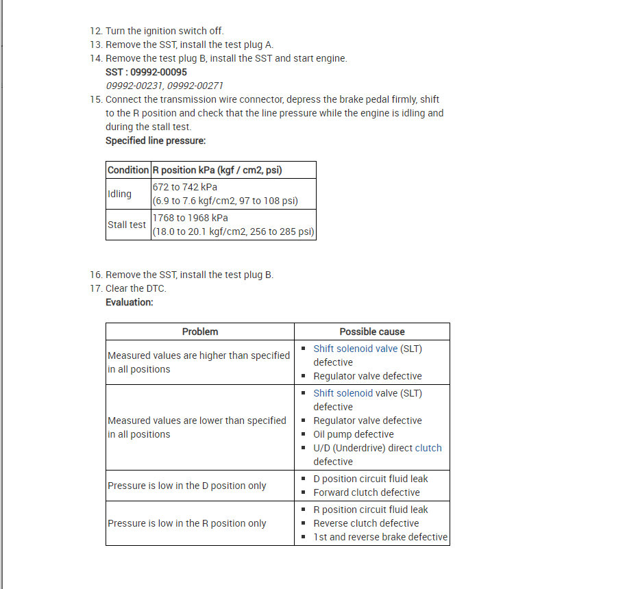

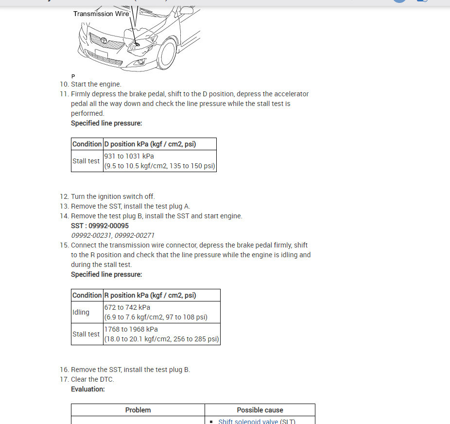

However, the only other thing that normally causes the slow engagement and then no engagement is a pump issue.
So we should check the pressure and make sure it is correct in reverse. It could be a leak in the reverse circuit inside the unit.
Take a look at this info and let us know what you find. Thanks

Yes. The idea of the pressure test is the same but the way in which it is done (tools, access point, etc) are going to be different as well as the actual specs. However, they all operate the same way in that they create pressure and direct that to a clutch pack to apply the gear.
If you have a specific vehicle that you want to do it on, just start a post on that one and we can send the process. Thanks

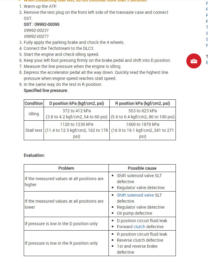

For the hydraulic test, where can someone get the gauge?
Can someone use A/C manifold gauge?
Nov 17, 2021 at 2:28 PM
Most all parts stores offer a set that would work. Unfortunately, AC sets will not work. I have never tried them, but I think the valve at the end of the line is different for the oil pressure vs the gas of the freon.
Here is a link to a common set:
