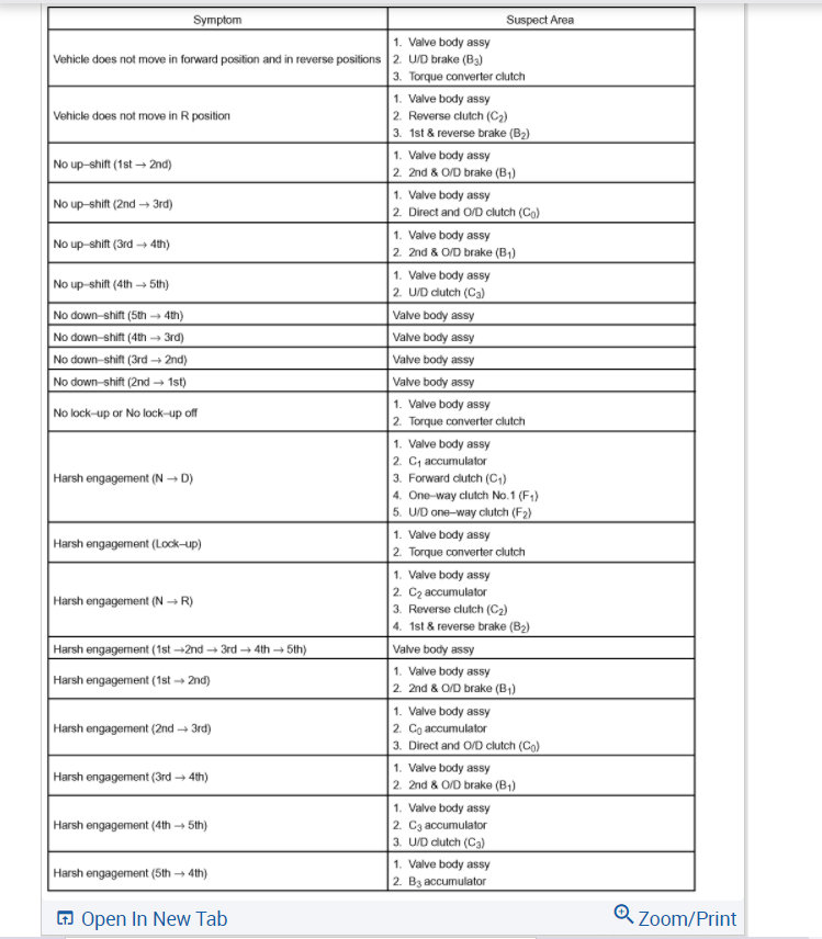

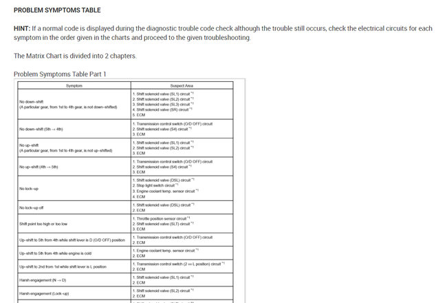

Good morning sir,

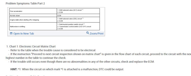

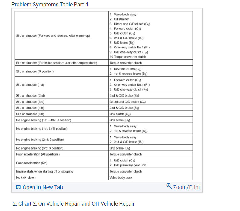

Please can I get diagnostic charts for this transmission?
Aug 4, 2021 at 4:33 PM
What specifically is the issue?
I attached a flow chart for you to follow with the issue but if I knew the specific issue, I could narrow it down further.
Aug 4, 2021 at 7:36 PM

BLESSING EWOBOR
  • 753 POSTS

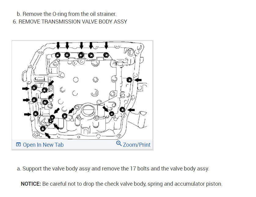

The vehicle experience harsh or hard shift (strong vibration) when the gear is moved from drive to reverse and no codes is found on its memory.
Aug 5, 2021 at 12:03 AM
That is mechanical since there are no codes.

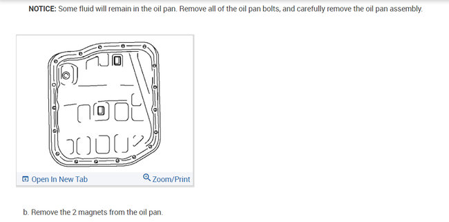

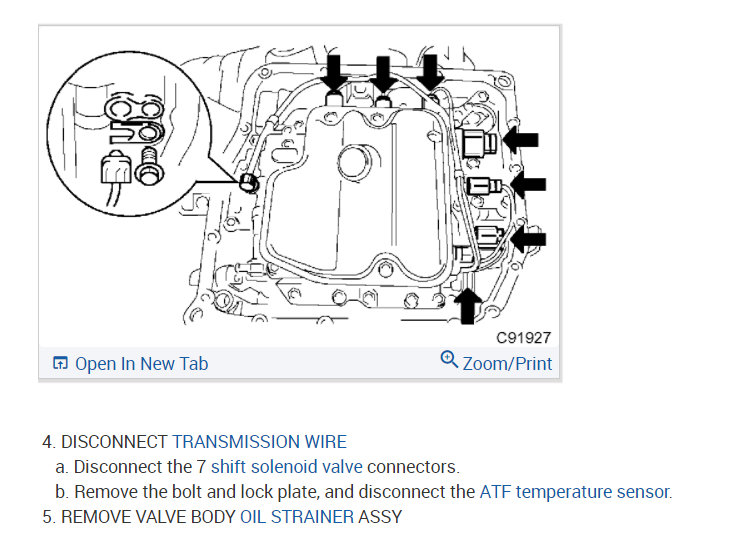

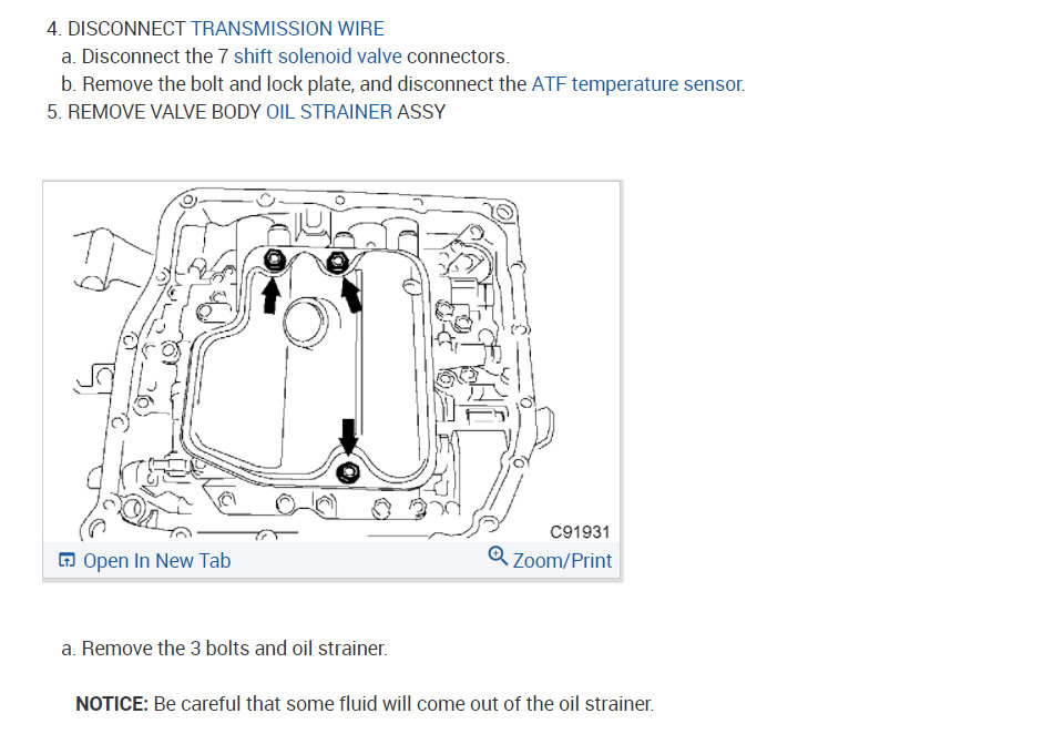

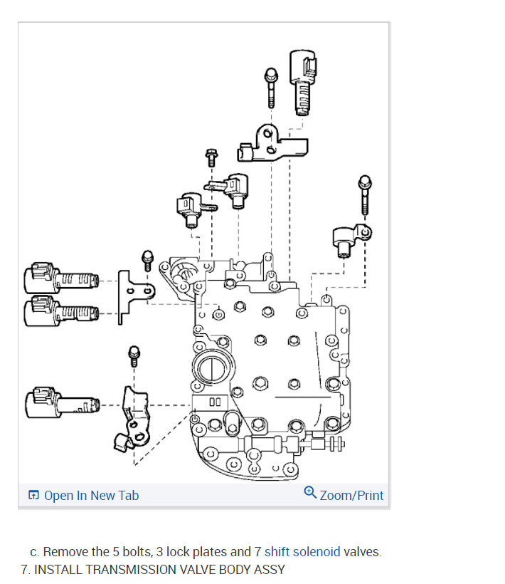

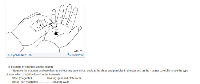

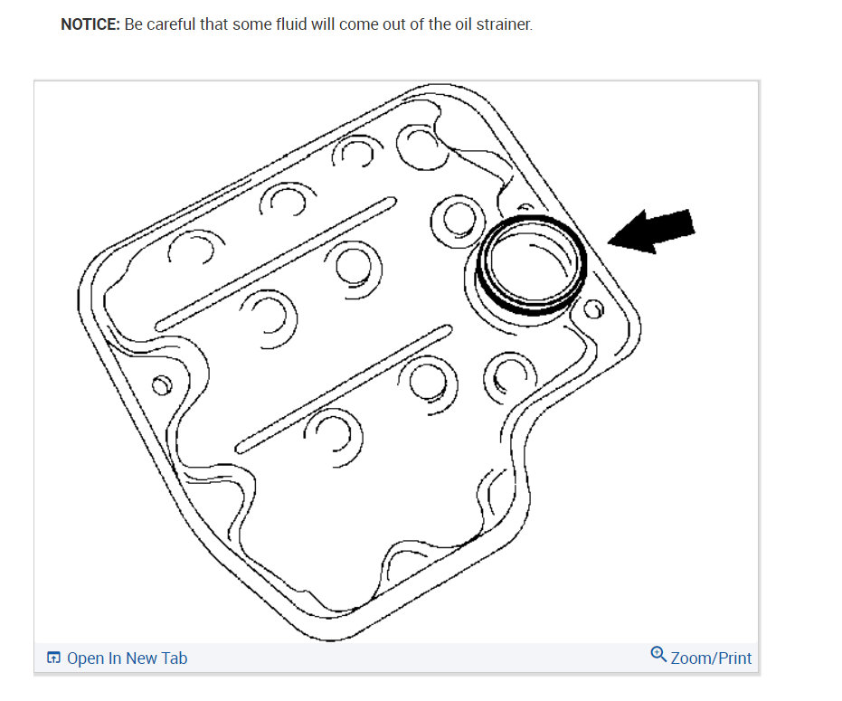

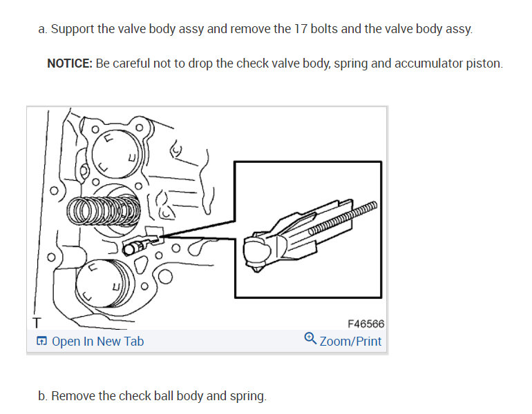

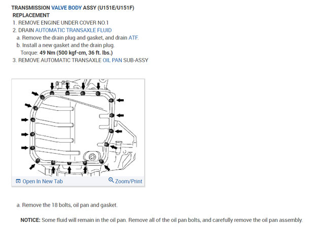

I would service it first. If that does not help, the valve body may be the issue and should be removed and cleaned.
I attached the procedure for removing the valve body and cleaning it.
Aug 5, 2021 at 4:55 AM

Sir, I have replaced the fluid and the filter but I have not clean valve body.
sir, during the cleaning of the valve body, what are the things to check out for (for someone to know that it is really dirty).
I sincerely apologise for disturbing you sir.
Aug 5, 2021 at 4:46 PM
Dirt and debris in the passages of the valve body preventing the movement of the valves.
Look for any burrs or damage to the bore of the are the valve moves.
Aug 5, 2021 at 8:42 PM
