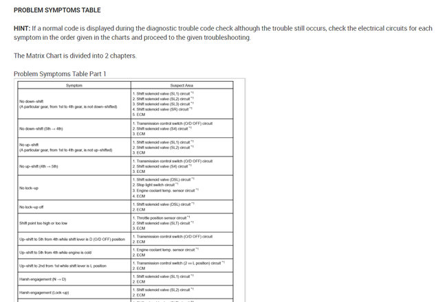

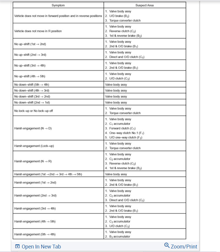

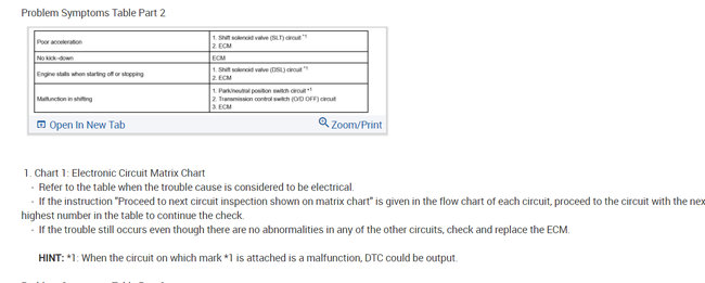

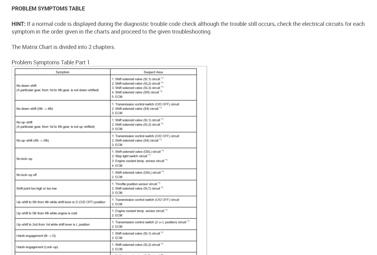

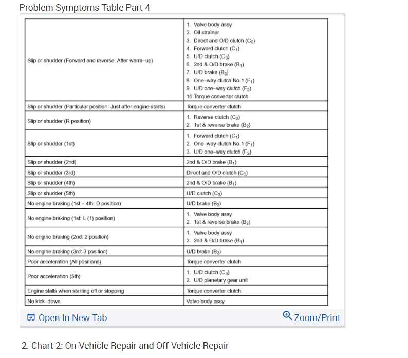

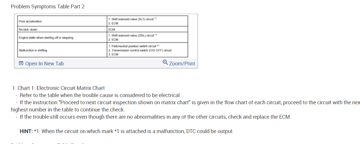

Please can I get diagnostic charts for this transmission?
Wednesday, August 4th, 2021 AT 11:33 PM
  • 52,797 POSTS
What specifically is the issue?
I attached a flow chart for you to follow with the issue but if I knew the specific issue, I could narrow it down further.
Thursday, August 5th, 2021 AT 2:36 AM

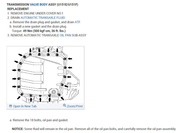

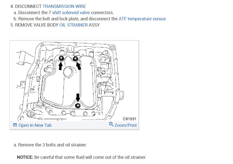

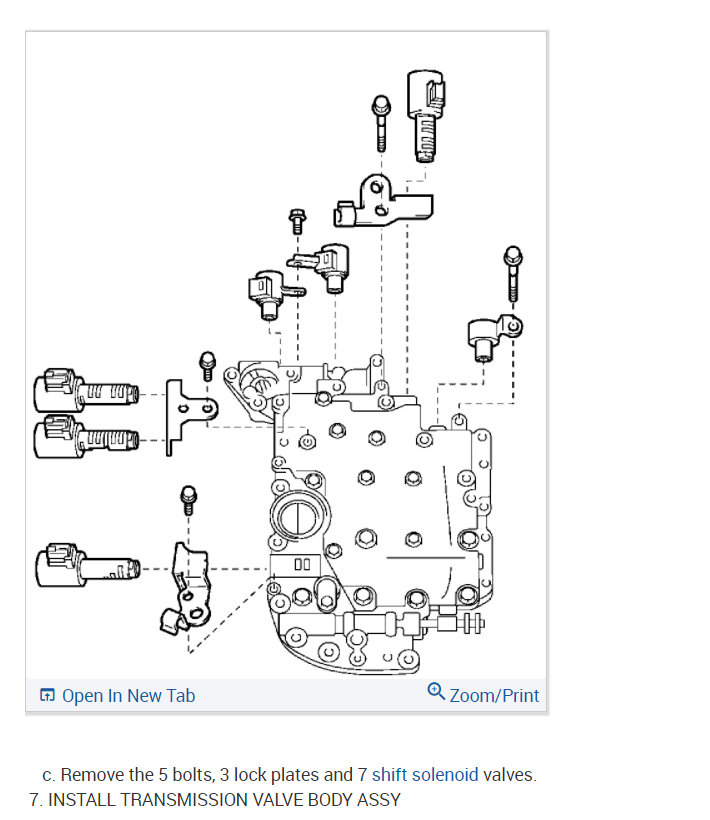

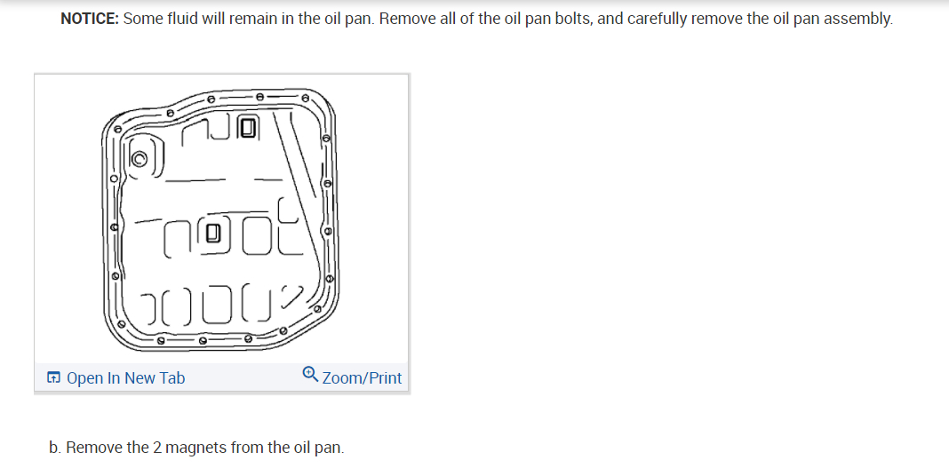

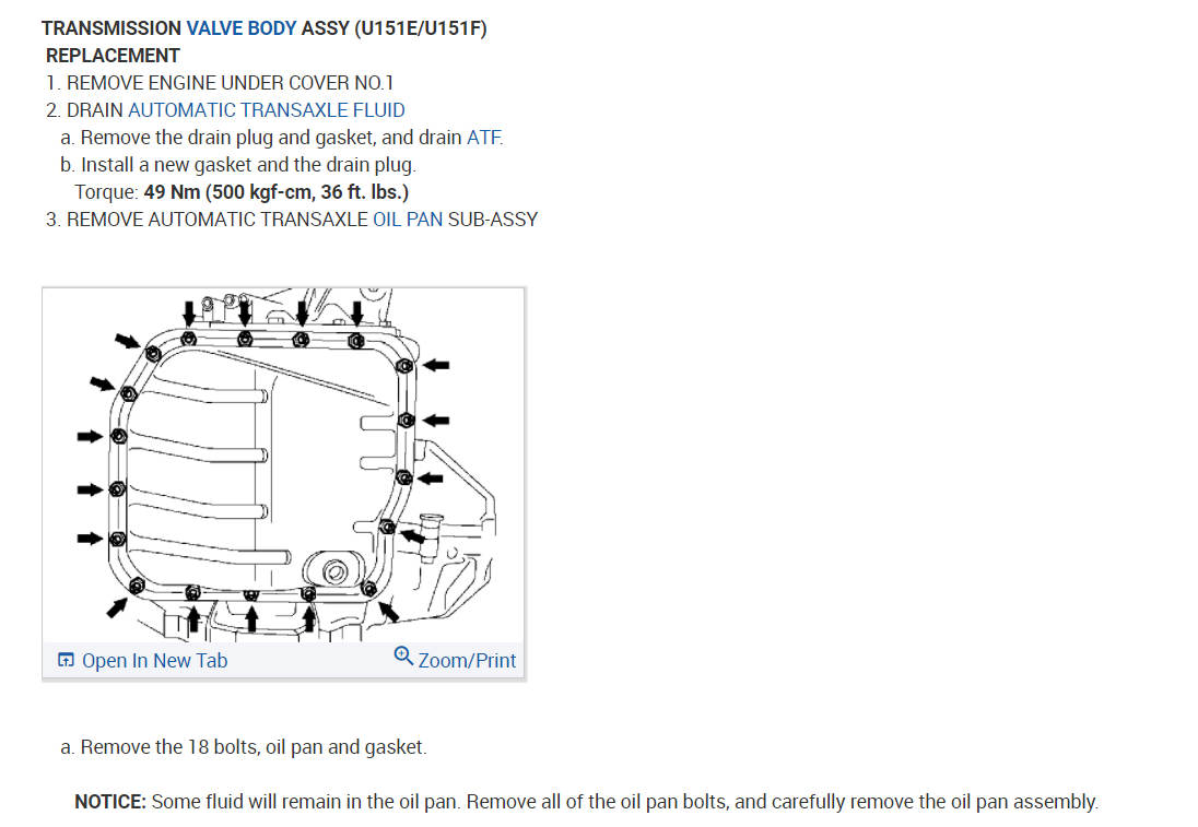

The vehicle experience harsh or hard shift (strong vibration) when the gear is moved from drive to reverse and no codes is found on its memory.
Thursday, August 5th, 2021 AT 7:03 AM

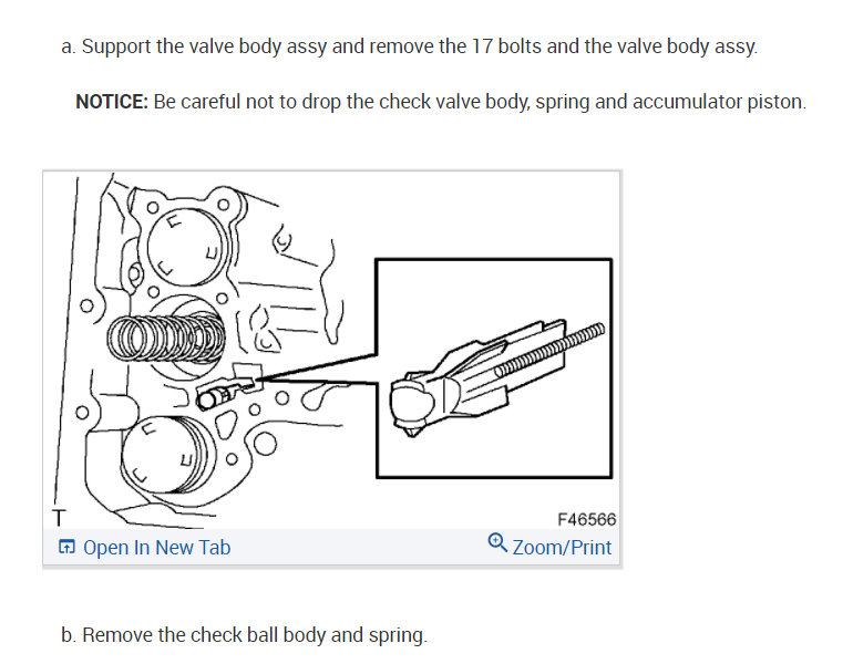

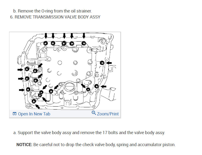

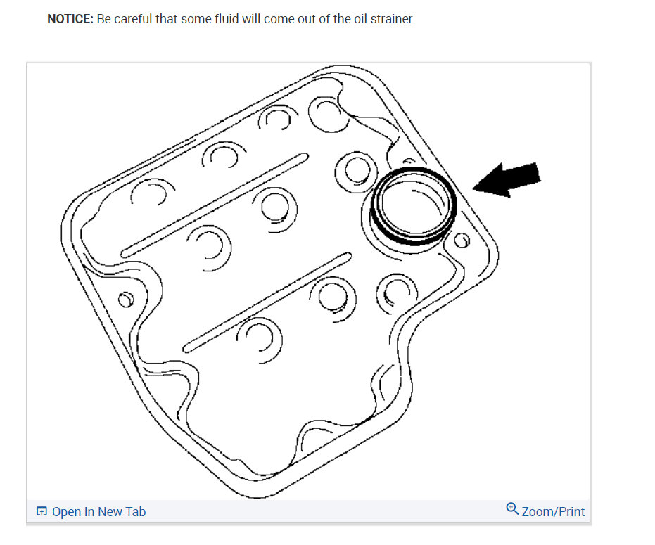

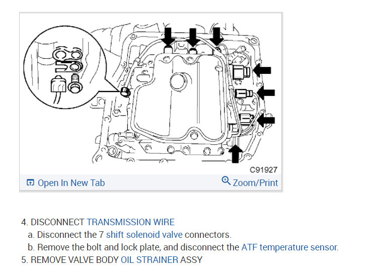

  • 52,797 POSTS
That is mechanical since there are no codes.
I would service it first. If that does not help, the valve body may be the issue and should be removed and cleaned.
I attached the procedure for removing the valve body and cleaning it.
Thursday, August 5th, 2021 AT 11:55 AM

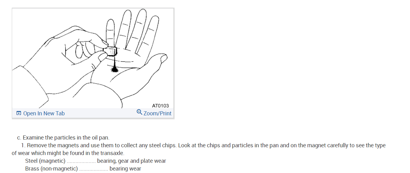

Sir, I have replaced the fluid and the filter but I have not clean valve body.
Sir, during the cleaning of the valve body, what are the things to check out for (for someone to know that it is really dirty).
I sincerely apologise for disturbing you sir.
Thursday, August 5th, 2021 AT 11:46 PM
  • 52,797 POSTS
Dirt and debris in the passages of the valve body preventing the movement of the valves.
Look for any burrs or damage to the bore of the are the valve moves.
Friday, August 6th, 2021 AT 3:42 AM
