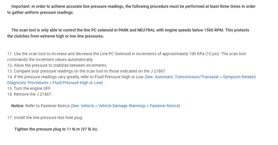

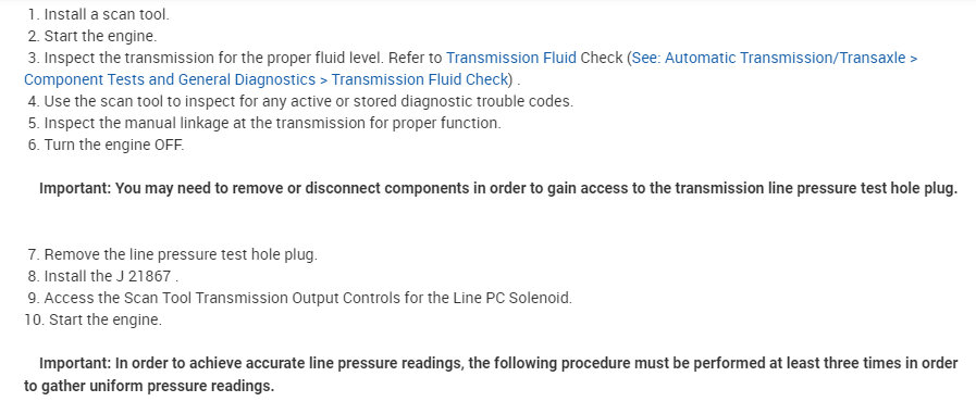

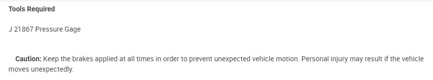

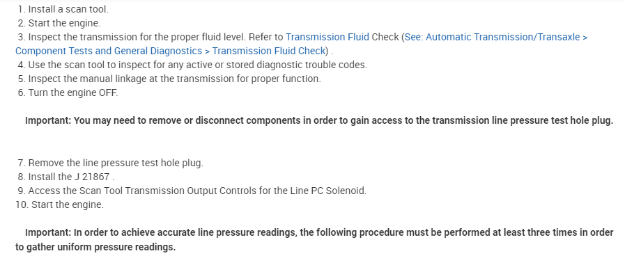

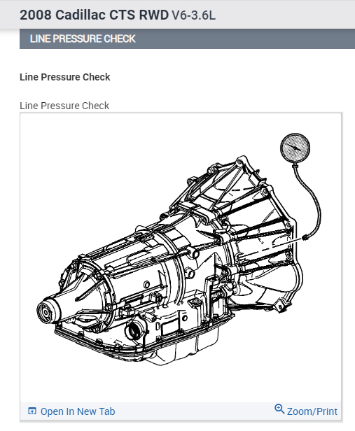

If you changed all fluid, the next thing we need to check is line pressure. Damage to the torque converter or front pump may have occurred. I'm basing that on the idea that it doesn't slip when you shift manually.
I attached the directions below for checking line pressure. You will need a pressure gauge and scan tool that can communicate with the vehicle. Take a look through the directions and let me know if you feel comfortable performing this.
