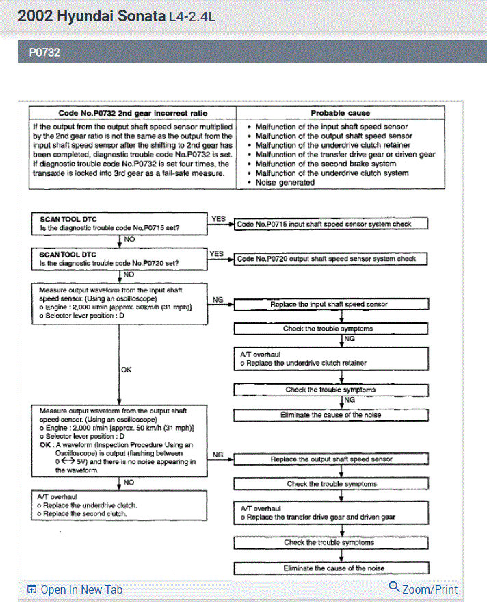

The code could indicate a few different things. For example, it could be a faulty input or output speed sensor or even need to be overhauled.
I attached the diagnostics below. Make sure this is the only code present. If other codes are set, they may need attention prior to focusing on the P0732.
Let me know if this helps.
See pic below.

There was no codes initially, the code came up when engaging the gear manually.

Good morning sir, how will someone know if the waveform is correct?
Sep 30, 2021 at 11:50 AM
  • 110,251 POSTS

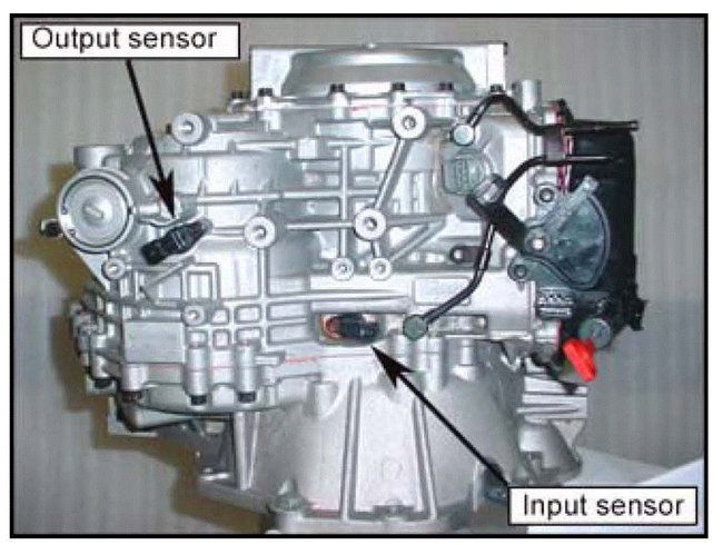

My manual doesn't show the waveform. Do me a favor. Check the connection at both the input and output speed sensor. Using you live data scanner, see if there is a signal from both.
See pic 1 for sensor location.
See pic below.
