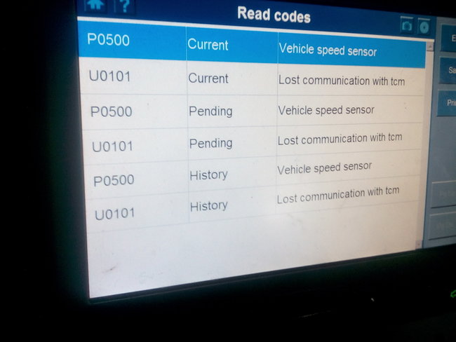

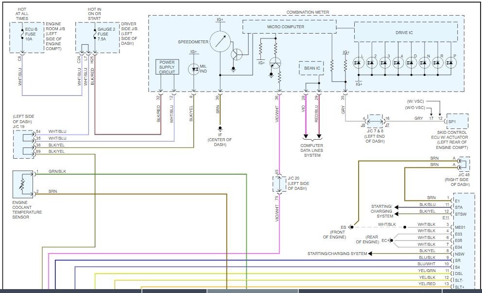

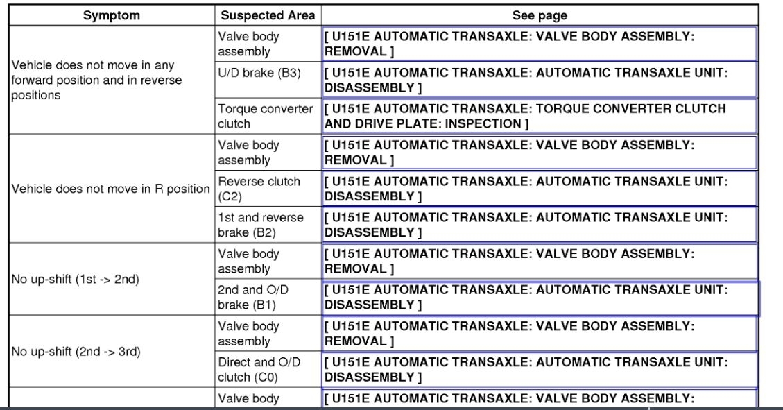

Good morning, the vehicle transmission had just been replaced recently, now the transmission is moving on R (reverse) alone, when place in D (drive) it won't move. I scanned the vehicle the following codes were retrieved.
Dec 30, 2020 at 5:54 PM
Good morning, nice to hear from you.
Is this a new or used transmission?
Did you have the TCM programmed after installing?

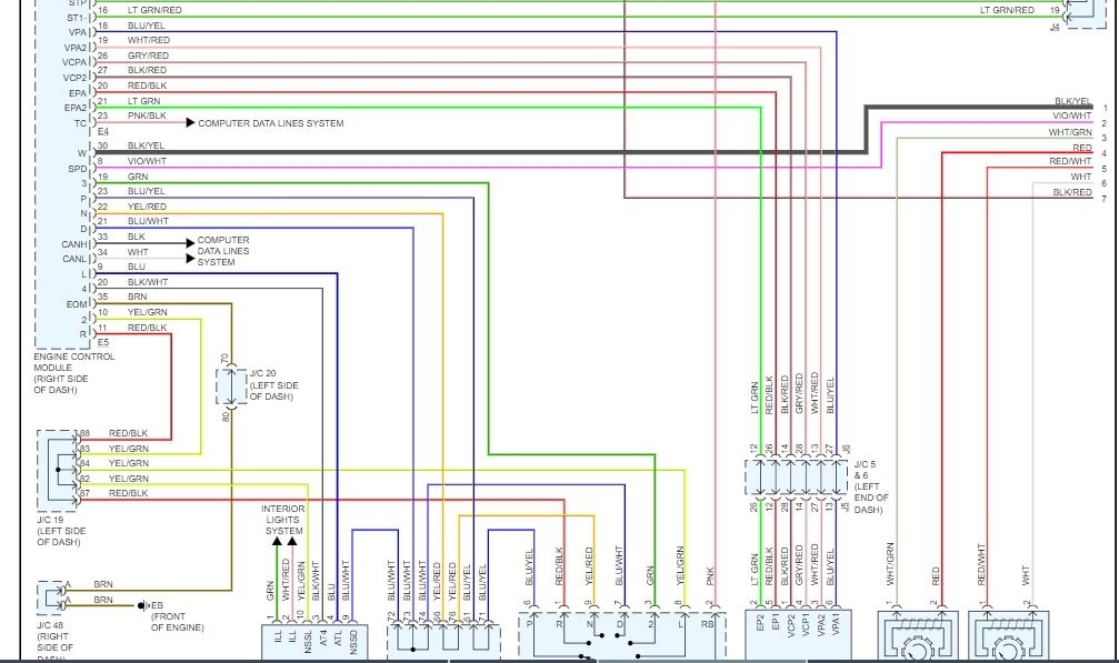

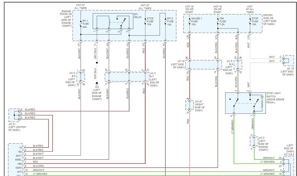

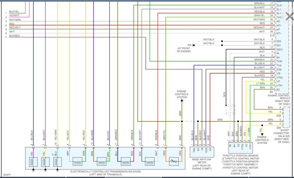

I attached a wiring diagram for you to view. Check the fuses in the diagram for power on both sides.

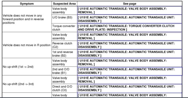

This sounds like a bad transmission.

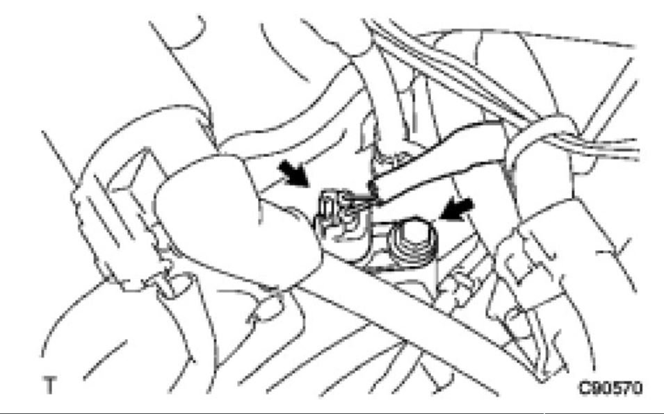

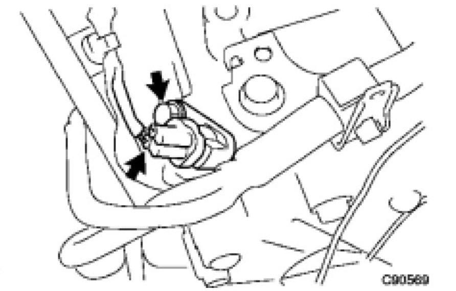

The 500 is for the vehicle speed sensor.
The U code is a no communication issue with the TCM.
1. REMOVE BATTERY
2. REMOVE AIR CLEANER ASSEMBLY
3. REMOVE SPEED SENSOR (NT SENSOR)
(a)Disconnect the speed sensor connector.
(b)Remove the bolt and speed sensor.
4. REMOVE SPEED SENSOR (NC SENSOR)

Okay, it still needs to be programmed to your car.
Dec 31, 2020 at 12:18 PM
BLESSING EWOBOR
  • 753 POSTS
How can it be programmed?
Dec 31, 2020 at 12:30 PM
That needs to be done either by the dealer or someone with the software to perform this.
You can use the original RCM and have that programmed.
Dec 31, 2020 at 6:52 PM
BLESSING EWOBOR
  • 753 POSTS
Could techstream perform it or what is the name of the software used?
Dec 31, 2020 at 8:44 PM
Toyota has there own scan tool.
Snap-on will perform this but you will need a subscription to Toyota technical site.
