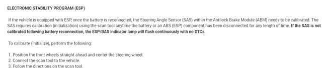

I had my battery unhooked for a day not sure if this has anything to do with it. When I drive once it hits third gear it just doesn’t do anything at all until it drops back Down to second and keeps repeating. Codes p0700, p0730.
Nov 7, 2021 at 1:58 AM
STARLORD1976
  • 173 POSTS
Update: When I take the 50-amp ABS fuse out, it drives normal?
Nov 7, 2021 at 6:15 AM
  • 110,244 POSTS
It sounds like the removal of the battery for an extended time is the cause. The steering angle sensor, which is an integral component in the ABS module, requires reprogramming.
You need a scan tool that is able to communicate with the ABS module. Take a look at the directions below. Also, it provides a better definition of what I mentioned.
See pic below.
Nov 7, 2021 at 11:36 AM

Is there a way to calibrate it without machine?
Nov 7, 2021 at 11:39 PM
  • 110,244 POSTS
I wish there were. It requires a scan tool that can communicate with the module and reset the steering angle sensor. They don't make anything easy anymore. LOL
I wish I had an easier answer, but this is what is required.

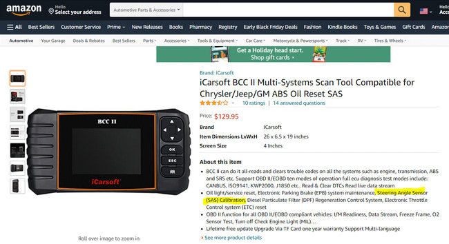

I bought a scanner that calibrates SAS, but it will not work with my car. can you find me one that will?
Nov 10, 2021 at 6:58 AM
  • 110,244 POSTS
I found one that indicates it will recalibrate SAS on Amazon. However, I don't know how much you want to spend.
Take a look below and let me know if that helps.
See pic
