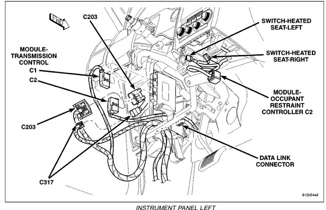

Sure, the code that sticks out to me is the:
U0101 Lost communication with TCM
Which can cause the other codes, and the fact that you can turn the car off on then back on again and it works is a classic module rest issue. Here is the location for the TCM so you can look at the electrical connector for corrosion and if okay replace the TCM.
