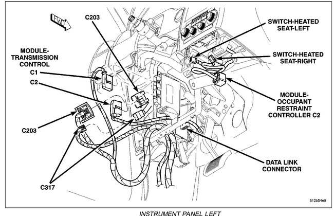

I have a 300c 5.7 hemi and having trouble getting it into go into gear. When I am able to it will stall out pretty quickly and I have to restart it a few times before I can get it going into gear again. I have a lot of codes popping up and they are:
P0731 gear 1 incorrect ratio
P0732 gear 2 incorrect ratio
P0733 gear 3 incorrect ratio
U0101 Lost communication with TCM
P0406 exhaust gas recirculation sensor A circuit high
P0522 engine oil pressure sensor/switch low
This car was owned by someone who had his friends work on it and last repairs were often half done. There is a cigarette lighter plug connected with a red and black wire to each battery terminal in the trunk and I have no idea why. I'm trying to learn about cars and how these things work when diagnosing the problems. So please let me know what you think.

Sure, the code that sticks out to me is the:

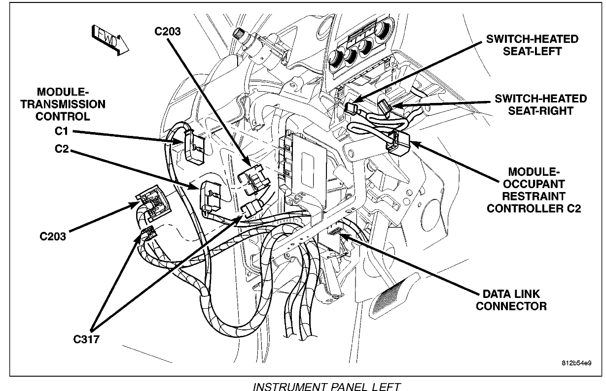

Which can cause the other codes, and the fact that you can turn the car off on then back on again and it works is a classic module rest issue. Here is the location for the TCM so you can look at the electrical connector for corrosion and if okay replace the TCM.

Check out the images (below). Please let us know how it goes.
