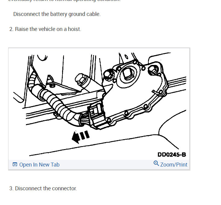

Parked the vehicle and when i went back to go it would not go into drive. Drives perfectly in reverse. Prior to this it has never shown any signs of a problem. what could this possibly be?
Dec 30, 2022 at 7:01 AM
  • 55,423 POSTS

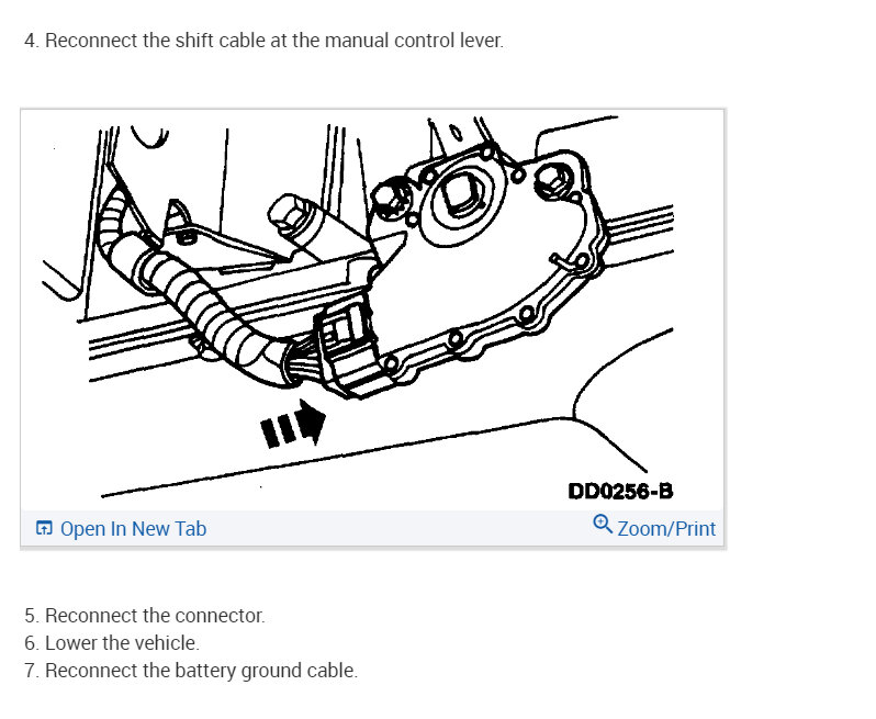

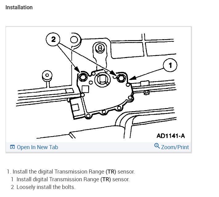

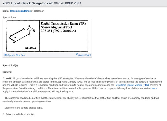

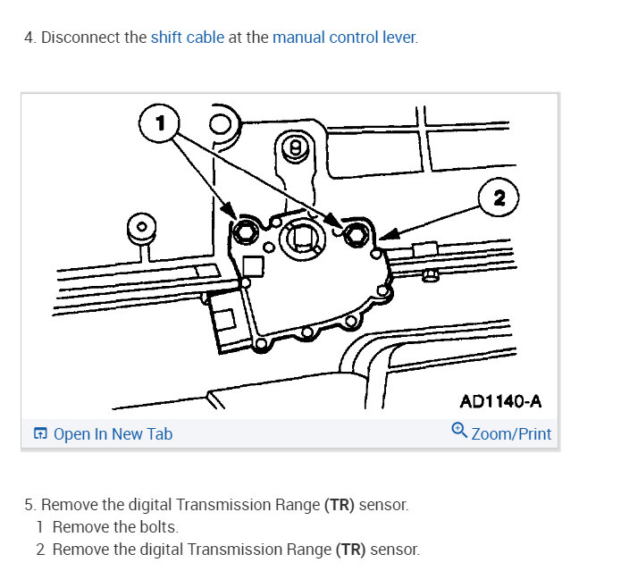

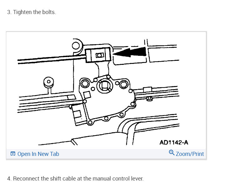

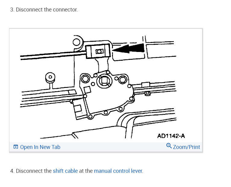

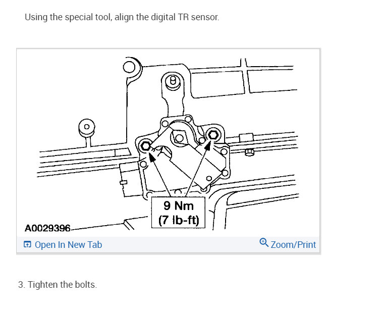

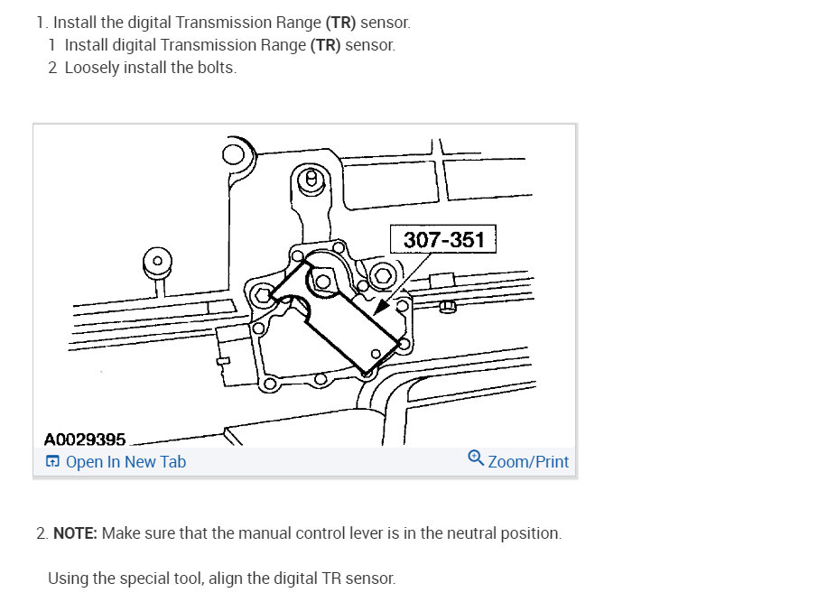

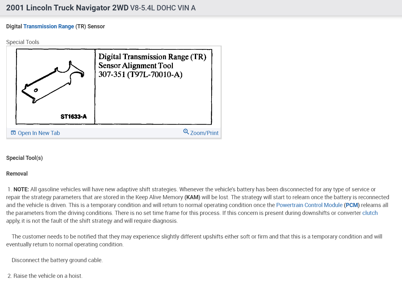

This can be the gear range sensor not working but we need to run the codes to see what comes up.
This guide can help:
Here is the gear range sensor so you can check it out or replace it. Also make sure the fluid is clean and full.
https://www.2carpros.com/articles/how-to-check-and-add-transmission-fluid
You might have a first gear shift solenoid that is not working as well, check out the images (below). Please let us know what happens.
