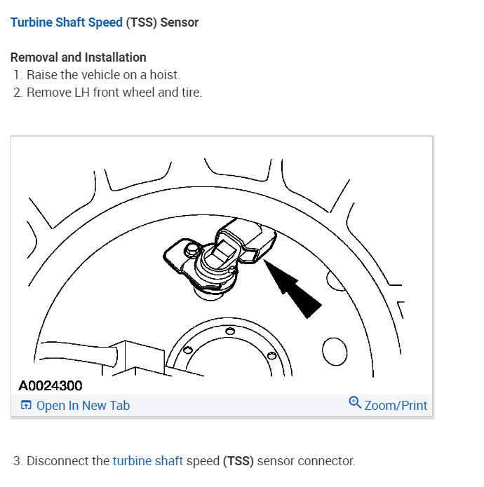

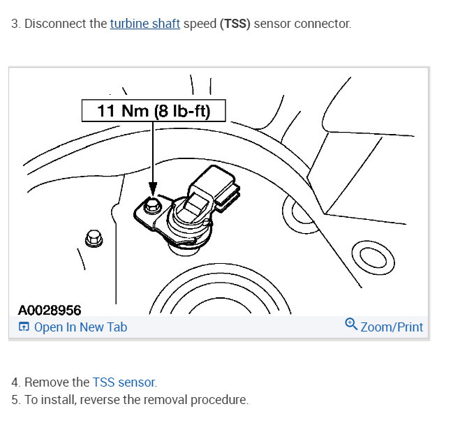

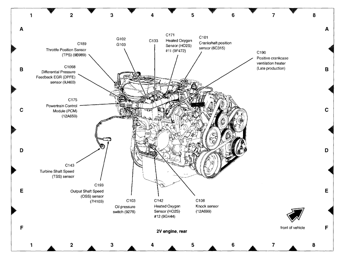

Hi my 2005 ford ba xr6 XT Won’t go into 2nd, 3rd. There was a really small amount of metal in the transmission oil pan but enough to be worried about from my view.
Jun 27, 2022 at 1:04 AM
  • 55,433 POSTS
It sounds like you have an input shaft speed sensor that is not working. We should run the codes first though this guide can help, and I have left instructions on how to change out the shift solenoids in the diagrams below.
