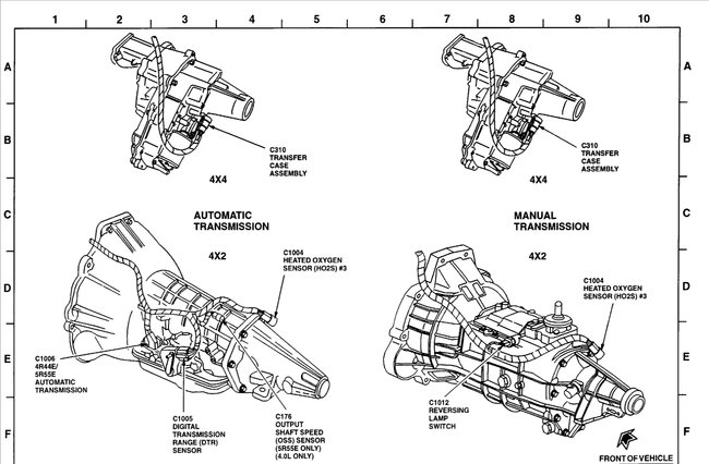

Truck was driving great until I came to a stop sign. Went to take off and the truck just started stumbling and not getting any power. Later I figured out that it is not coming out of drive. So I tried shifting it manually and that worked. It has codes popping up on the diagnostic scanner saying all the solenoids are not functioning. What would cause this? Bad speed sensor?

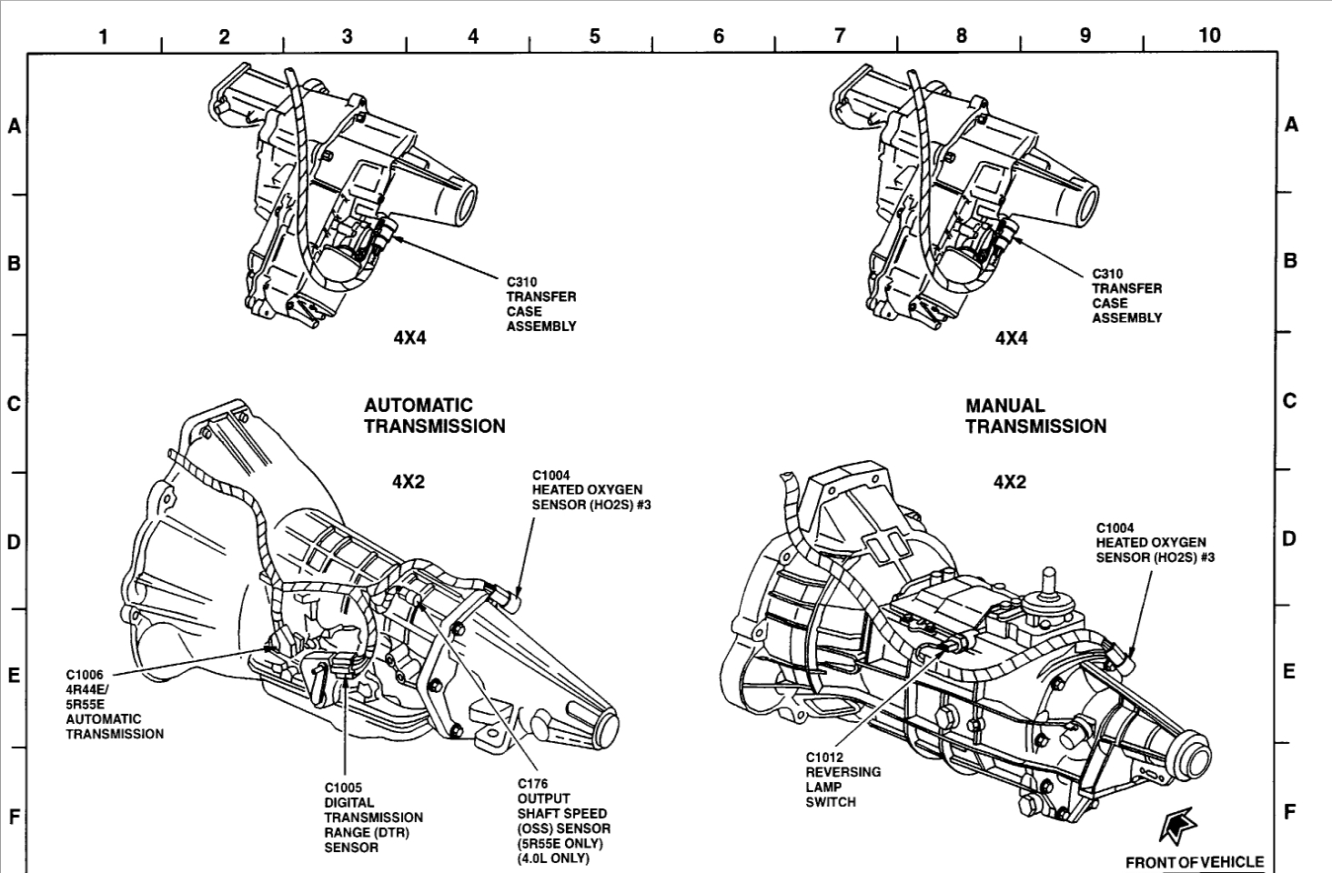

Yes, that is what I was going to say. I would replace the output sensor. Below are the locations.
I would run the codes as well.
Please run this test and get back to us.
