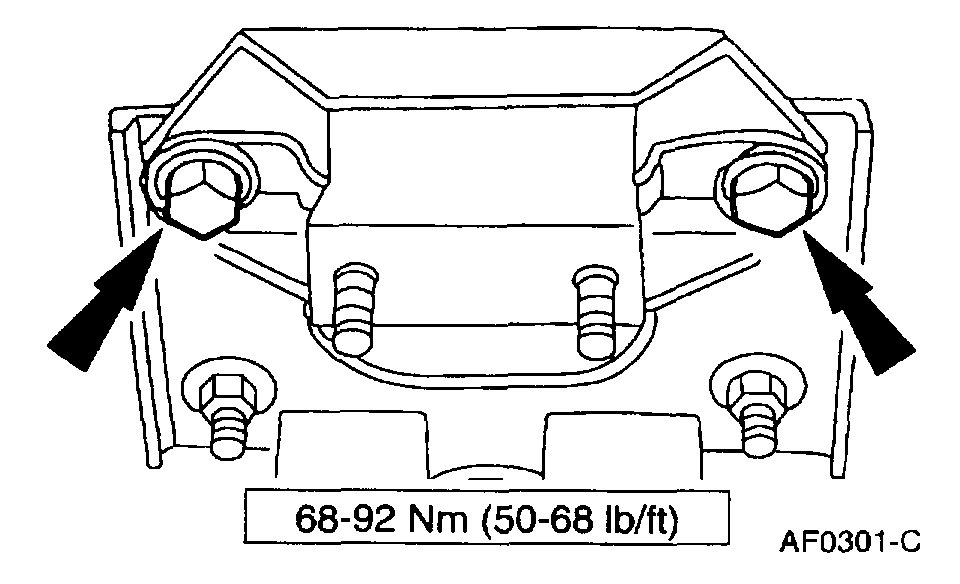

Whenever I change from park to reverse, the transmission feels like to gets picked up and drops into place. I feel like the whole back is being lifted. I have no idea why it does this.
Nov 3, 2019 at 1:34 PM
BMDOUBLE
  • 1,139 POSTS
It sounds like you have a bad transmission mount. The exhaust and the cross member will need to be removed to replace the mount. Here is a picture of the mount looking from under the vehicle.

So changing that will fix the issue of the car feeling like it’s being lifted and sat to place while changing gears? You can notice the rear moving.
Mar 13, 2021 at 4:24 AM
BMDOUBLE
  • 1,139 POSTS
Yes, that is the job of the transmission mount, to keep the transmission in place during these situations. The engine mounts should be inspected as well.
