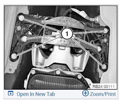

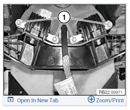

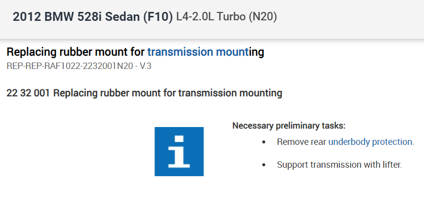

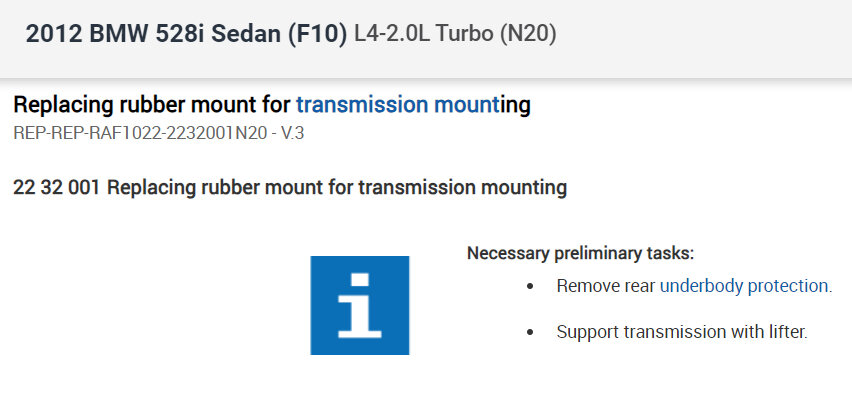

Hi, can you please tell me how to replace the transmission motor mounts on the vehicle listed above?
Jun 20, 2024 at 3:18 AM
Experienced Mechanic
55,594 POSTS
Yep, here are the instructions on how to replace the transmission rubber mount.
Remove transmission cross-member with rubber mount.
Remove rubber mount from transmission cross-member.
Check out the images (below). Let us know if you need anything else.
