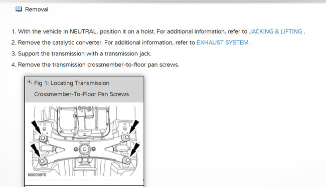

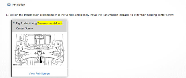

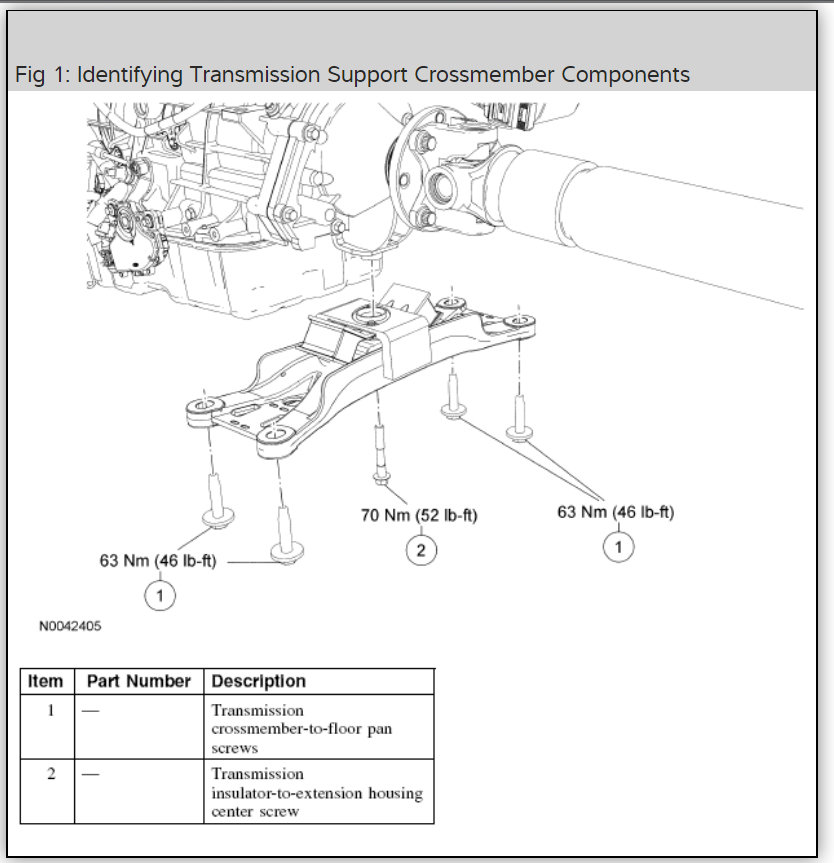

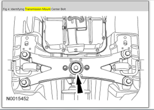

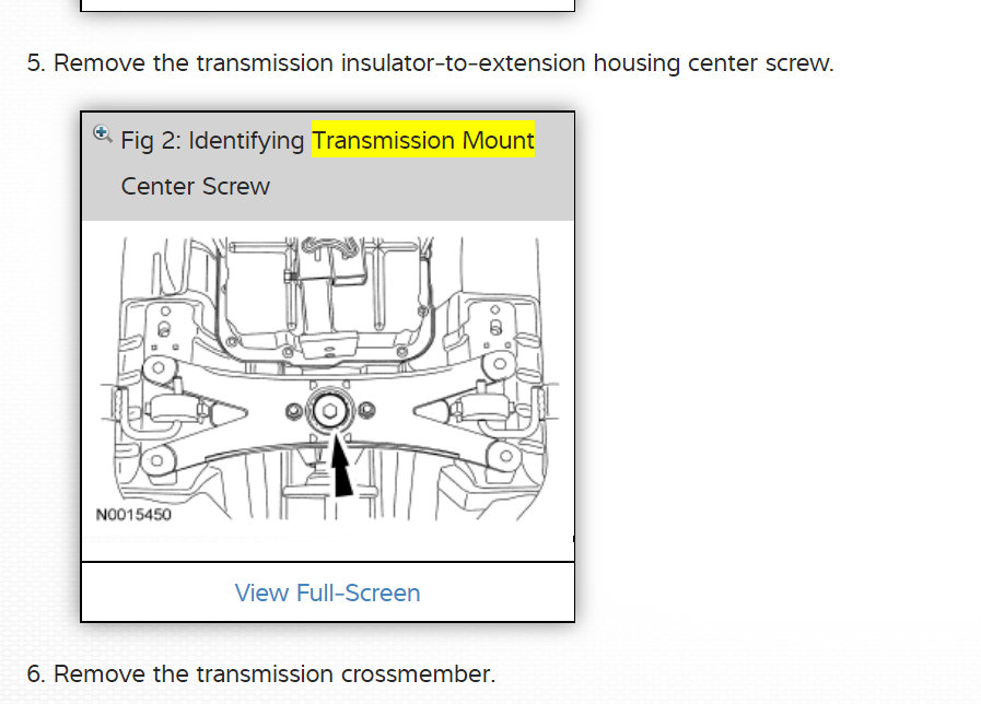

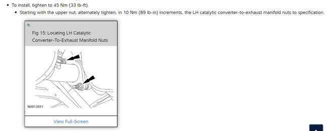

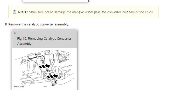

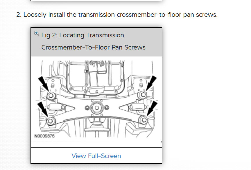

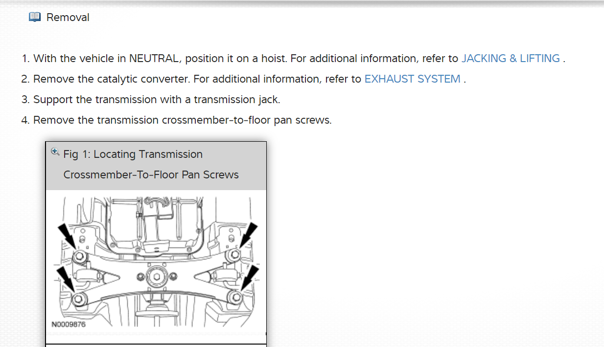

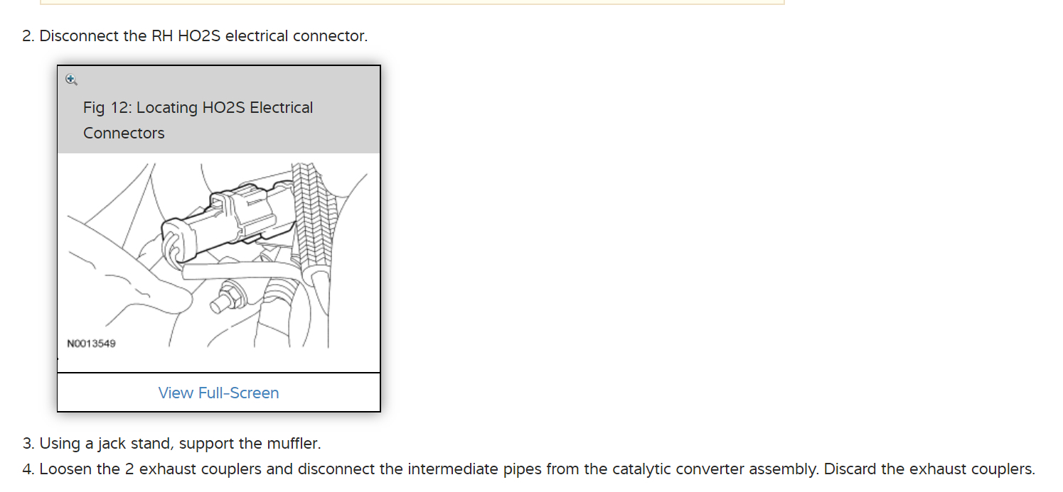

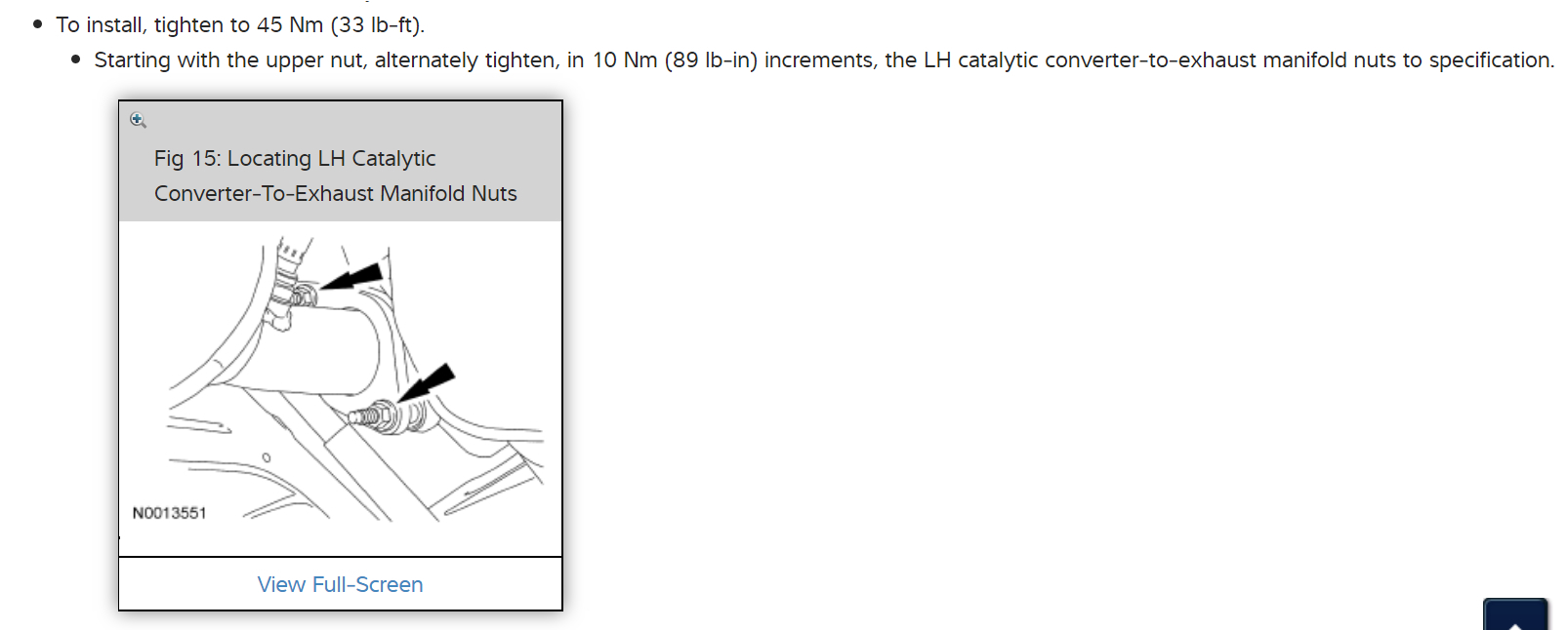

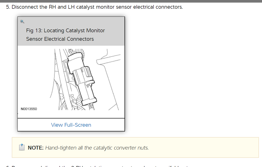

How to replace transmission mount?
Mar 14, 2019 at 8:03 PM
SCGRANTURISMO
  • 4,897 POSTS

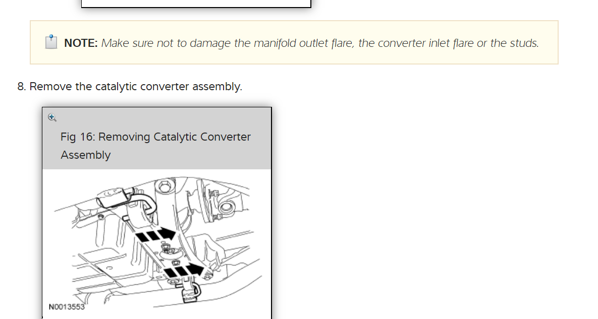

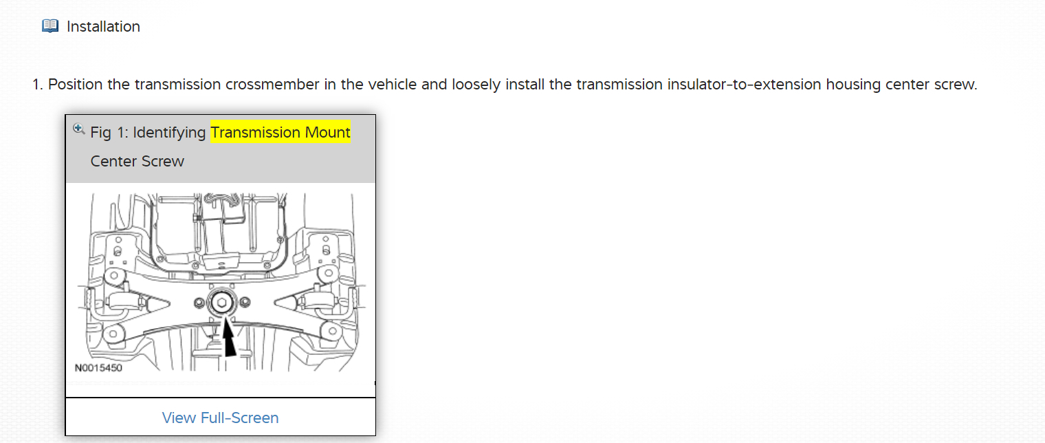

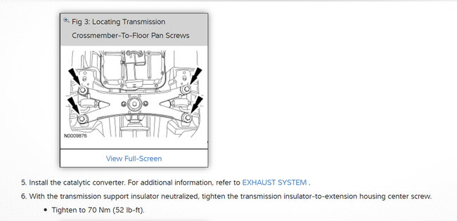

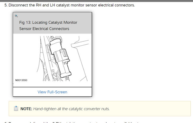

I have ,included the information that you have requested in the diagrams down below. I have also included a link down below. Please go to this link first.
Then please go through your step by step instructions in the diagrams down below and get back to us if you have any more questions or we can help in any other way.
