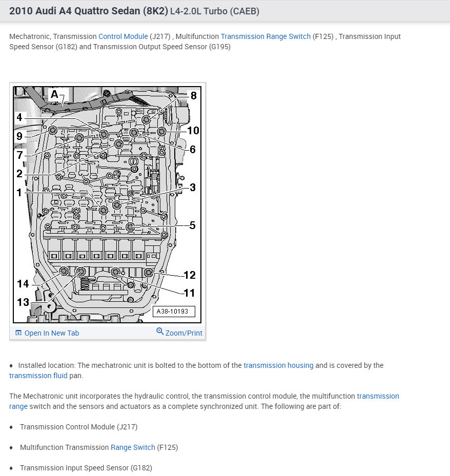

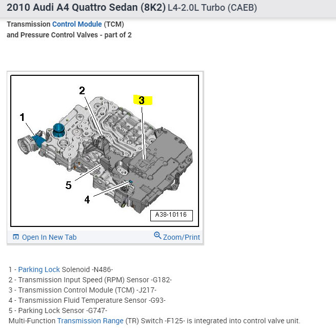

Where is the transmission module located?
2010 AUDI A4
133,000 MILES • 4 CYL • TURBO • 4WD • AUTOMATIC
DIVIDES
  • 903 POSTS

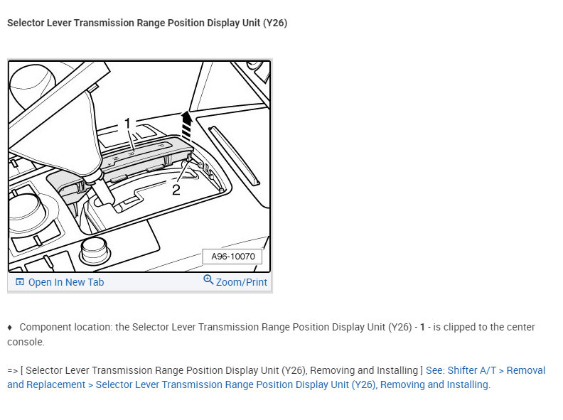

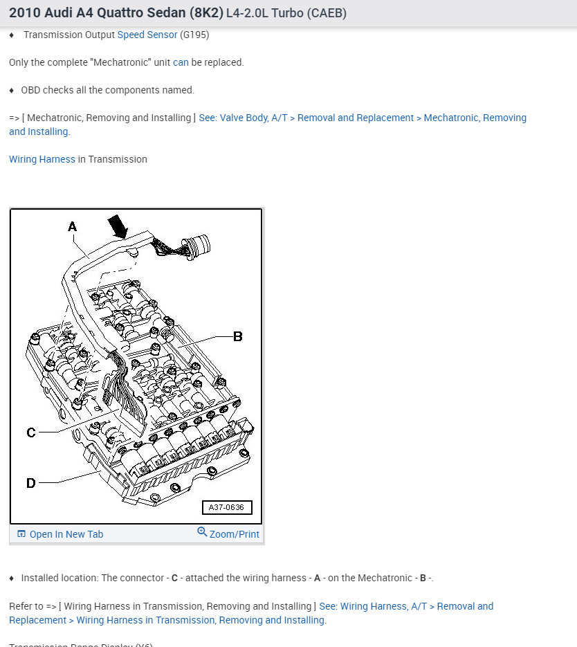

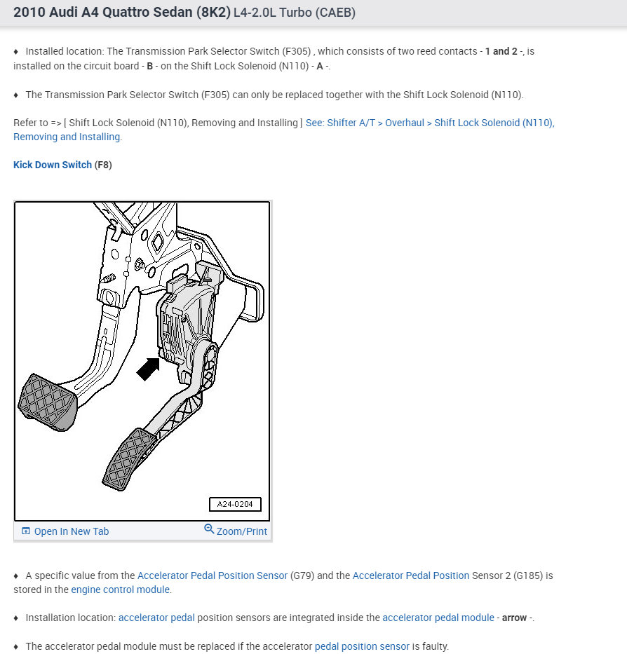

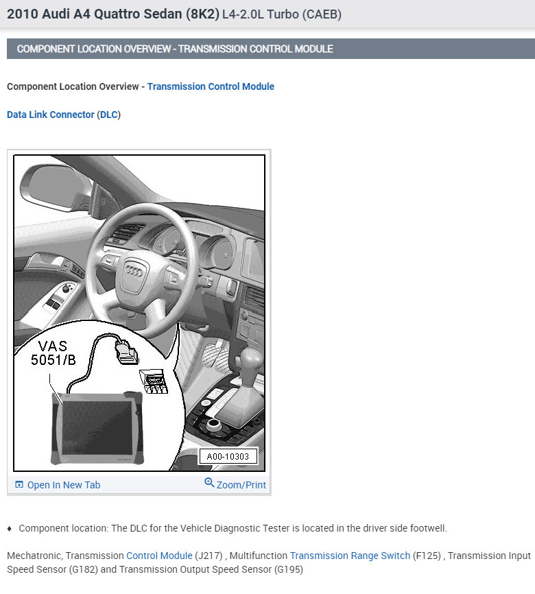

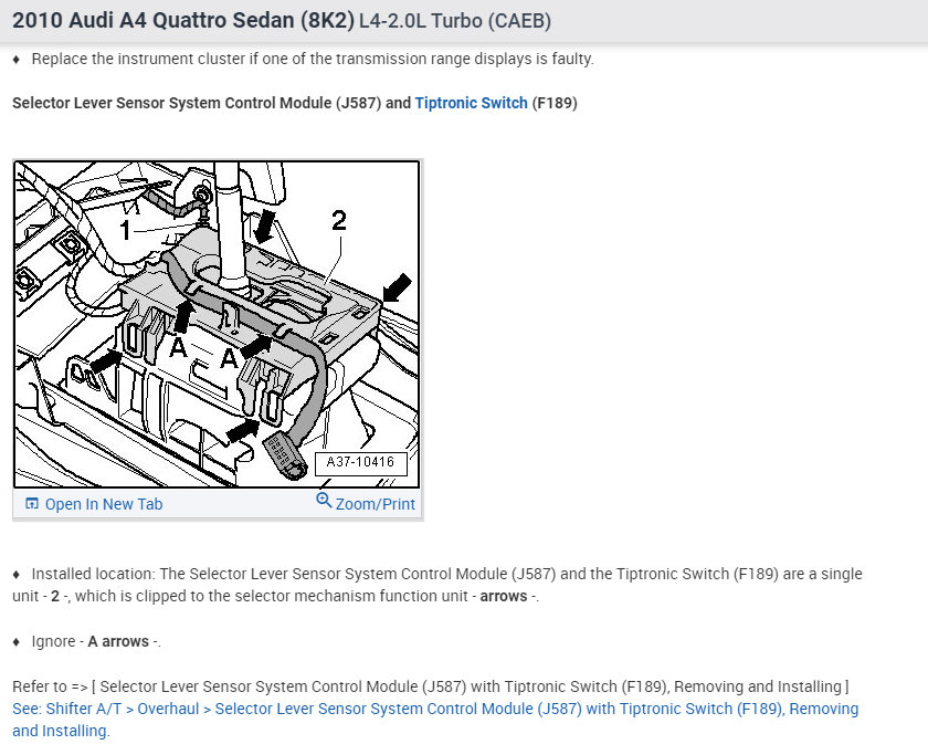

Is it behind the gearbox or on passenger side, trying to find any modules or TCM on this car? Please, and if there are any fuses as well.

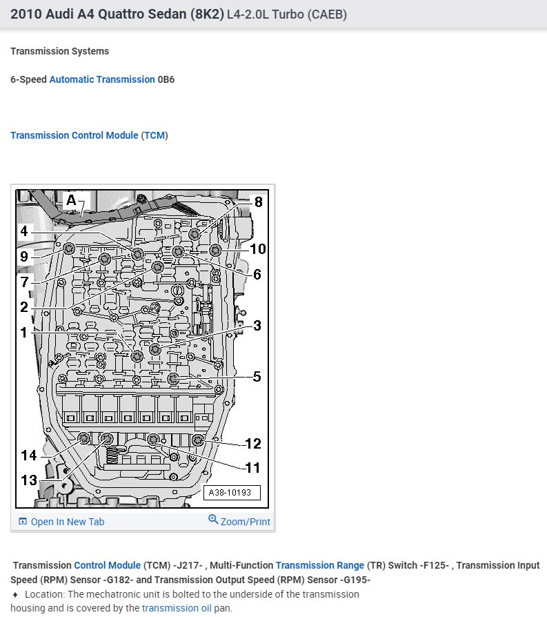

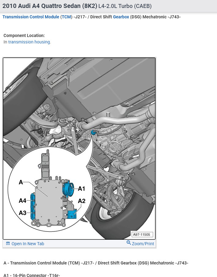

Do you know if this is a 6-speed automatic or DSG?
The TCM for these are located in the transmission housing.

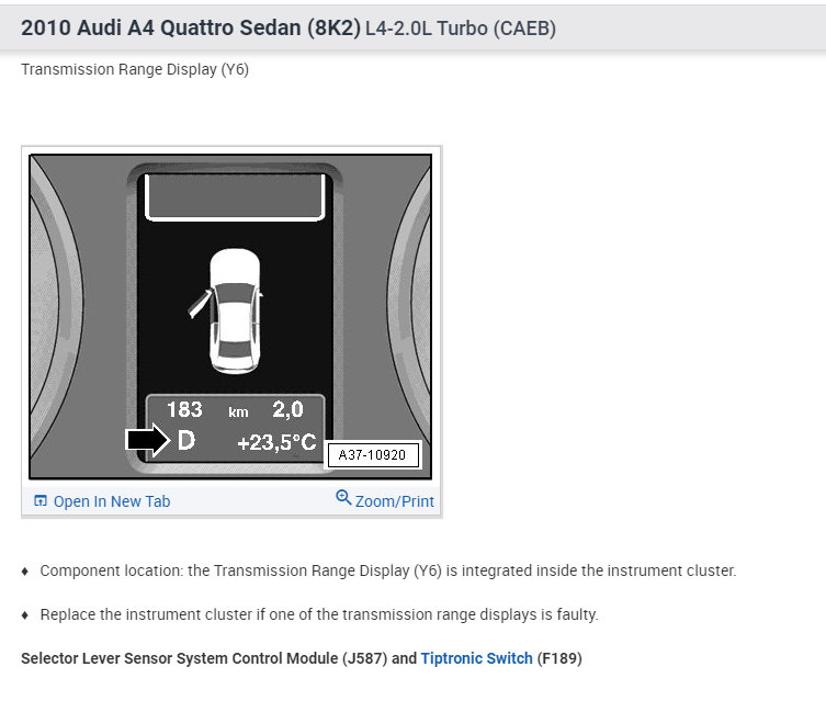

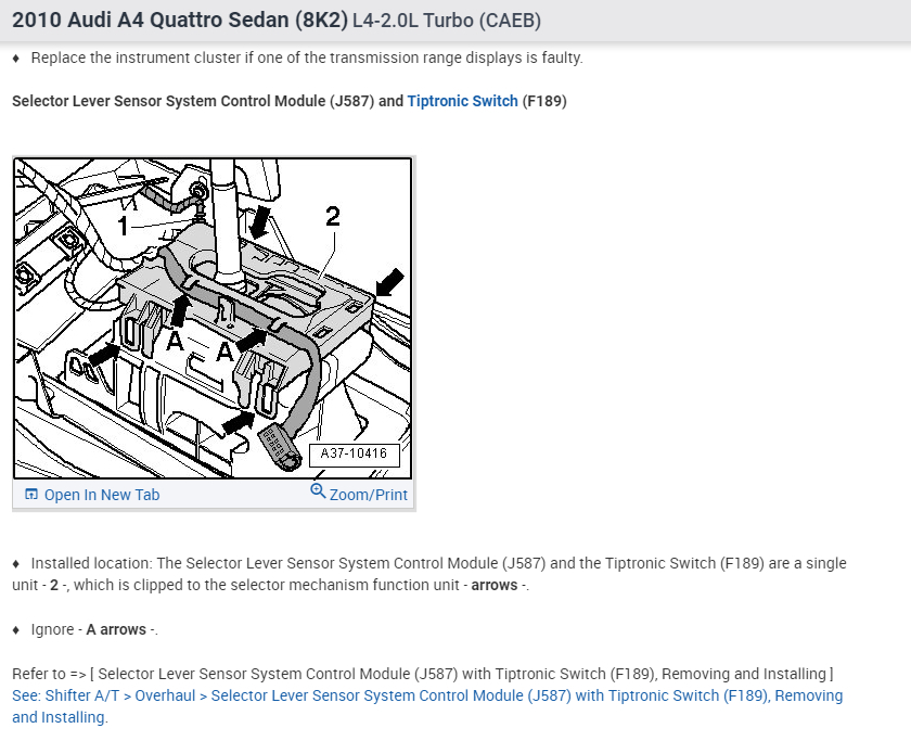

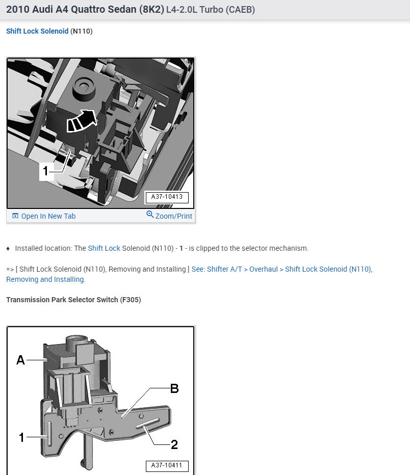

I have attached diagrams below for your reference.
Also attached the general diagnostics information as well.
Let me know of any questions.
