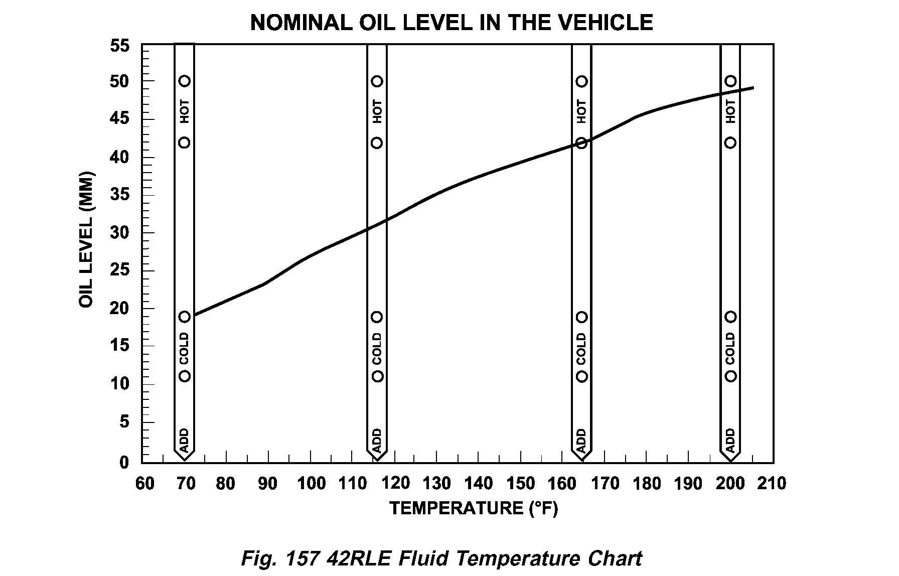

It could be a few things. Is the fluid clean and full?
Here are the directions for checking fluid level and condition. Do this and let me know the results. The attached picture correlates with the directions.

FLUID LEVEL CHECK
The transmission sump has a dipstick to check oil similar to most automatic transmissions. It is located on the left side of the engine. Be sure to wipe all dirt from dipstick handle before removing.
The torque converter fills in both the PARK and NEUTRAL positions. Place the selector lever in PARK to be sure that the fluid level check is accurate. The engine should be running at idle speed for at least one minute, with the vehicle on level ground. At normal operating temperature (approximately 82° C. or 180° F.), the fluid level is correct if it is in the HOT region (cross-hatched area) on the oil level indicator. The fluid level should be in COLD region at 70° F fluid temperature. Adjust fluid level as necessary. Use only Mopar (R) ATF + 4, Automatic Transmission Fluid.
FLUID LEVEL CHECK USING SCAN TOOL
NOTE: Engine and Transmission should be at normal operating temperature before performing this procedure.
1. Start engine and apply parking brake.
2. Connect scan tool and select transmission.
3. Select sensors.
4. Read the transmission temperature value.
5. Compare the fluid temperature value with the chart.
See Pic 1
6. Adjust transmission fluid level shown on the dipstick according to the 42RLE Fluid Temperature Chart (Fig. 157). Use only Mopar (R) ATF + 4, Automatic Transmission Fluid.
7. Check transmission for leaks.
Nominal oil level in the vehicle
Let me know the results.

Checking the fluid was the first thing I did when the issue arose. Fluid was full and clean. My father also checked the fluid with the same results.

The 42RLE transmission in the Liberty is somewhat prone to failures. They can show up as random issues that go away, then they get more persistent. The problem you had is one of the early signs of either sensor or solenoid issues. The transmission went into limp mode where it limits the speed to 30-45 mph. To see why it went into limp mode requires a good scan tool that can read the transmission control module. A common reason is corroded connections or grounds.
