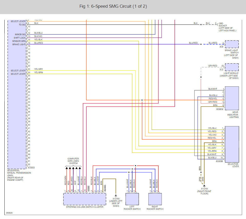

Hi Walter,

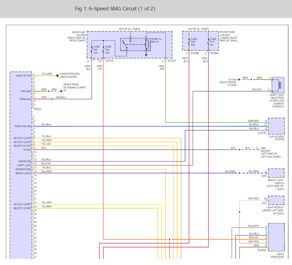

The shift interlock system has malfunctioned resulting in the gear shift being locked. Check if the brake lights are working. If not, it could be a blown fuse or a bad brake switch. Worse of the problem would be a faulty interlock solenoid/module.

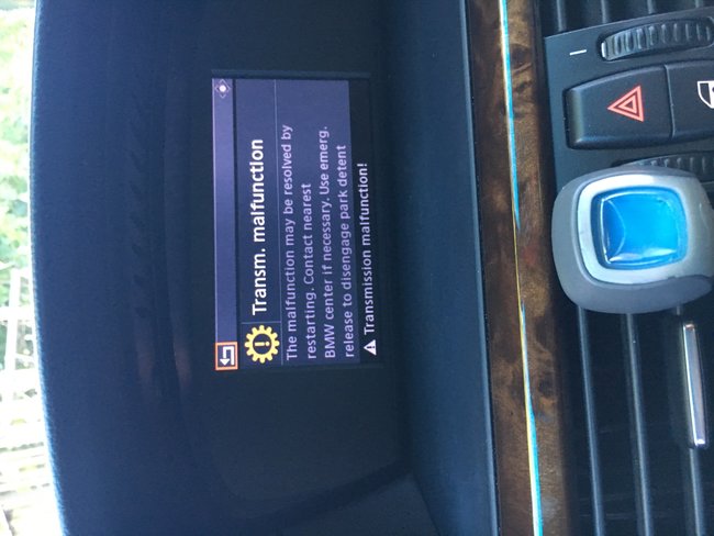

WALTER2017

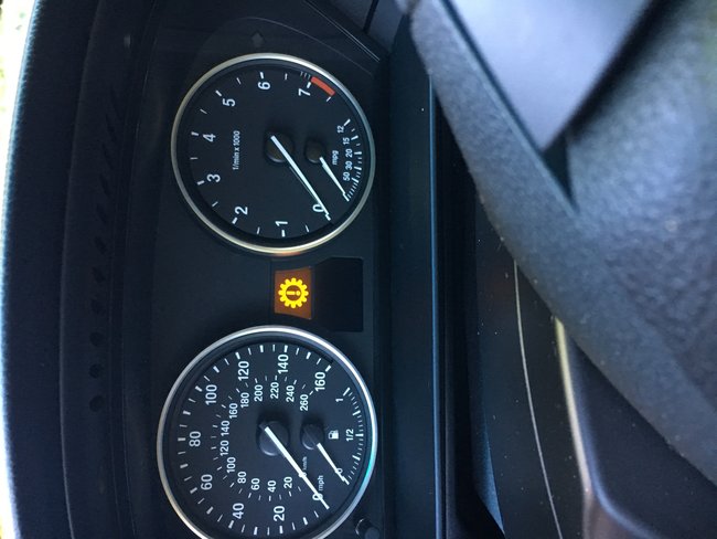

This morning when I started the engine I saw a message of transmission malfunction may be resolved with restarting the car, but restarting it did not help. I cannot change gears, just to neutral. Any advice? Thank you

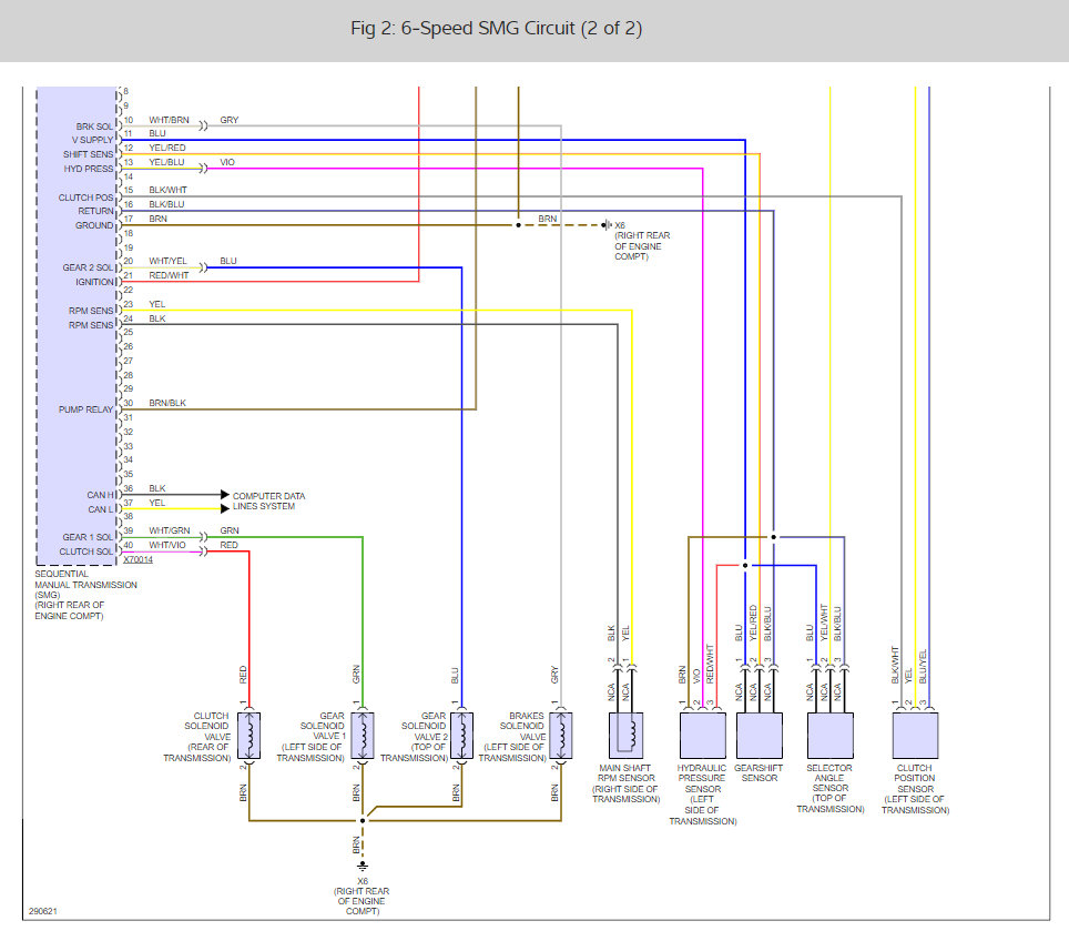

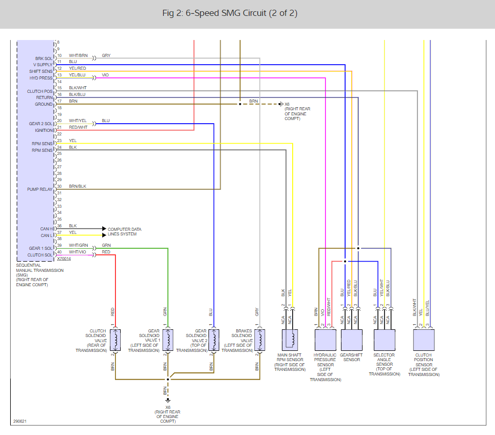

WALTER2017

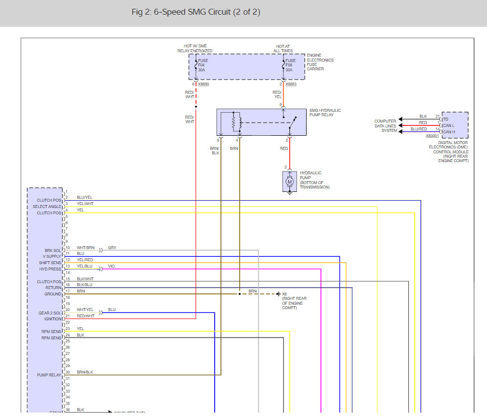

p2720 pressure control solenoid, control circuit low.
Oct 28, 2017 at 2:36 AM

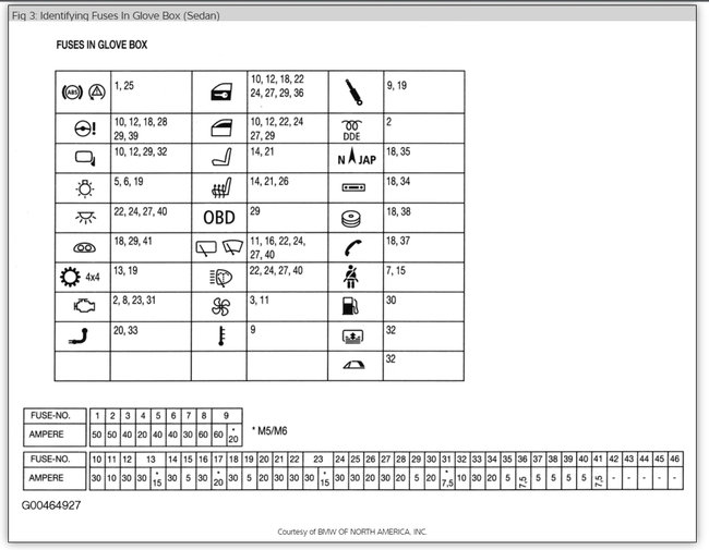

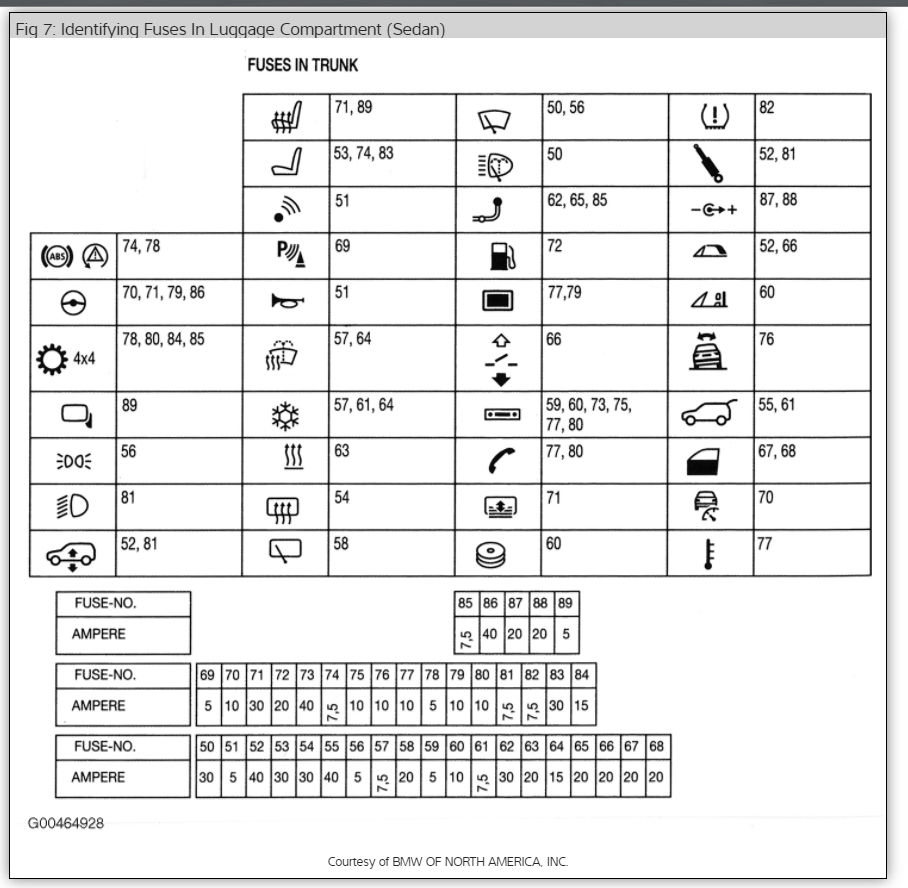

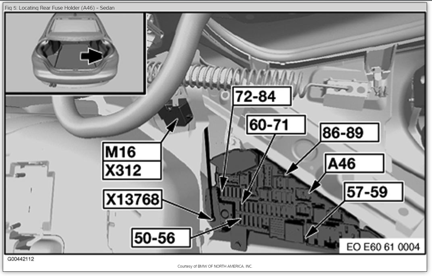

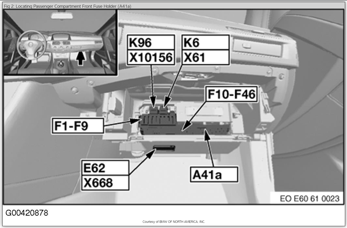

  • 55,746 POSTS

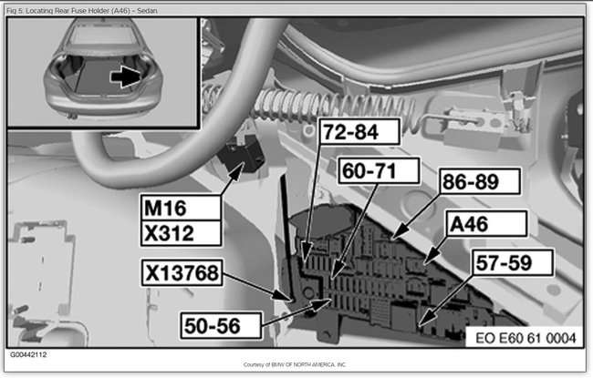

There are several fuses and a hydraulic pump relay that can go out which will cause the problem you are describing.
Here are some guides that will help you get the job done:
and
