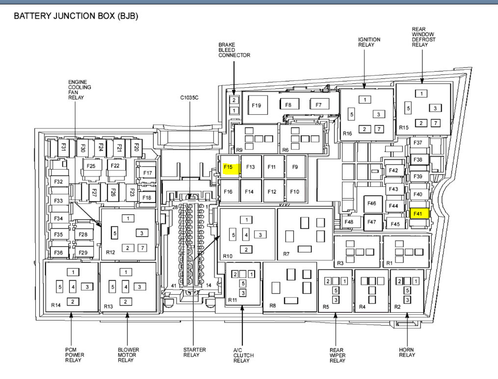

I just replaced my vehicle alternator after the outside fan belt pulley failed. After this, the engine is running but when you put the vehicle on D or R gears, the car doesn't move and displays "transmission malfunction". What do I need to do?

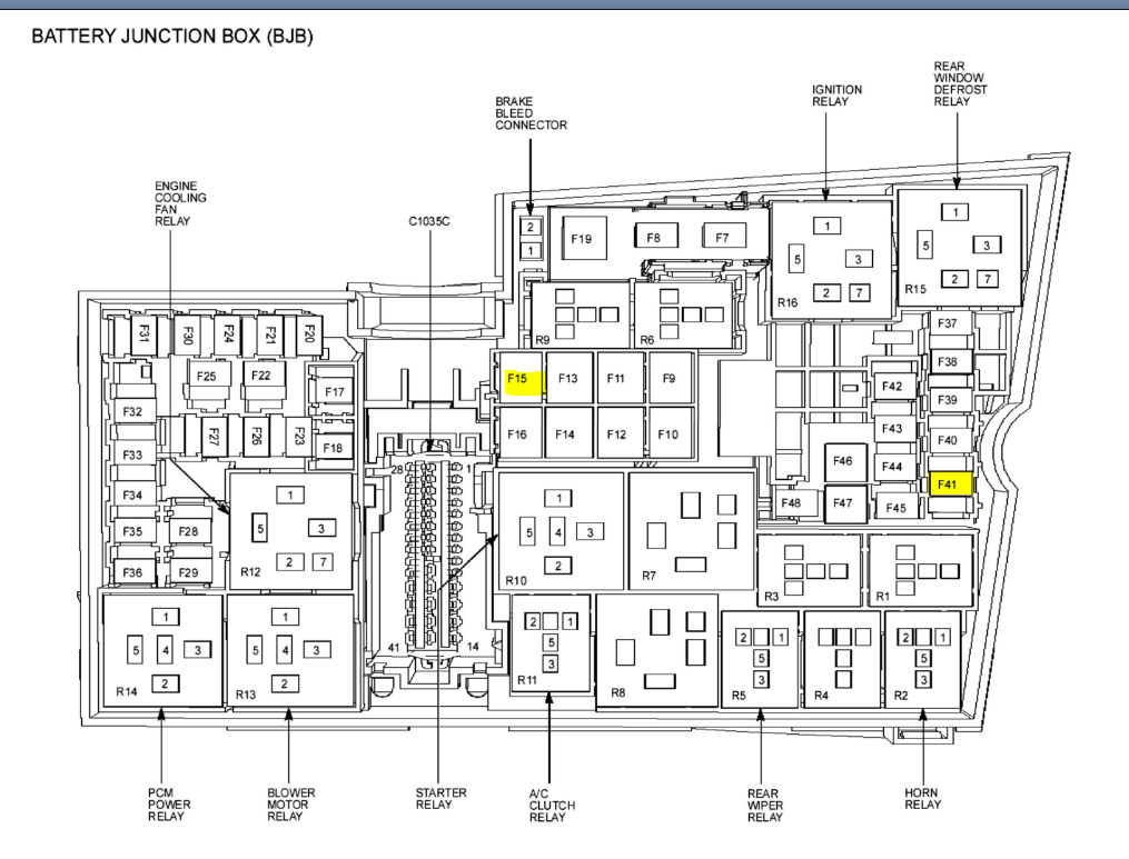

First, I need you to check two fuses in the under hood fuse box. Fuses F15 and F41. See pic 2 below for location. Here are a few links you may find helpful:

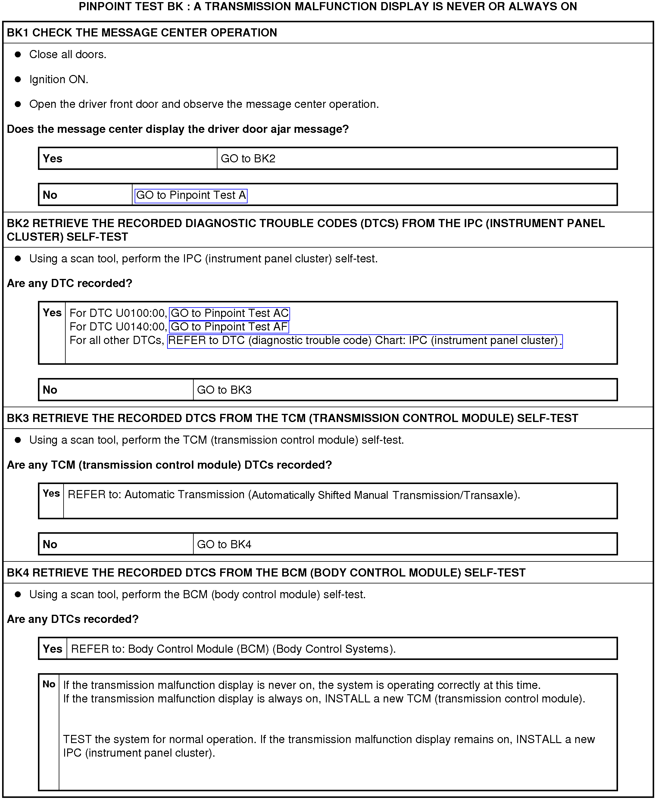

If the fuses are good, here is the test procedure which requires specialized tooling. The pic attached is the actual diagnostic flow chart. I realize this is something you may not be comfortable with, but wanted to add it so you could see what will need done.
2013 Ford Focus L4-2.0L Turbo
Pinpoint Tests BK: A Transmission Malfunction Display Is Never Or Always ON
Vehicle Instrument Panel, Gauges and Warning Indicators Testing and Inspection Pinpoint Tests Instrumentation, Message Center and Warning Chimes Pinpoint Tests BK: A Transmission Malfunction Display Is Never Or Always ON
PINPOINT TESTS BK: A TRANSMISSION MALFUNCTION DISPLAY IS NEVER OR ALWAYS ON
Pinpoint Tests
A Transmission Malfunction Display Is Never Or Always On
Diagnostic Overview
Diagnostics assume a certain skill level and knowledge of Ford-specific diagnostic practices.
REFER to: Diagnostic Methods See: Vehicle > Initial Inspection and Diagnostic Overview > Diagnostic Methods (General Information). See: Vehicle > Initial Inspection and Diagnostic Overview
Normal Operation and Fault Conditions
See Transmission Malfunction Displays.
REFER to: Message Center - System Operation and Component Description See: Instrument Panel, Gauges and Warning Indicators > Components > Message Center - System Operation and Component Description (Instrument Panel, Gauges and Warning Indicators).
Possible Sources
- TCM (transmission control module)
- BCM (body control module)
