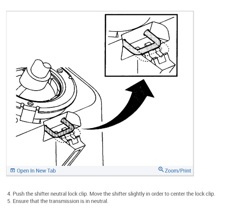

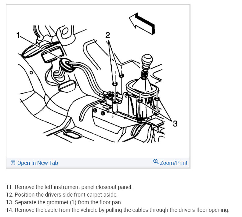

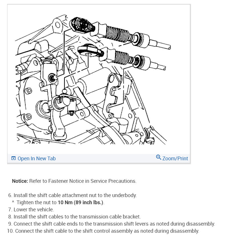

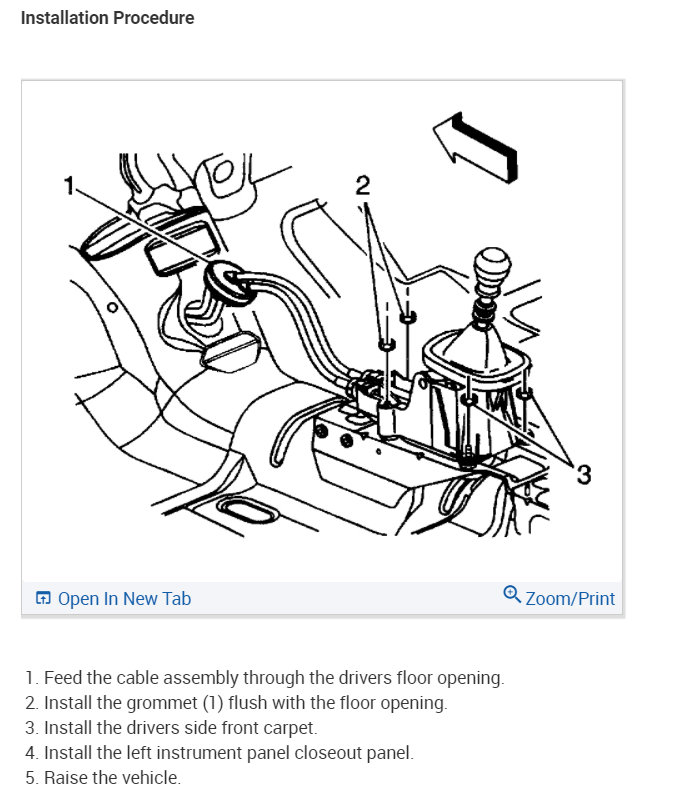

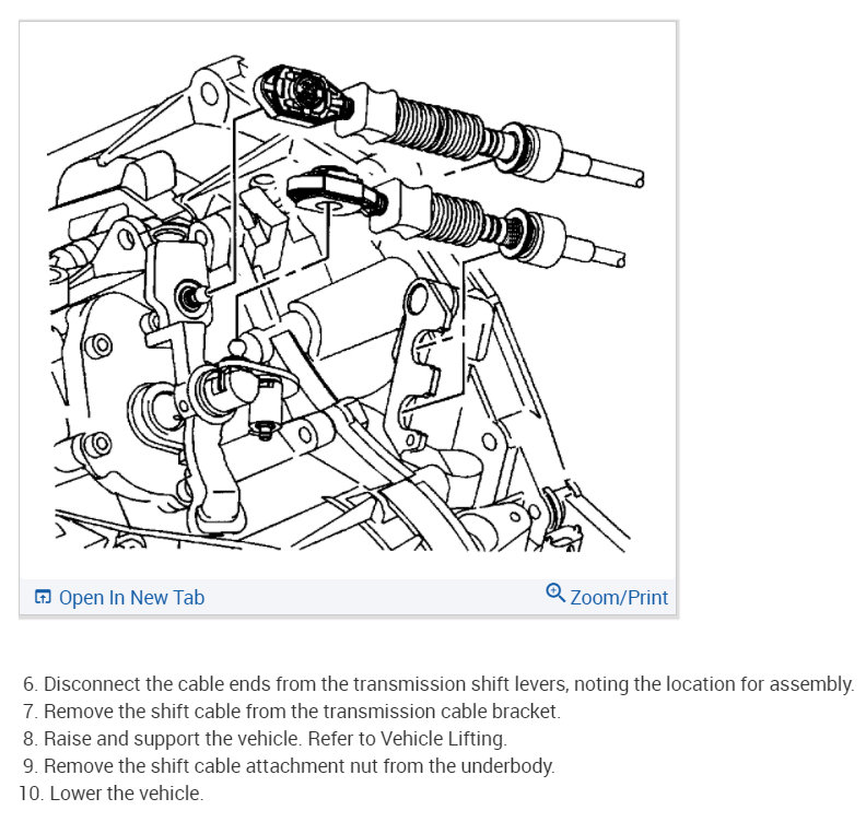

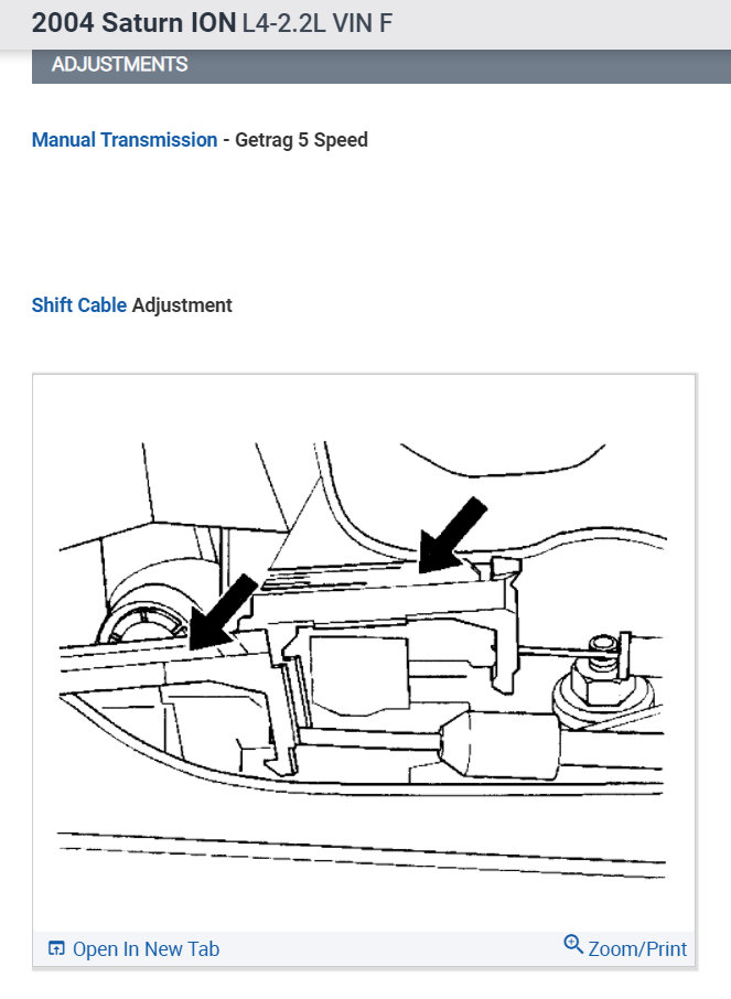

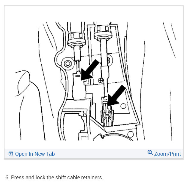

my transmission linkage came loose. I think a u clamp came out not sure though. just seeing if anyone knows how to put it back in place, I can't find out how anywhere.
Apr 5, 2022 at 9:52 AM
  • 55,732 POSTS

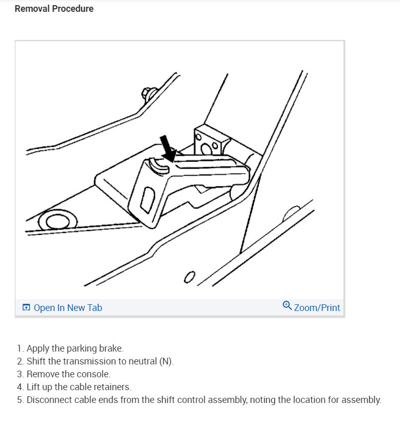

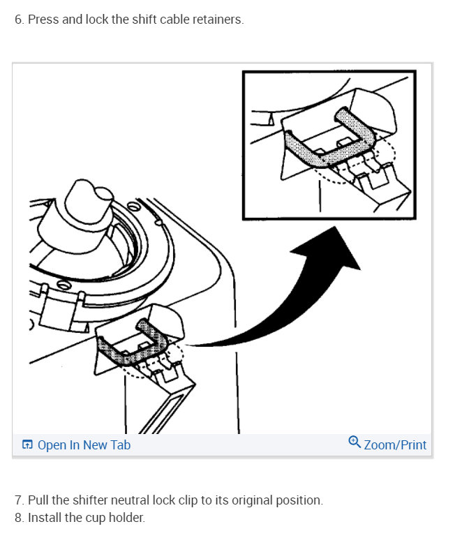

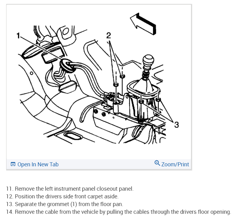

Here are the instructions on how to replace the shift cables which show how they go and how to reattach the clamp that holds them in the diagrams below. Check out the diagrams (below). Let us know what happens and please upload pictures or videos of the problem with response.
