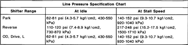

The lines have been puttied with some kind of JB weld I think it is still. Dripping transmission fluid pretty quick. it is a rubber and metal line built together or at factory it might be pressure or transmission cooler line not sure. there is two right next to each other and they are dripping good they maybe had a pin hole or a bracket rusted then he put engine mount on. after he paid it off but don't know if dry rotted. what can I do so it'll stop leaking right away?

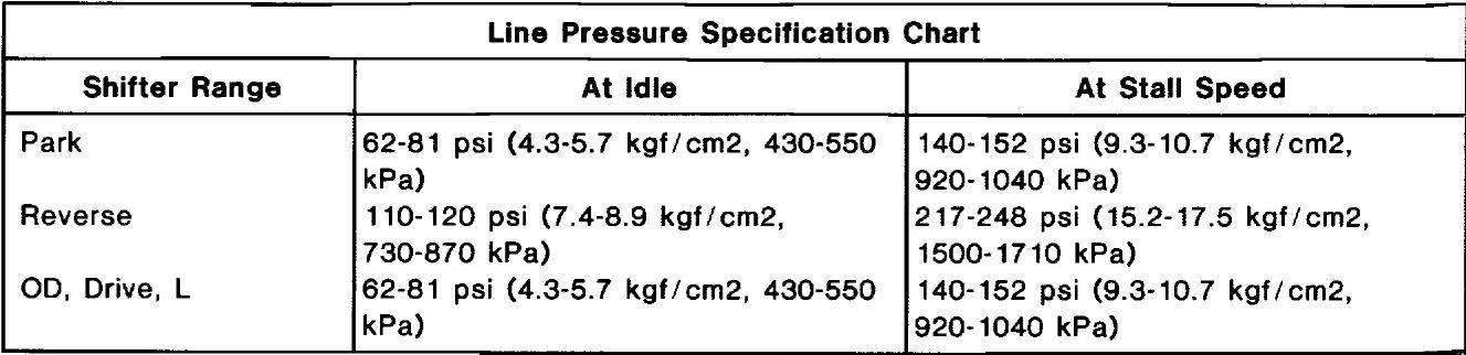

The steel transmission cooling lines rust and then begin to leak. Products such as you mentioned will not take the pressure the system makes. As a result, you still have a leak. The only way to fix it is to replace the lines. I attached a picture indicating how much pressure those lines see at an idle and in different gears. Take a look at it.
