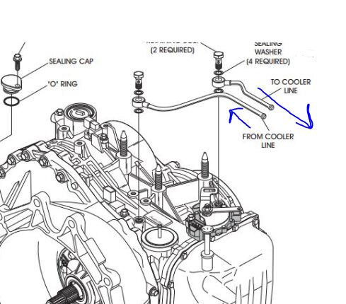

Put a new radiator in and not sure I have the hoses on the radiator the correct way.
Jul 29, 2023 at 4:05 AM
  • 110,244 POSTS
I attached a pic below showing the flow of the transmission cooling lines. From the transmission to the cooler, that one should go to the top of the radiator. The return comes from the lower connector on the radiator.
Let me know if this helps.
joe
See pic below.
