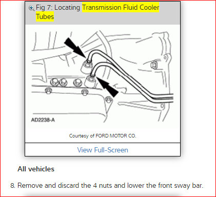

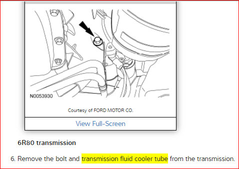

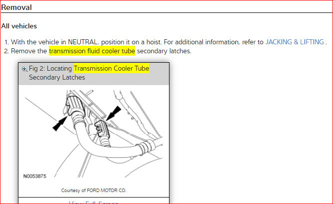

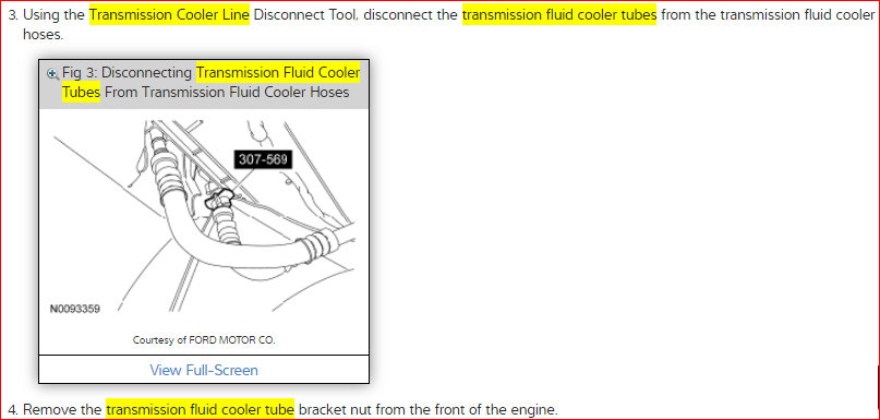

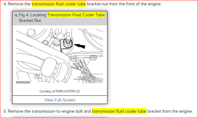

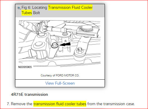

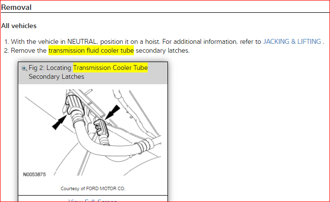

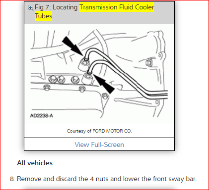

I have the XL model, (gas). I need to replace the transmission line that go from the transmission to the cooler, they are routed between the engine and a big cross member. How do you get them out and the new ones in?

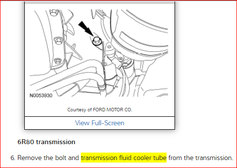

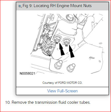

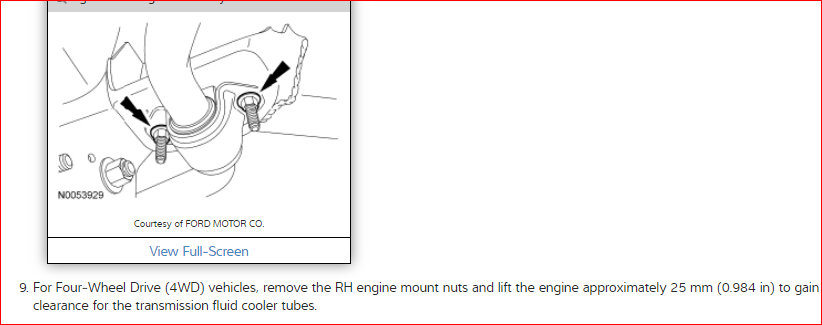

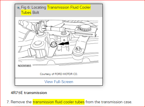

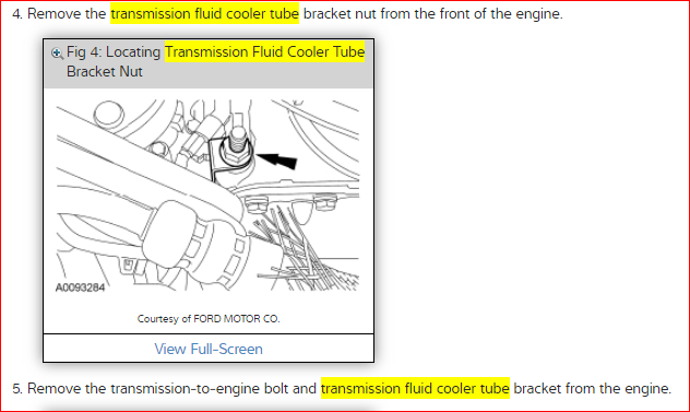

I have attached a bunch of pictures that are step-by-step for removal. Installation is reverse order. Hope this helps and feel free to ask any questions if needed. Thanks for using 2CarPros.
