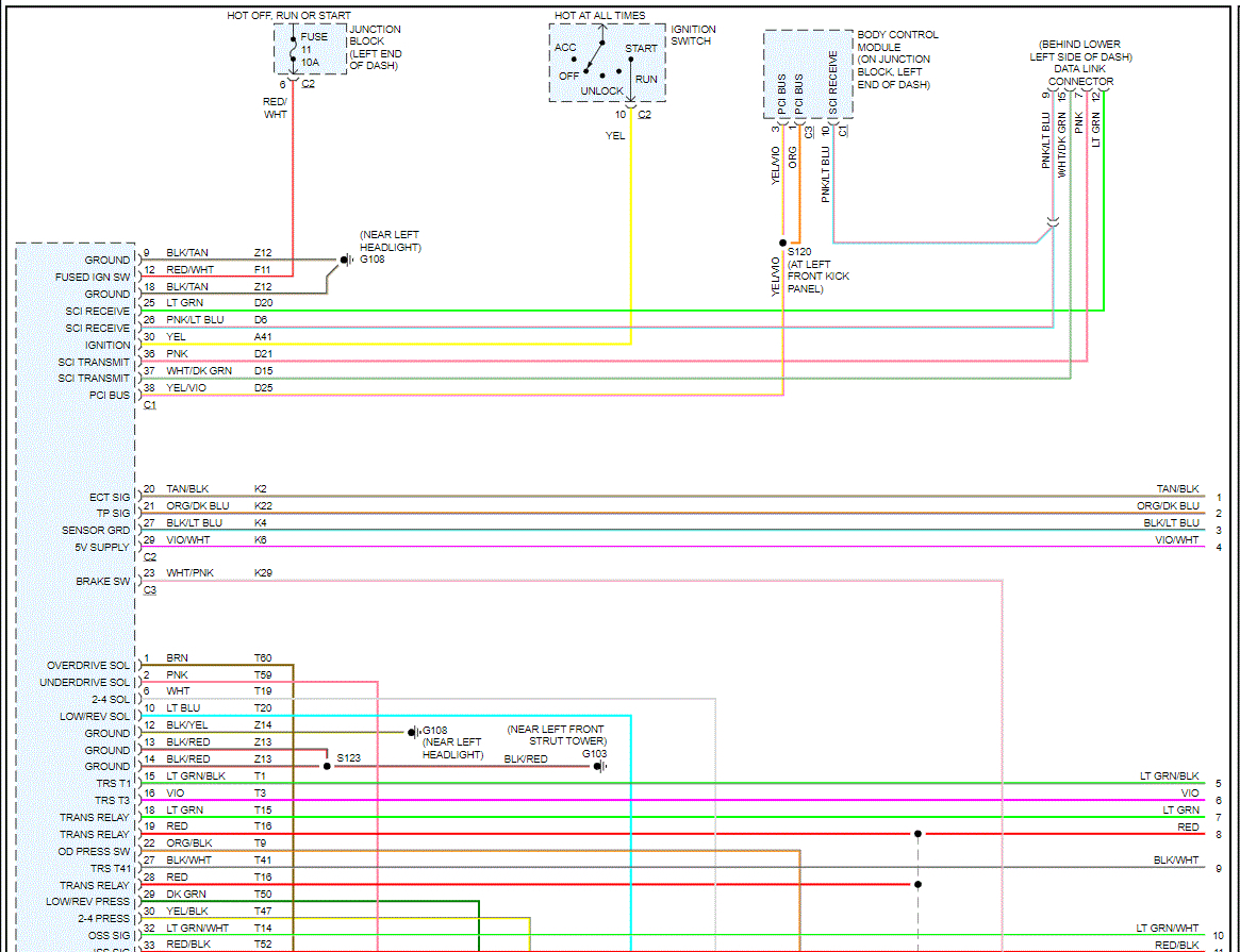

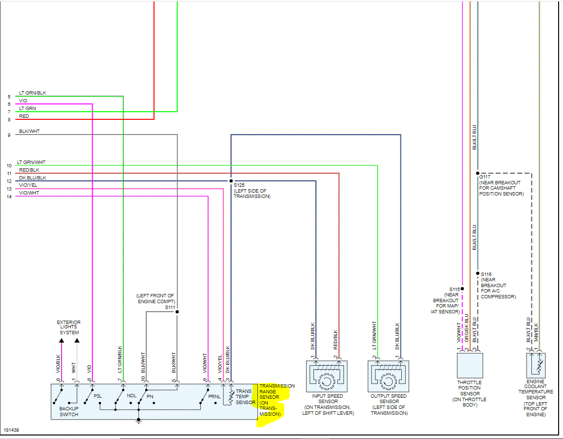

I attached a wiring diagram for you as well of the transmission system

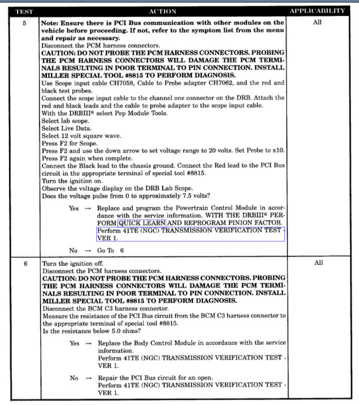

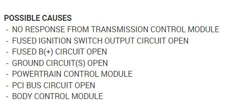

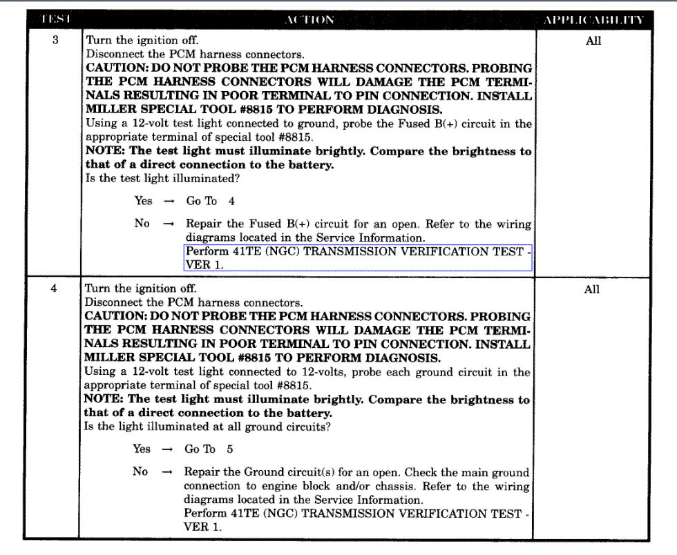

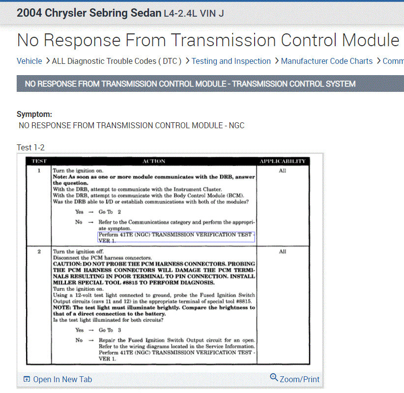

Without a code, I found general diagnostics for transmission problems. I have a feeling there is an issue within the can-bus where the TCM isn't communicating with the PCM, or there is an internal fault within the TCM. If it is in limp mode, there should be codes.
Take a look at the diagnostics below. Let me know if this is something you are comfortable doing. They are specific to a no-response condition from the TCM. Since there are no codes and it's in limp mode, there must be a breakdown in communication.
If you are able to, check to see if you are able to communicate with the TCM using your scan tool. If you can't, try going through the diagnostics below.

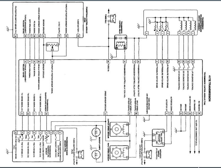

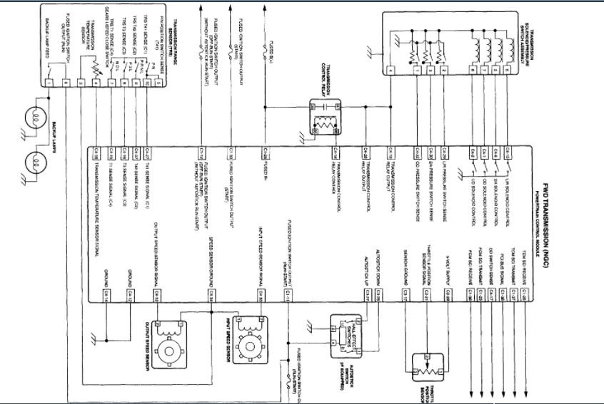

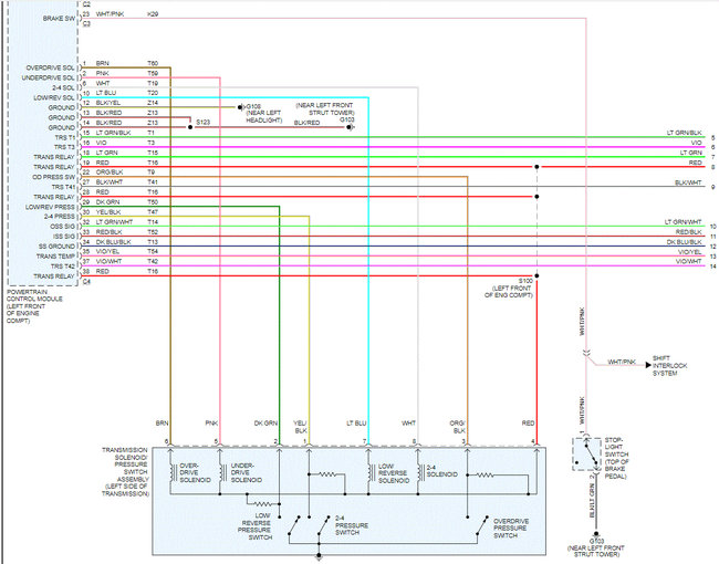

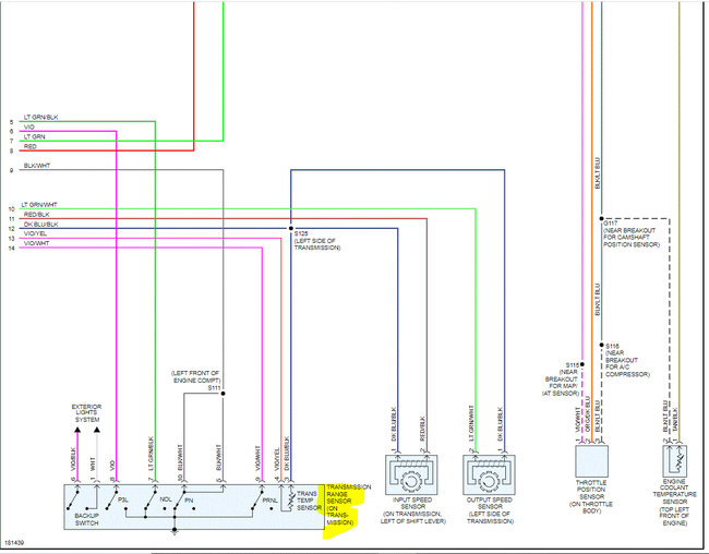

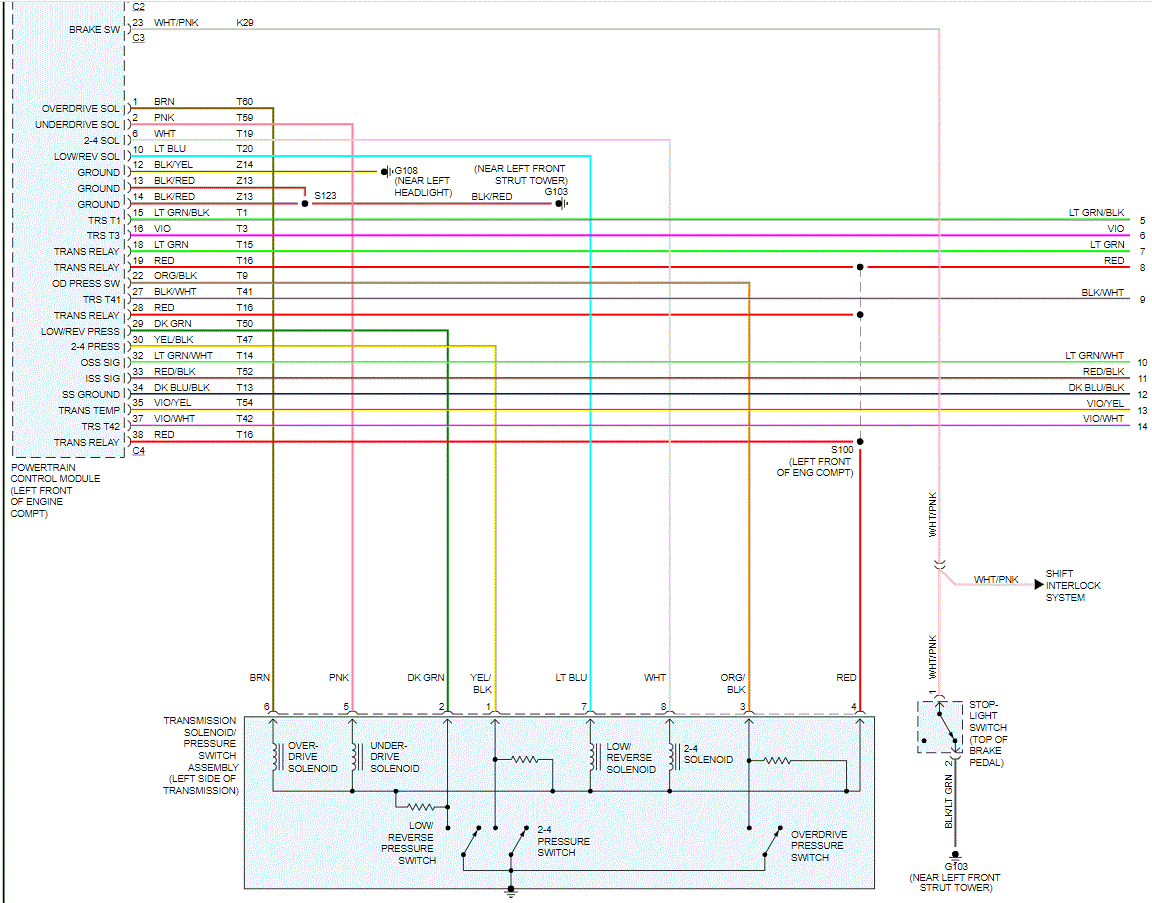

As far as the TRS, absolutely there could be an internal wiring issue. I attached the wiring schematic for the entire transmission control circuit below for your review.
The idea that the indicator isn't showing a gear is likely the cause of the vehicle being in limp mode. It doesn't recognize what gear it is in.

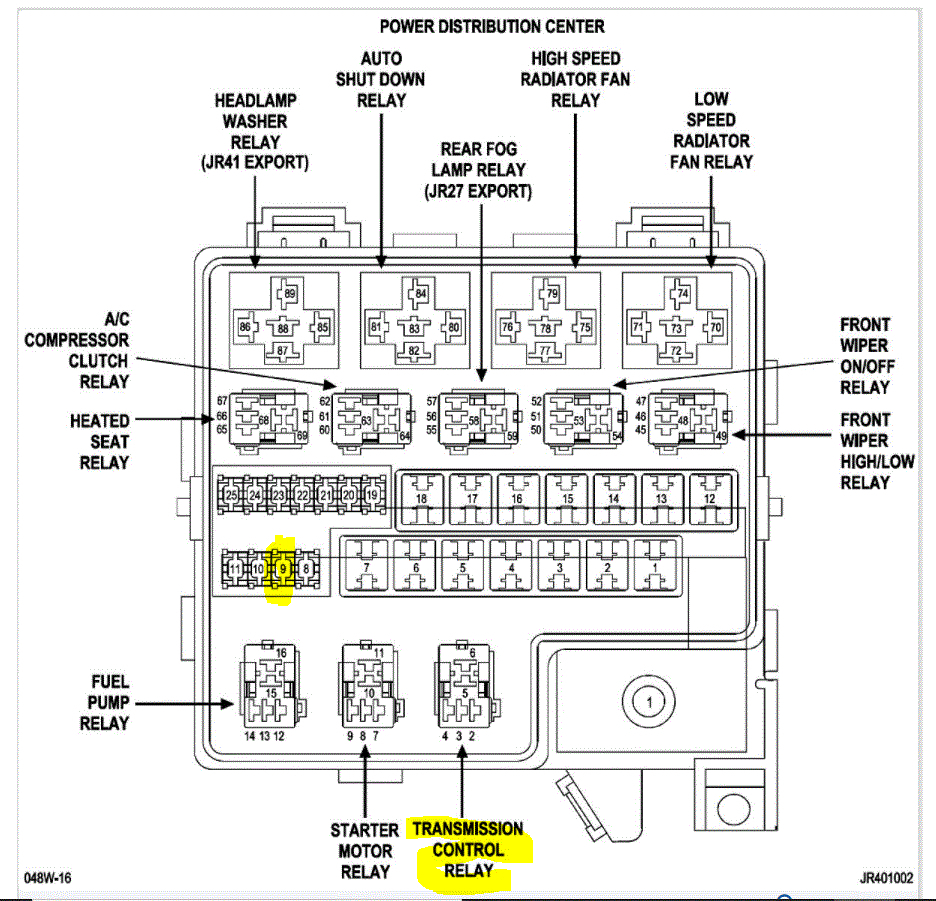

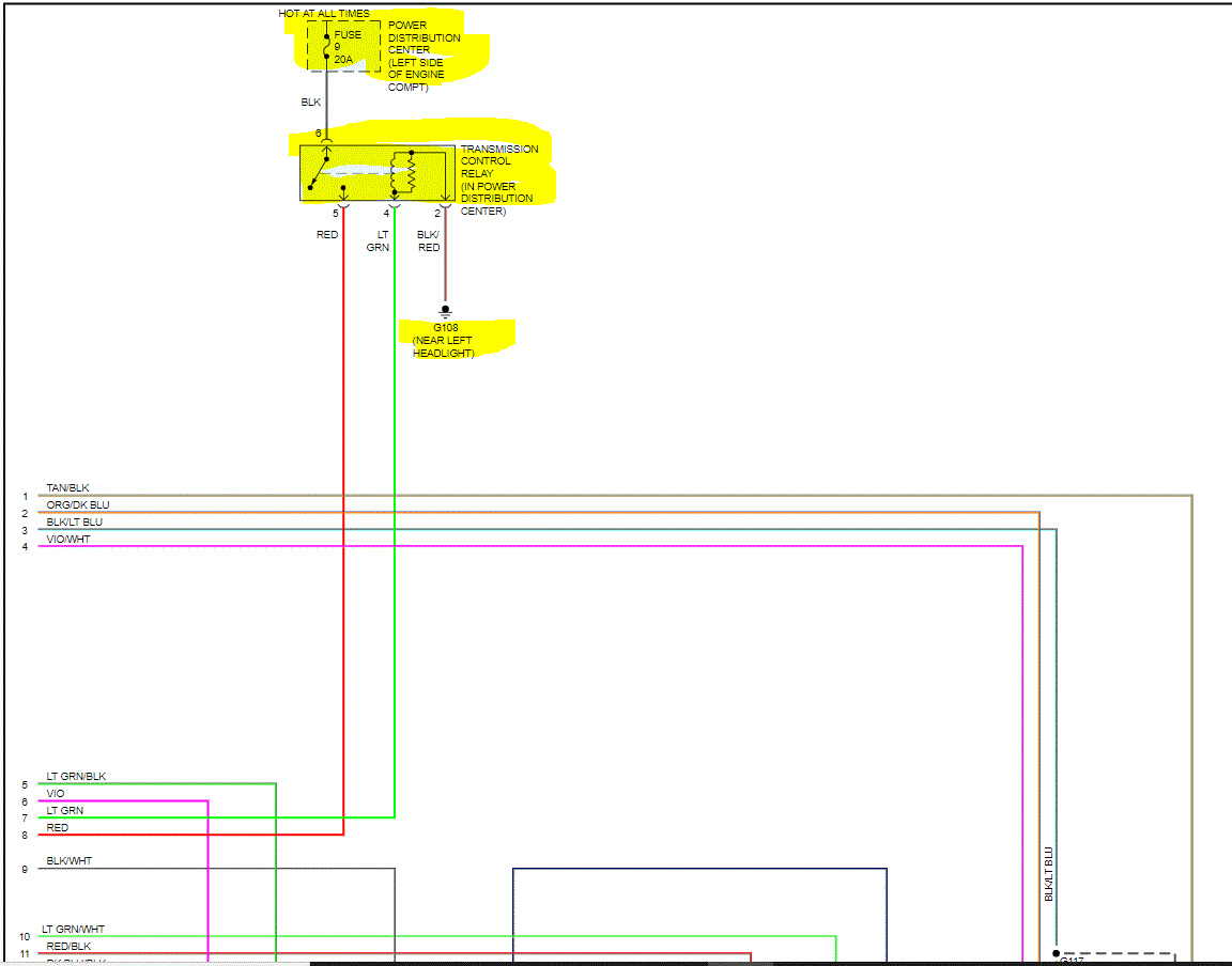

I need you to check something for me. Fuse 5 in the power distribution center under the hood powers the transmission control relay. First, make sure the fuse is in good condition and the connection in the box isn't damaged, corroded, or have a pin pushed in.
If that is good, then check the control relay. If there is another one with the same part number, switch them. If there isn't, here is a link that shows how to test one:
Pics 1-4 are the wiring schematic. The last pic shows the power distribution box. I highlighted the fuse and relay to check.
Let me know what you find.

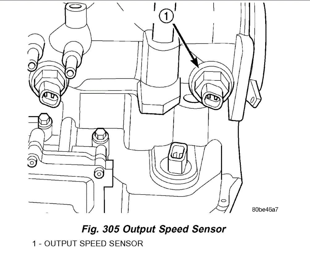

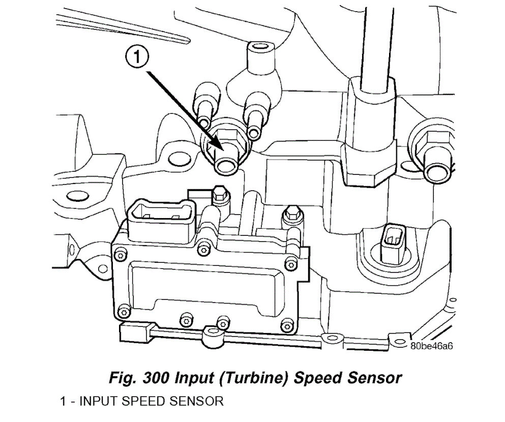

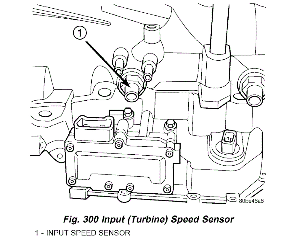

As far as the speed sensors, there is an input sensor and an output sensor. I can't say for sure if one is an issue without a code. Without the code, it becomes a guessing game.
Both the input and output sensors are hall effect sensors that create an AC current. I attached two pics below showing the locations. The TCM compares the input and output speed signals to determine gear ratio, speed ratio errors, and clutch volume index calculations. So, it can cause problems. You can check the sensors for an AC output, but I don't have specifics as far as speeds and voltages. That is where the code would help.
If you want, remove the sensors' connections, connect a digital multimeter to the two connections pins in the sensor. Next, place the DMM on AC voltage and with the front of the vehicle safely off the ground, turn the engine on, place it in gear, and see if there is an AC voltage signal. If there is none, the sensor is bad.
