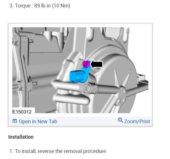

Hello, I have the vehicle listed above TDCi Titanium Automatic. Yesterday I received the note: Transmission limited Function. I stop the motor, started then and the note disappeared, the car was okay. Today I started, the speed was not greater than 40 km/hr, the note appeared again! I stopped the car, started again, used manual commands, was okay, then I used automatic and I had no problems, about 250 km. What to do? Thank you.

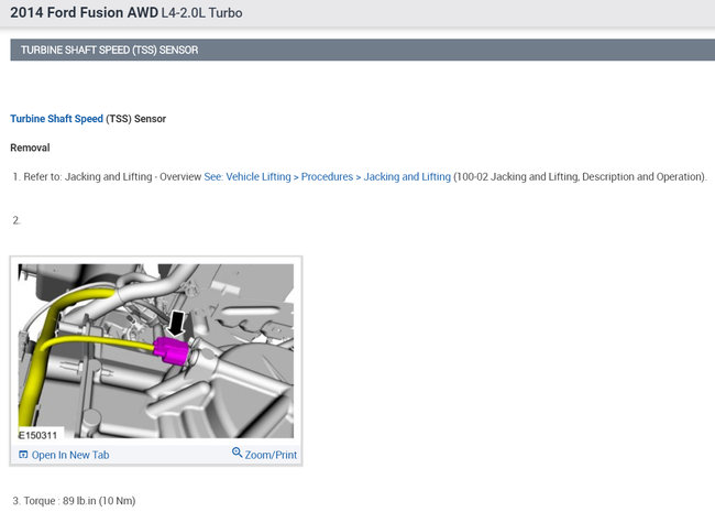

It sounds like you have an input shaft speed sensor that is not working correctly. To be sure we should run the codes to see if anything comes up. here is a guide:
Here is the location of the sensor so you can check it out. Check out the diagrams (below). Please let us know what you find. We are interested to see what it is.
