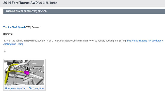

My car has this problem; transmission limited function.why coming this problem please explain to me?
Dec 9, 2019 at 8:52 PM
  • 55,423 POSTS

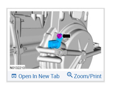

This is common when the input shaft speed sensor (turbine) goes out, but we should urn the codes first. here is a guide and the location of the sensor in the diagrams below:
