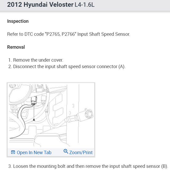

When I put it into gear and pushed the gas pedal FI reach over 1500 rpm, so it bogs down. But if I keep it under that it will go up to five miles an hour then put it in second in a go up to ten miles an hour. After that it just wants to bog down when I pushed the gas pedal. The transmission light is on.

I cleaned the throttle body out before I did that my check engine light was on. So I reset the codes the codes were 7e8 and 7e9 and the rear speed sensor. I cleaned the throttle body and put it back on and started it up now it is still running the same way and I also checked the coils to number four is sparking but not firing.
Nov 19, 2018 at 3:29 AM
  • 55,721 POSTS

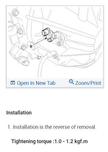

Those speed sensor codes can cause the issue. Here are the locations so you can replace them and see what happens.
Refer to DTC code "P2765, P2766" Input Shaft Speed Sensor
Check out the diagrams (below). Please let us know what you find.
