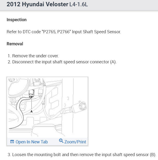

When I put it into gear and pushed the gas pedal FI reach over 1500 rpm, so it bogs down. But if I keep it under that it will go up to five miles an hour then put it in second in a go up to ten miles an hour. After that it just wants to bog down when I pushed the gas pedal. The transmission light is on.

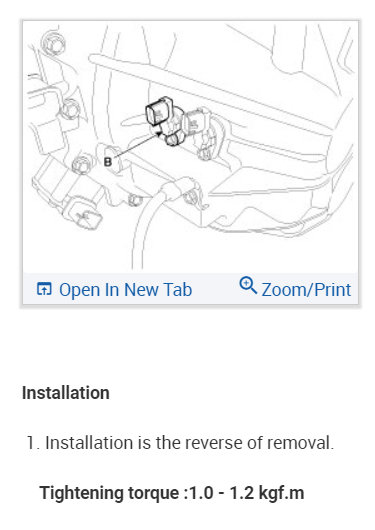

Those speed sensor codes can cause the issue. Here are the locations so you can replace them and see what happens.
Refer to DTC code "P2765, P2766" Input Shaft Speed Sensor
Check out the diagrams (below). Please let us know what you find.
