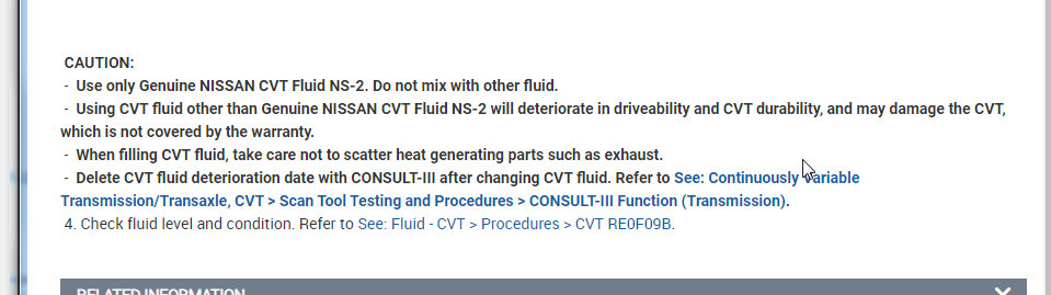

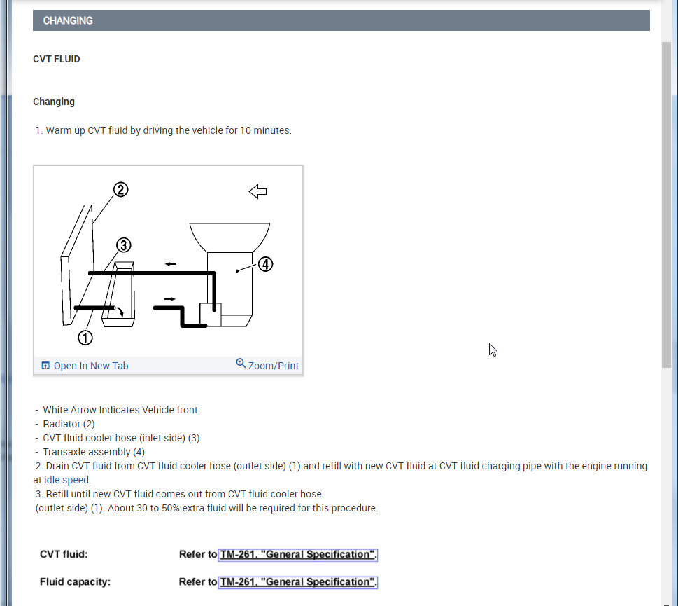

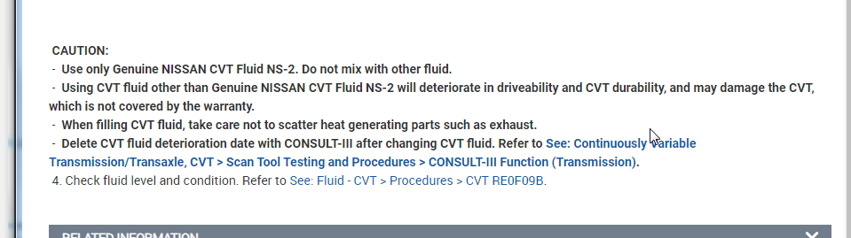

Can you help me service the transmission?
Jan 30, 2021 at 12:52 AM
We can help with that. Please see this guide that will help with this is in general terms:
Also, below is the info from the manual. Please make sure you are using the proper fluid for this CVT transmission.
Please let us know if you have other questions. Thanks
