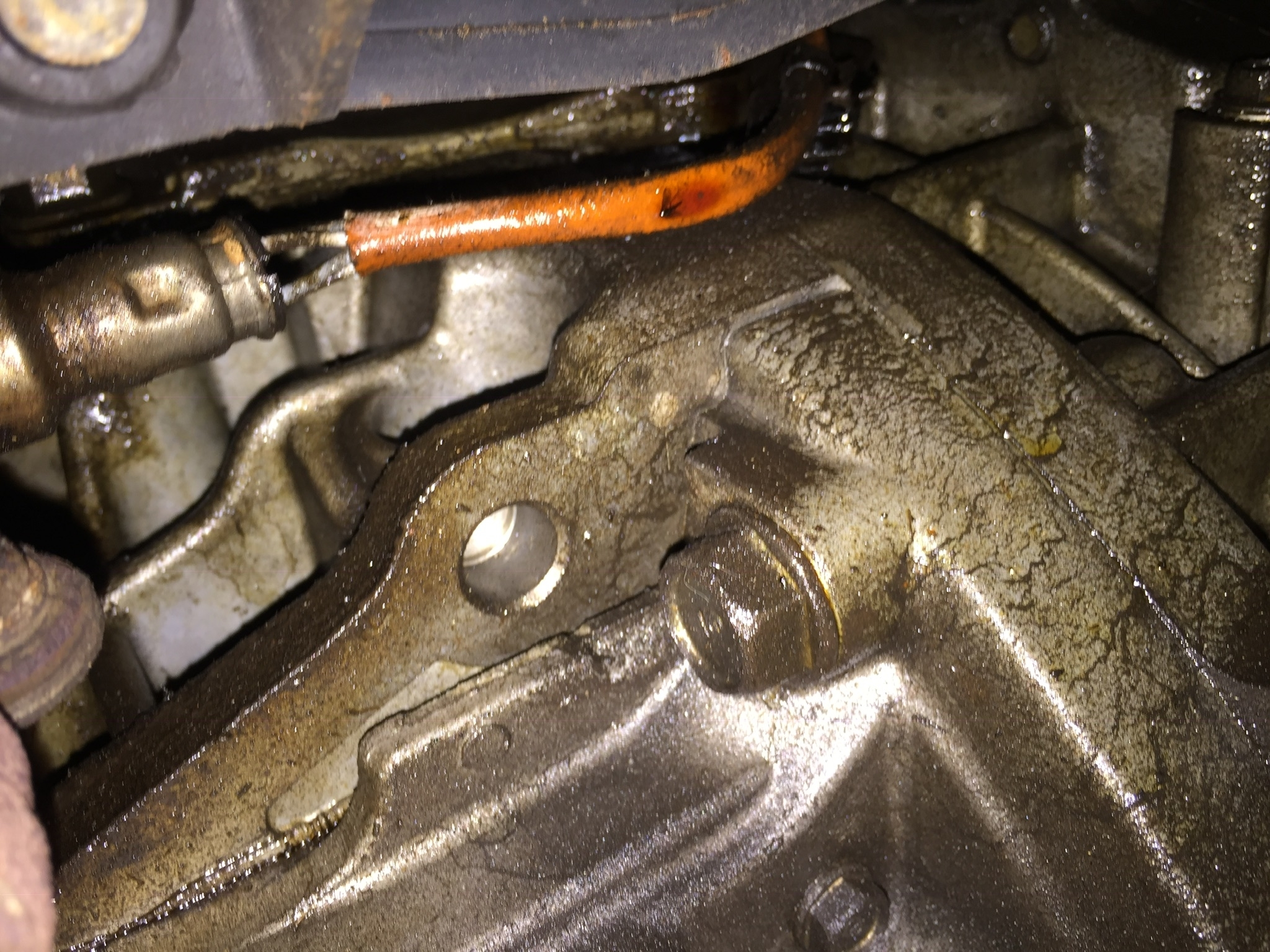

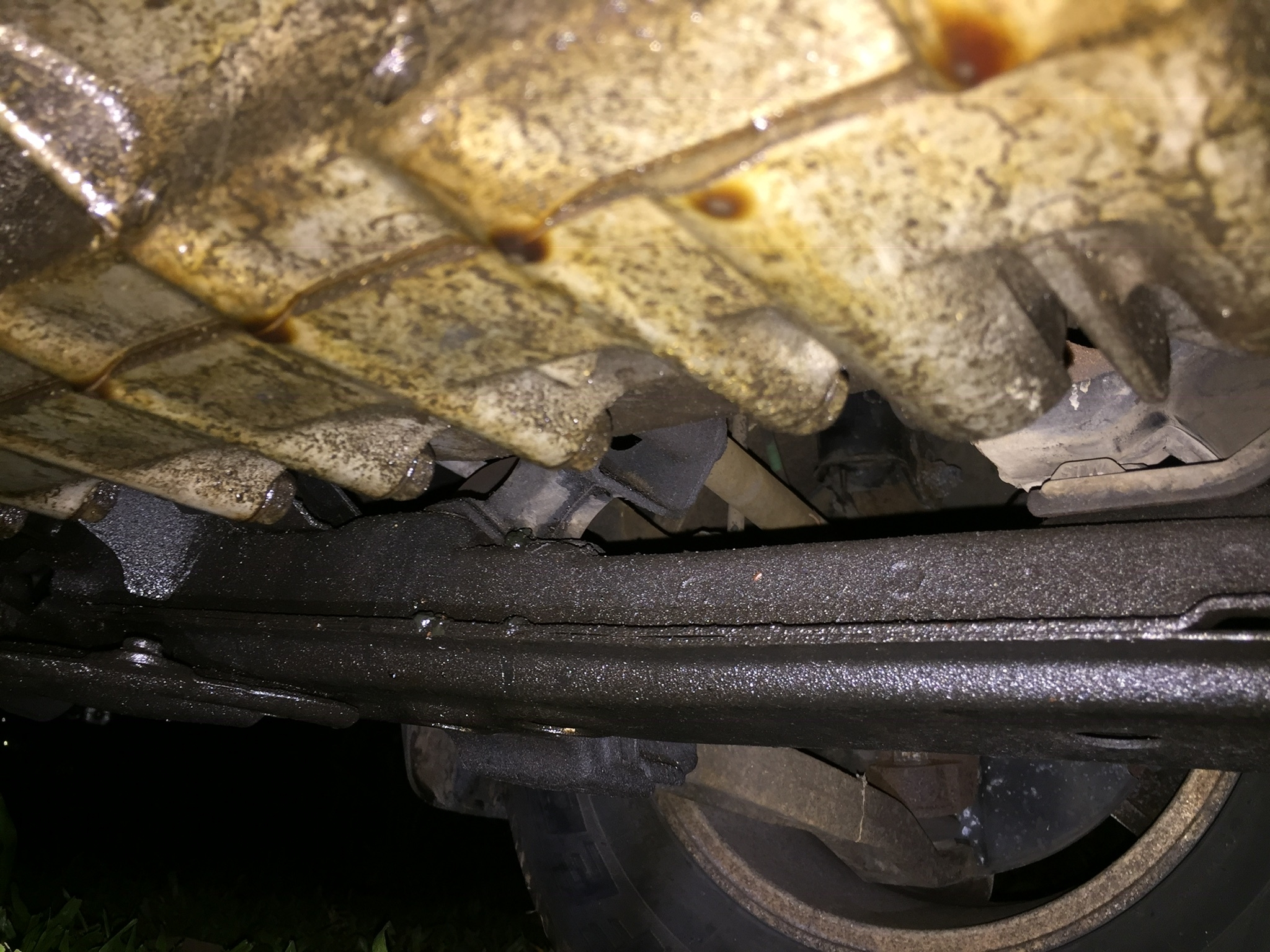

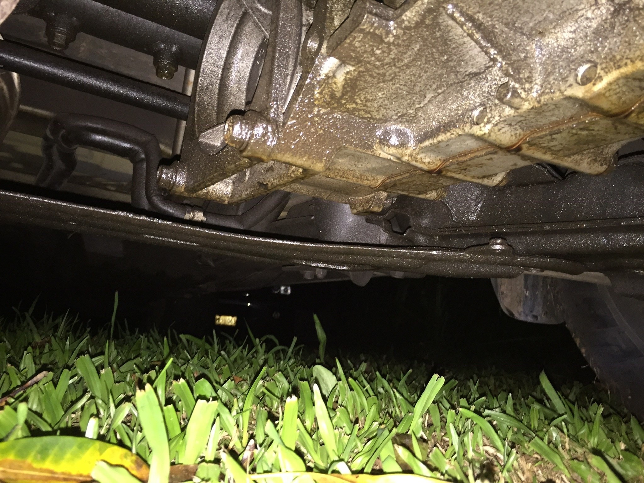

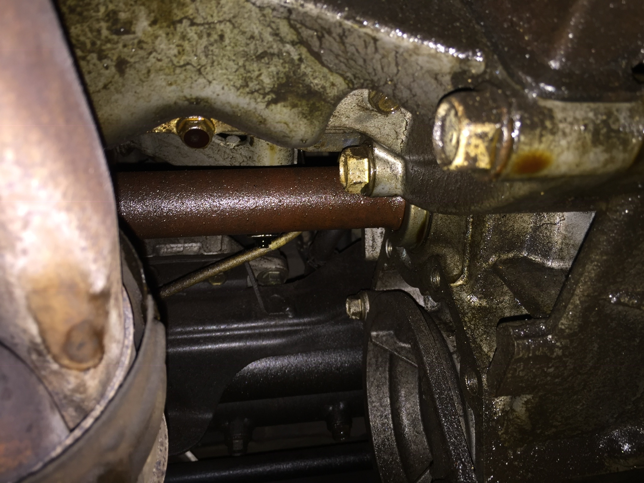

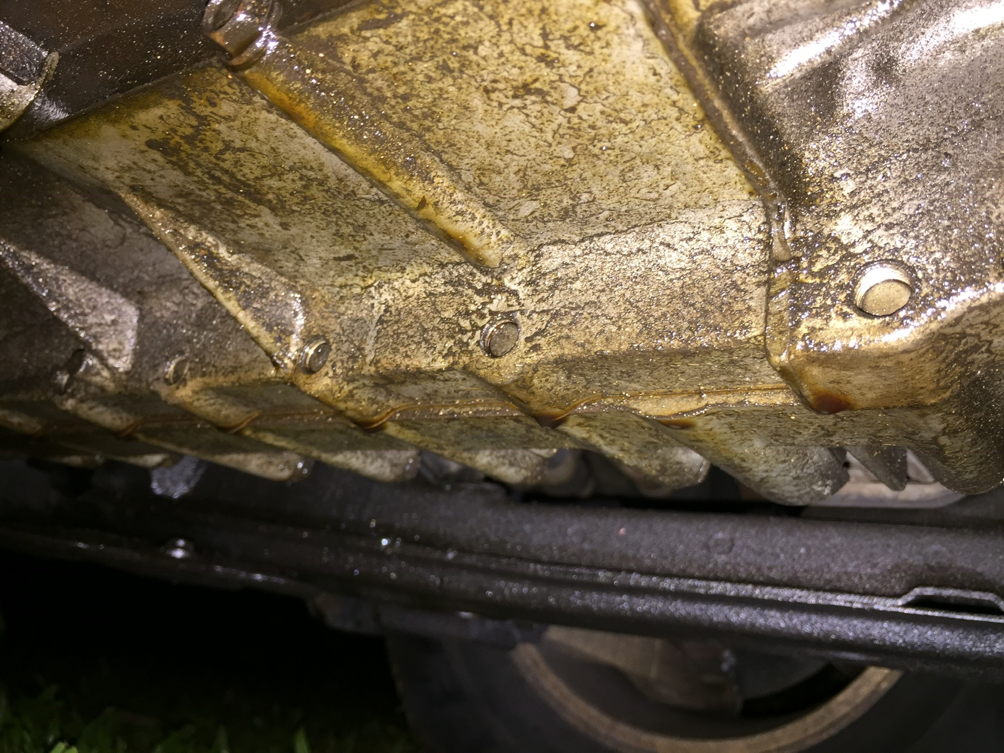

I just bought the vehicle list above and there was no transmission fluid on the dipstick. Ended up putting three quarts just to register a reading on the dipstick. Thereafter I flushed the transmission and put in 8.9 quarts of new fluid. A week later there is lots of fluid under the transmission and surrounding areas. It seems to have lost perhaps a half quart maybe less but it was relatively dry, I cleaned it, at the time of flushing. It is not leaking from the radiator area and higher than the pan. What could it be?

There are so many places it can leak and without us getting a view of the transmission, it would be a guess. Can you post a picture of the underneath of the car so I can see what it looks like?
It could be the front seal, bulk head seals where the axles mount or the case itself.
Please post some pictures for us to view.

The pictures look like an oil leak, not transmission leak.
My suggestion is to have the bottom of the car cleaned with a high-pressure wash from a car wash. Then run it and look for leaks. If you cannot find it, then take it somewhere and have them look at it for you to at least tell you the origin of the leak.
