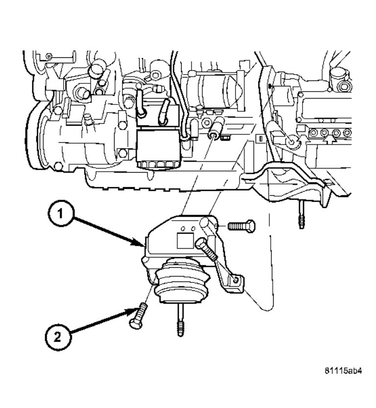

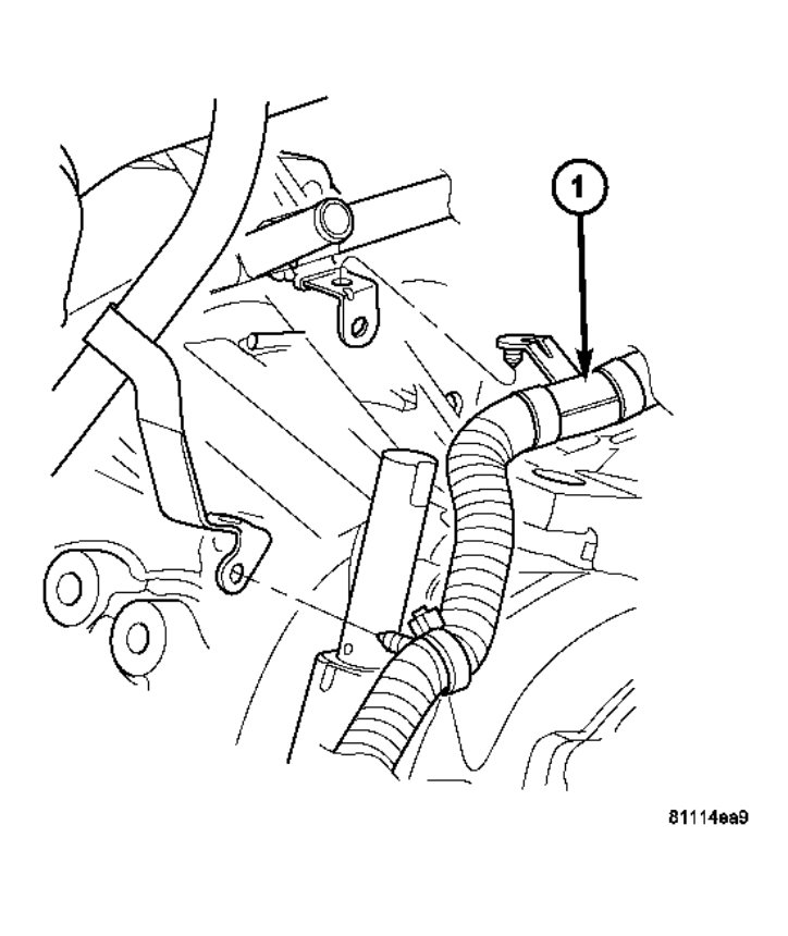

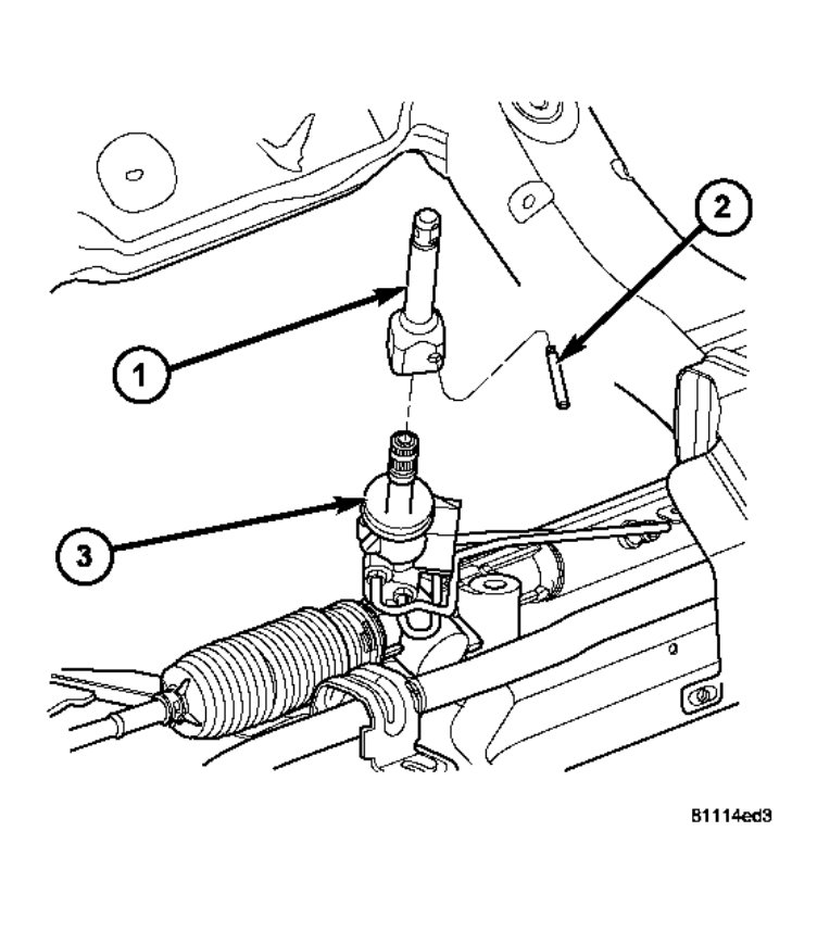

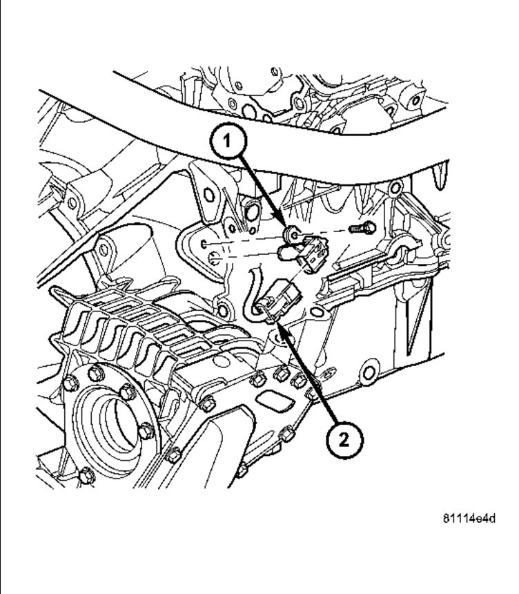

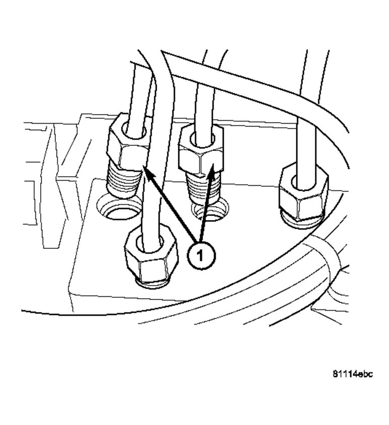

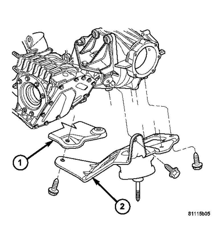

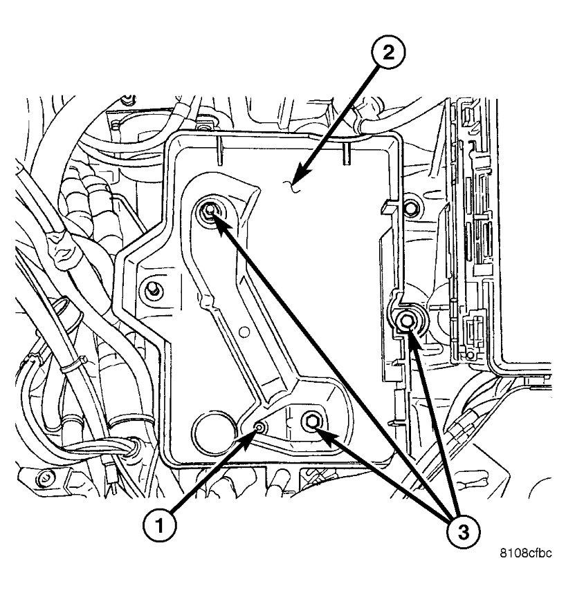

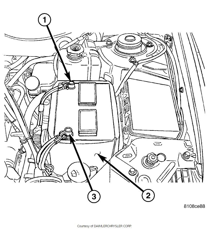

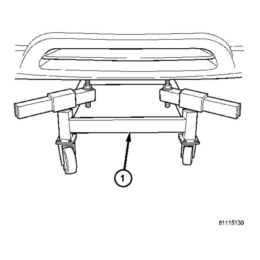

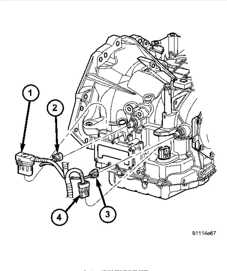

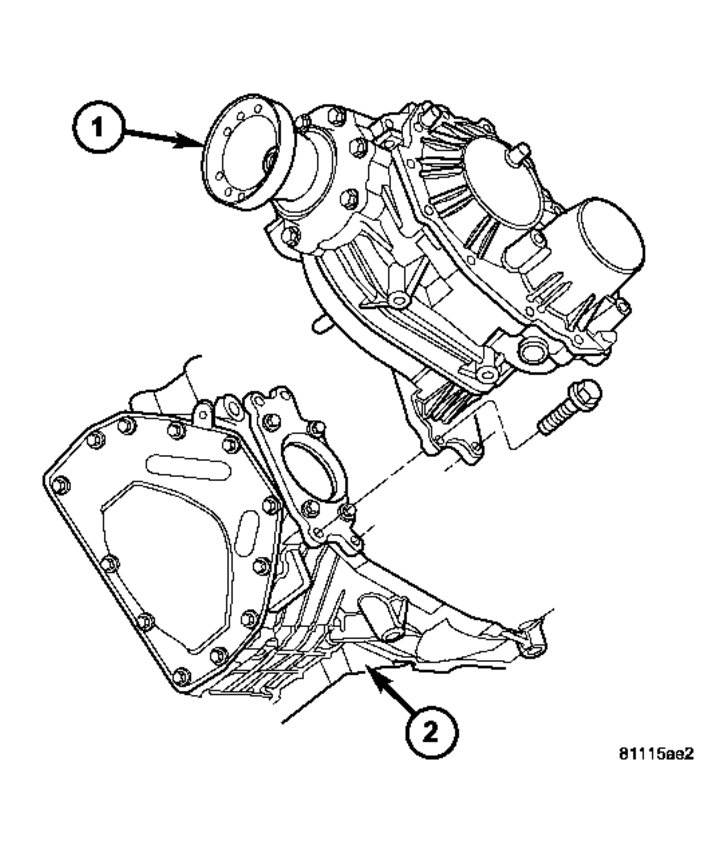

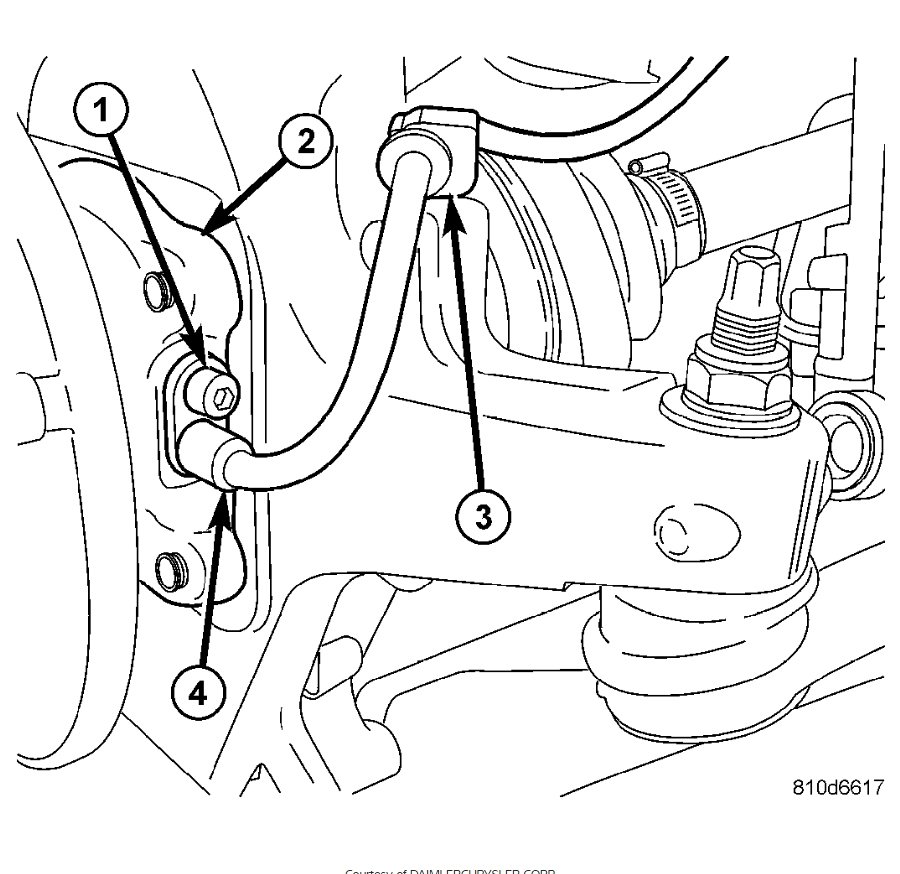

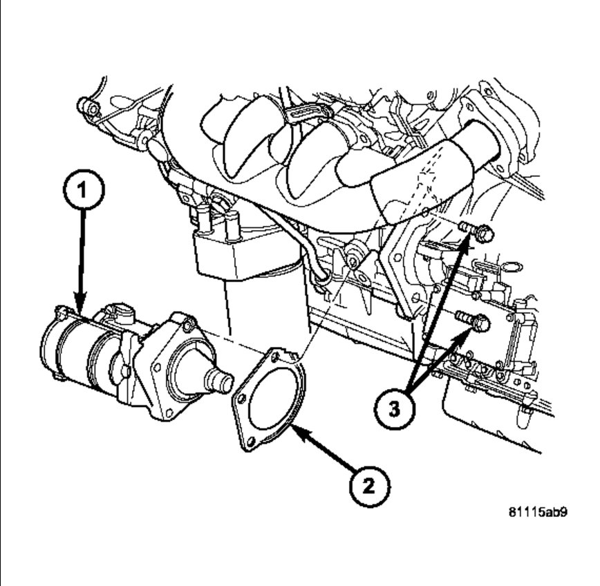

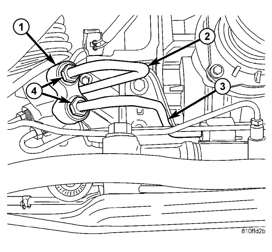

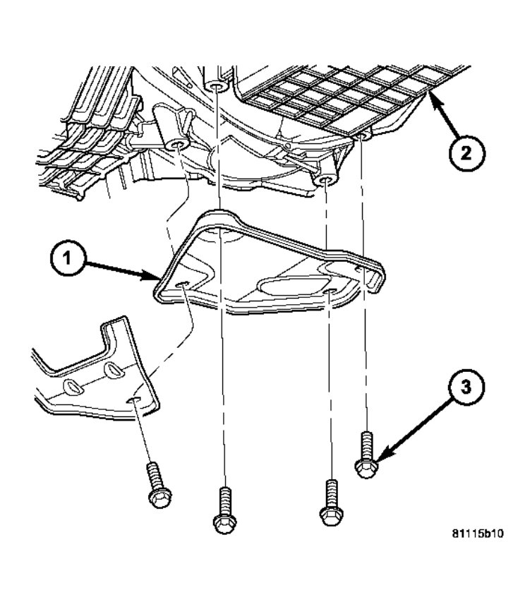

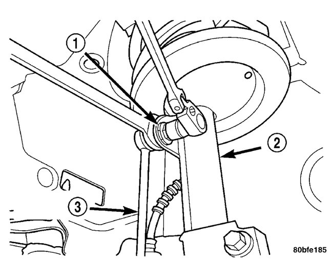

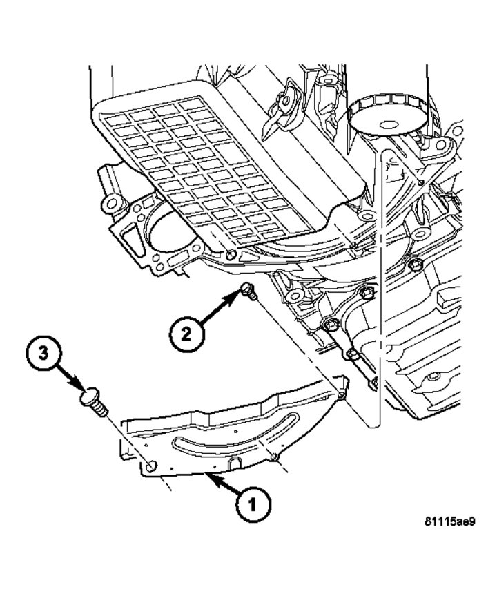

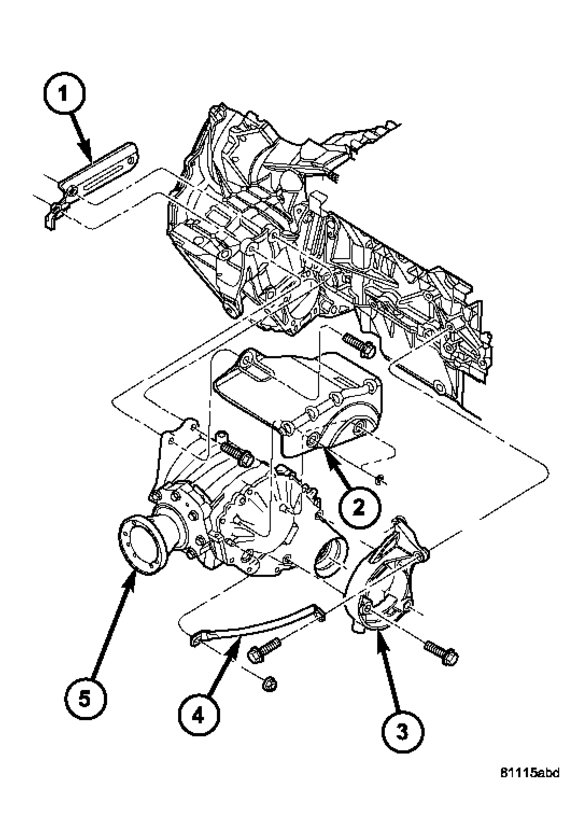

Do any additives work to seal leaks? If I need to remove the transmission can I remove the transmission without having to remove the engine on 2005 Chrysler Pacifica? Do you know the best place to get step by step instructions to pull a 2005 Chrysler Pacifica 3.5 non all wheel drive transmission?
May 7, 2016 at 12:54 AM
  • 55,782 POSTS
Yep hmac300 is right, the sub-frame must be dropped here are some images to help you get started.
Let us know how it goes
