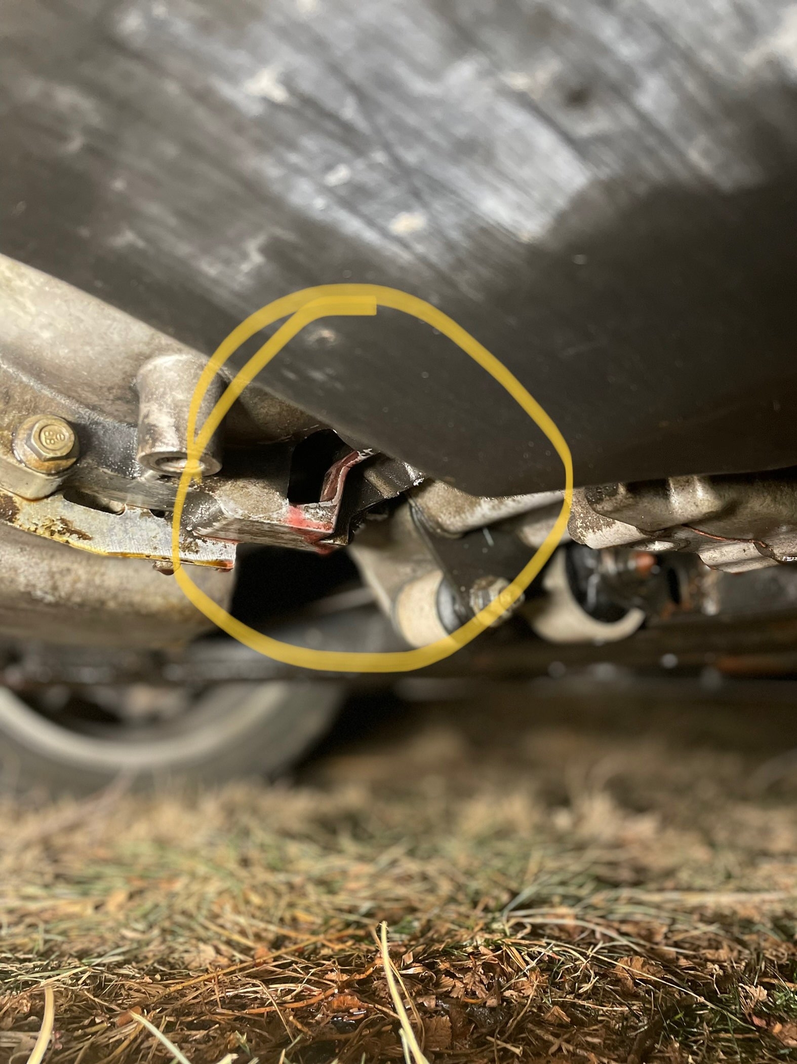

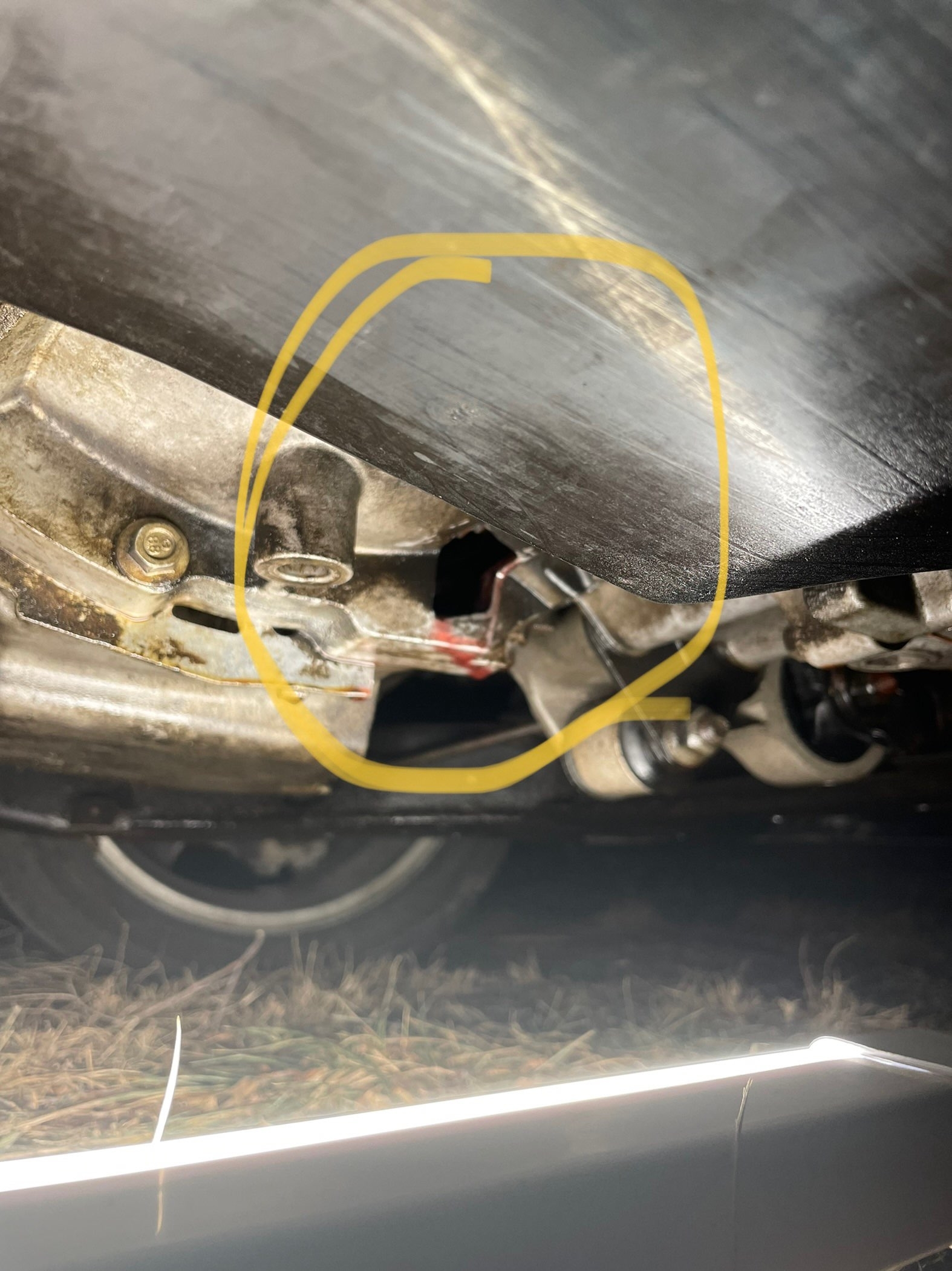

This is where it's coming from which is the access port to the torque converter. Before when it wouldn't shift all I needed to do is fill the Transmission fluid back up and it would drive fine. Well, today I filled it and put it in drive, and it won't move an inch forward.

It almost appears a piece is missing on the housing, which is allowing all the fluid to come out. Do you know if the car ran over something or hit a rock of some kind?
Keep in mind that if there is little or no fluid the transmission will not shift. As it will not have any fluid pressure to do so.

Okay, I understand that there is the rubber plug missing that covers that hole, but my question is When removing a transmission at the point of needed to access the torque converter bolts in the bellhousing "There should be no fluid coming from where you access each nut, correct?" So how many quarts does it take from completely empty in order for it to register and go into gear? Which seal could it be if it was coming from that hole?

That is correct, removing a cover from access hole will not make it leak fluid.
The leak could be from the torque converter seal or the converter itself can leak as well.

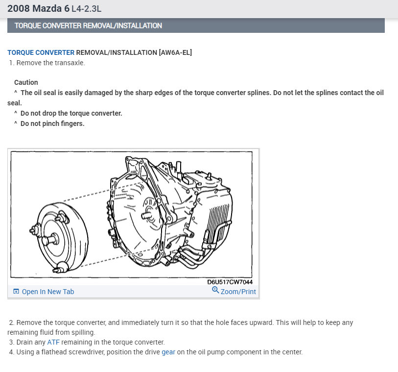

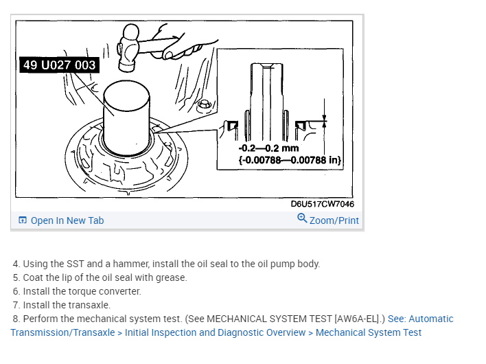

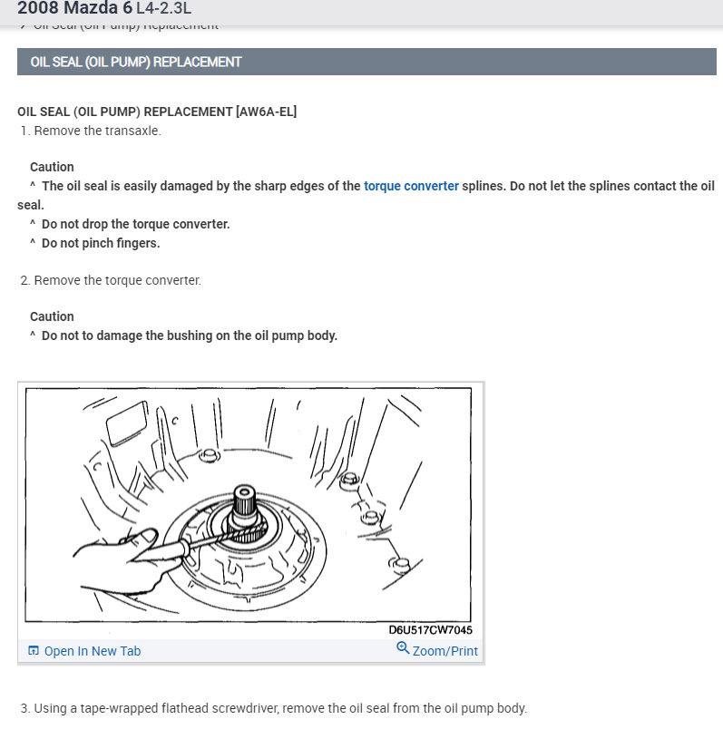

Could you send me a link for replacing the seal? Please and thank you.
Jan 10, 2022 at 4:09 PM
SQM
  • 6,383 POSTS

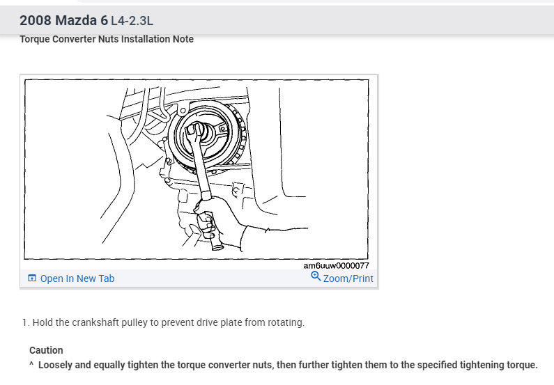

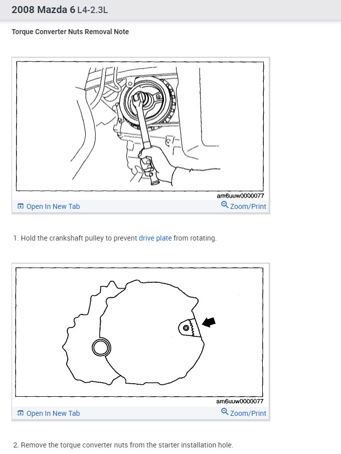

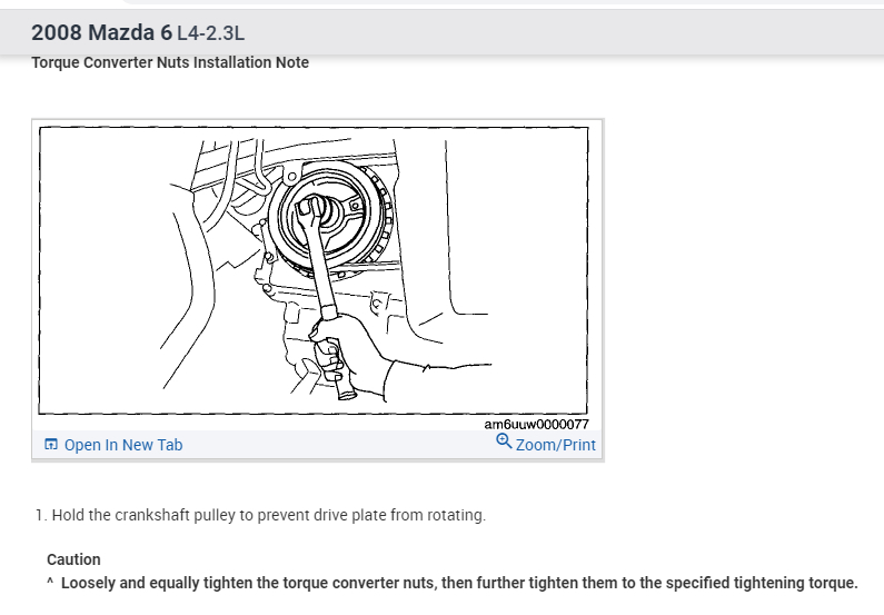

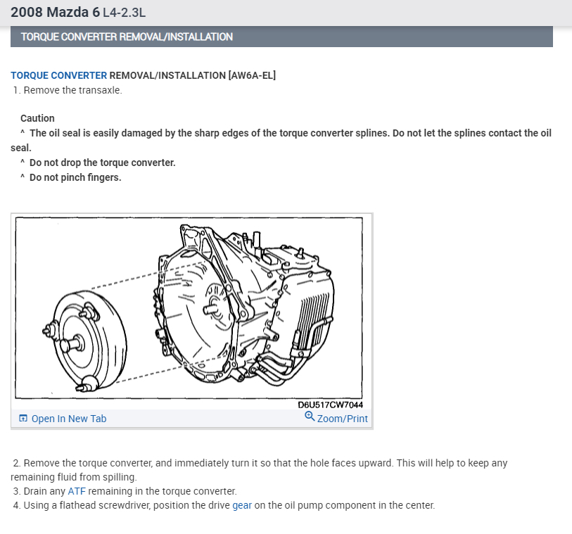

Replacing the seal will require removal of the converter, to do that you will have to remove the transmission.
Look below for the seal replacement instructions.
If you need the transmission removal info just let me know.
Jan 11, 2022 at 4:11 AM

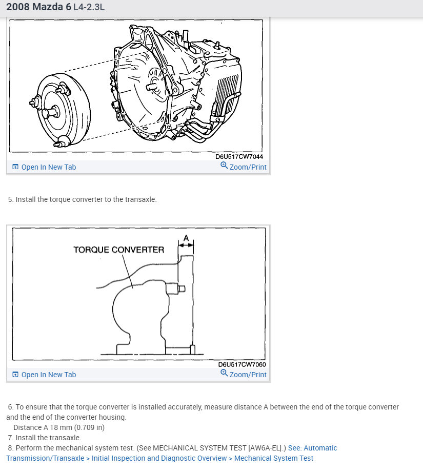

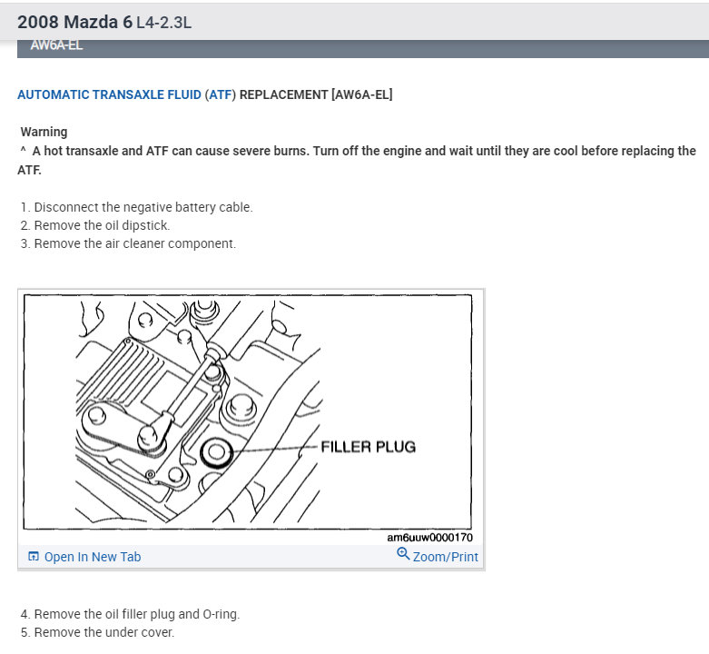

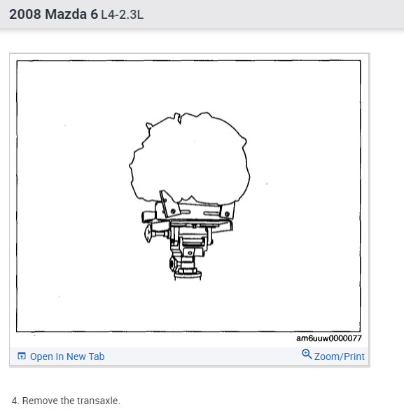

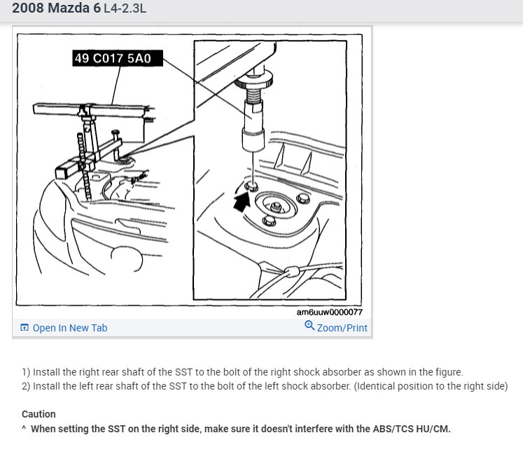

Jan 12, 2022 at 2:18 AM
SQM
  • 6,383 POSTS

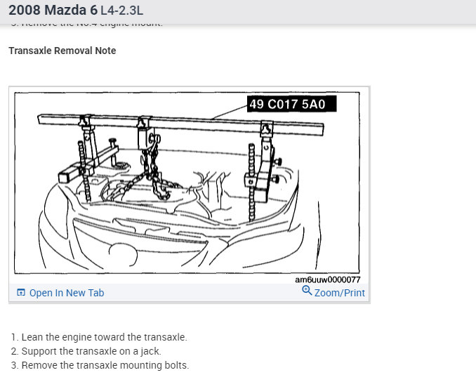

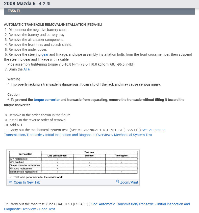

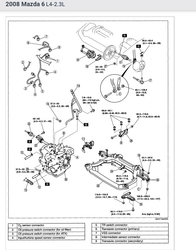

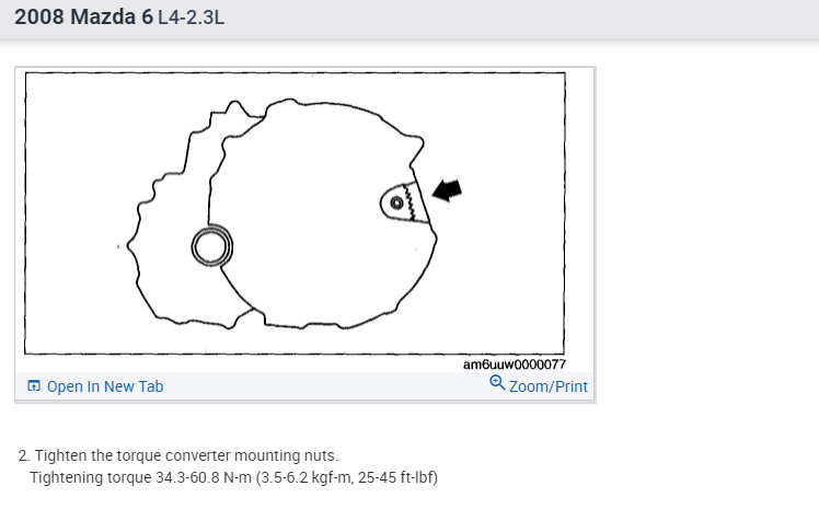

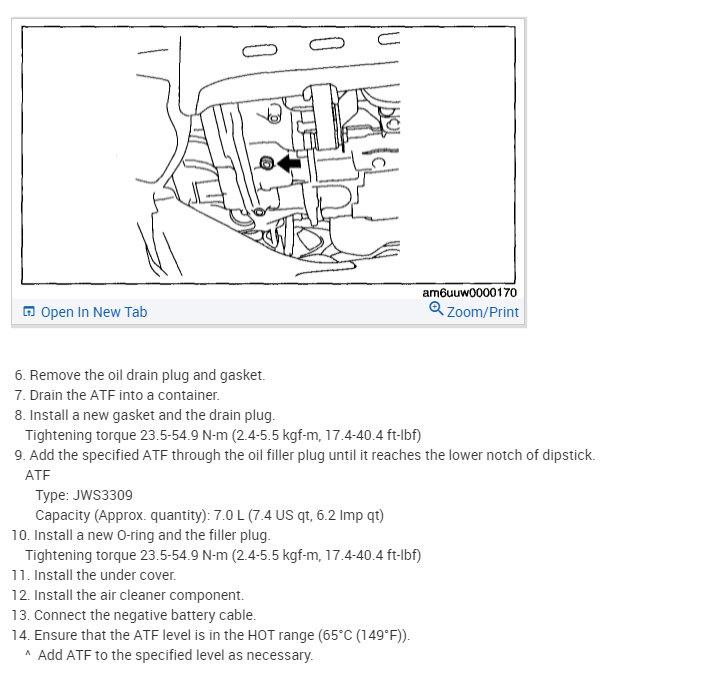

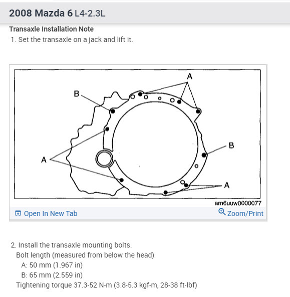

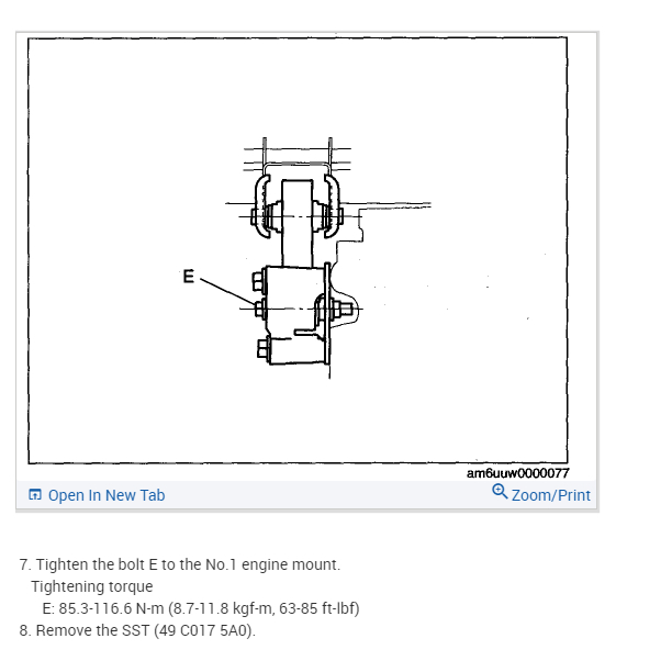

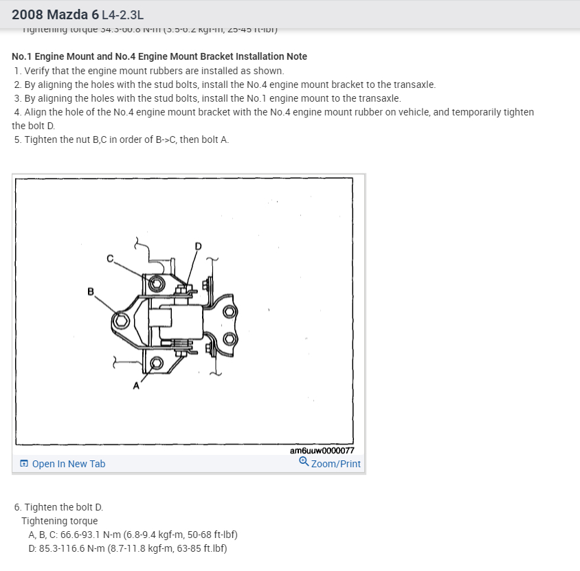

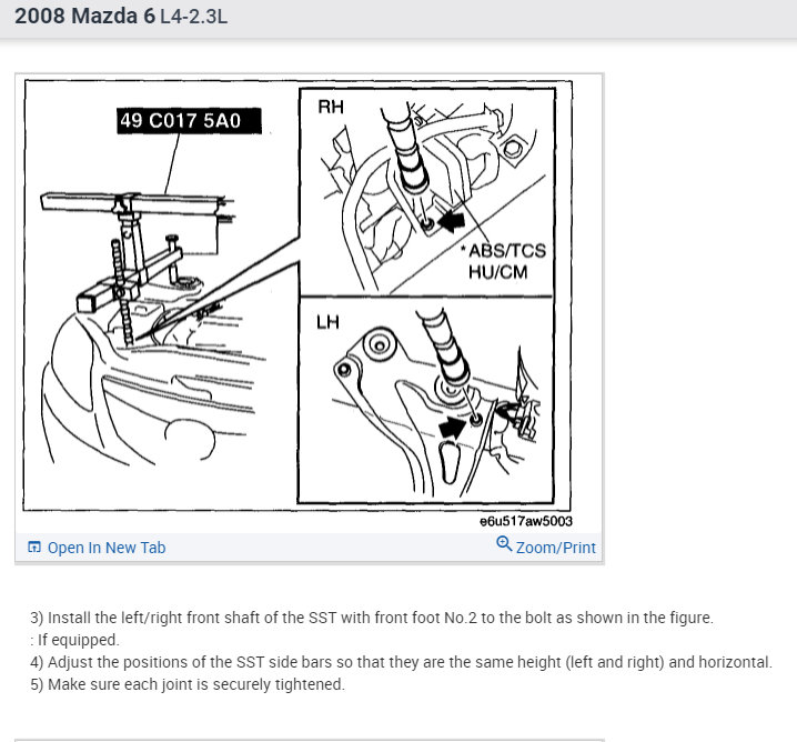

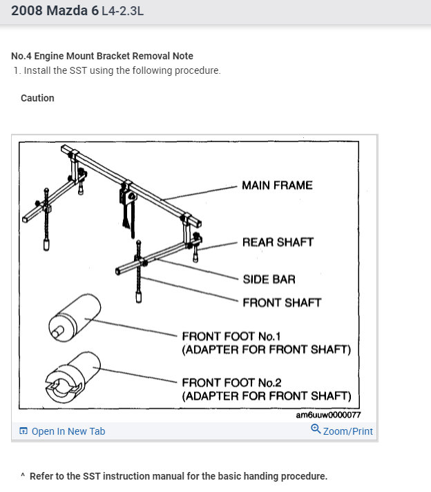

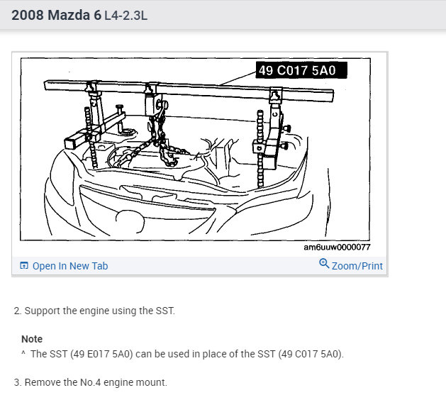

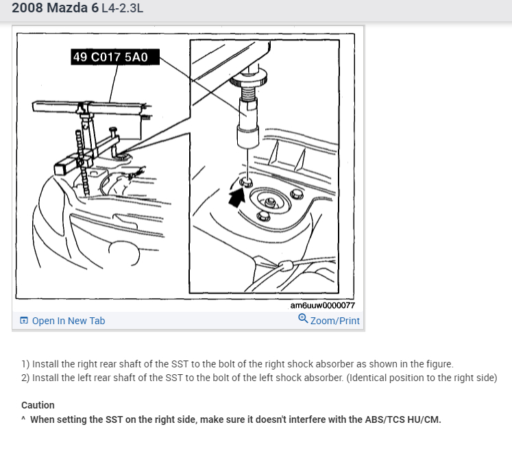

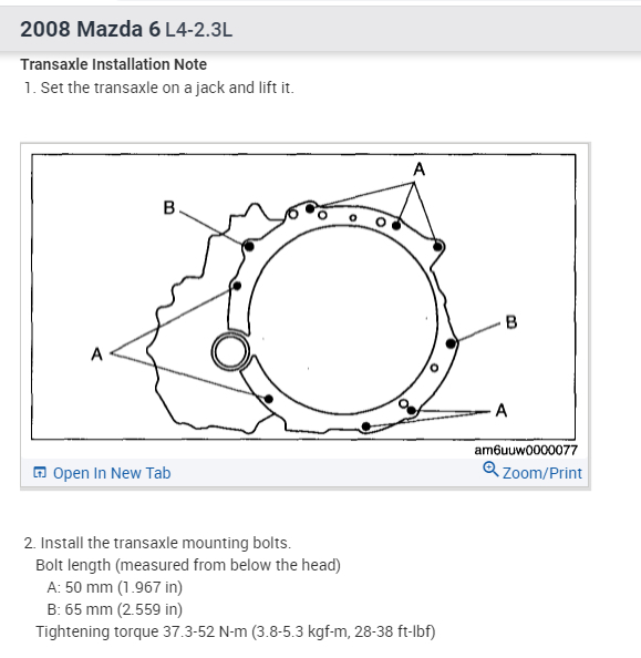

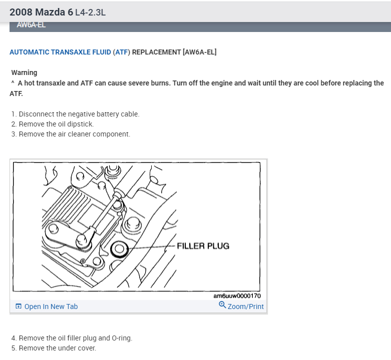

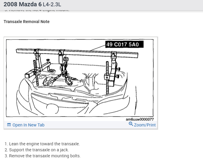

I have attached the transmission replacement procedure below.
Any questions, feel free to let me know.
