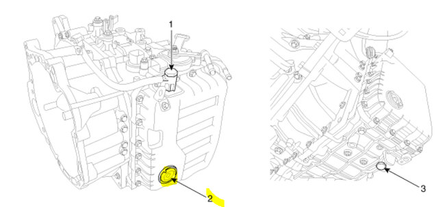

Have you checked the transmission fluid level and condition? That is where I recommend starting. If it is low or excessively dirty, it may have a delayed shift the first thing in the morning.
Here is a link that explains how to check:
https://www.2carpros.com/articles/how-to-check-and-add-transmission-fluid
If you look below, I attached a picture and highlighted the level check location on this vehicle. Note that this should be checked with the vehicle on a level surface, the engine at operating temperature, the engine needs to be running when checked, and the vehicle in park. Make sure to fully apply the parking brake.
Let me know what you find or if you have other questions,
take care,
joe
See pic below.

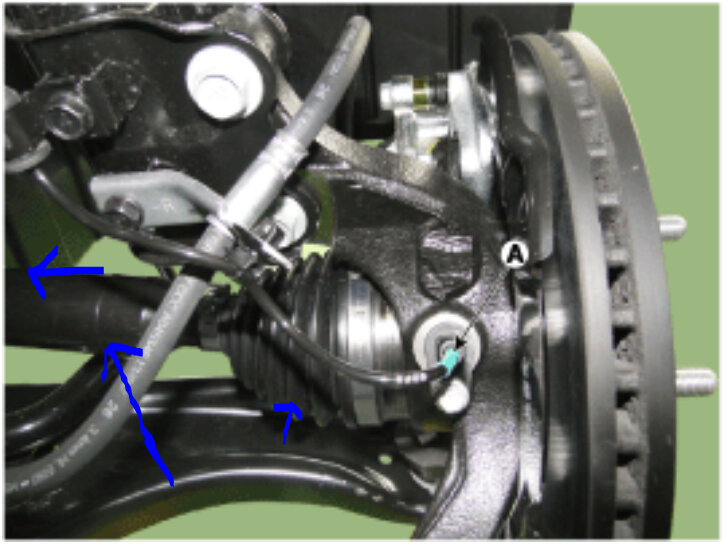

That is possible. If you have someone (carefully) from a park position back out of the driveway while you watch the CV axles, do you see any movement?
If you have the vehicle parked, brake on, engine off, and in neutral, can you feel excessive play in the CV joints? If you grab the steel axle, watch to see if there is excessive play in either the inner or outer CV joint. See pic below.
It's funny but I had this same year and model in the shop two weeks ago, everything was good until you turned the steering wheel. Then, the right front wheel would start locking up. When I lifted the vehicle, I noticed the axle was touching the lower control arm.
Long story short, the customer had a hub bearing replaced. When it was done, they allowed the inner CV joint to internally come apart (let the axle hang). When it went together, it worked until turning. The joint was locking up on the inside. Anyway, that wasn't something I expected, so anything is possible. You should have seen the tire. Ugh! LOL
See pic below.
Mar 2, 2024 at 3:33 AM
