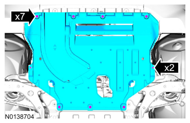

Engine Front Undershield
pic 1

1. Refer to: Jacking and Lifting - Overview. See: Vehicle Lifting > Procedures
Refer to: Engine Front Undershield (above).

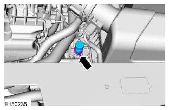

2. Start the engine and slowly select each gear position, stopping in each position and allowing the transmission to engage.
pic 2

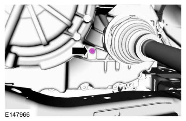

3. With the engine running in PARK on a level hoist make sure the transmission is at normal operating temperature 85-93 C (185-200 F). Check if the transmission fluid is even with the oil leveling plug hole.
pic 3

6.
