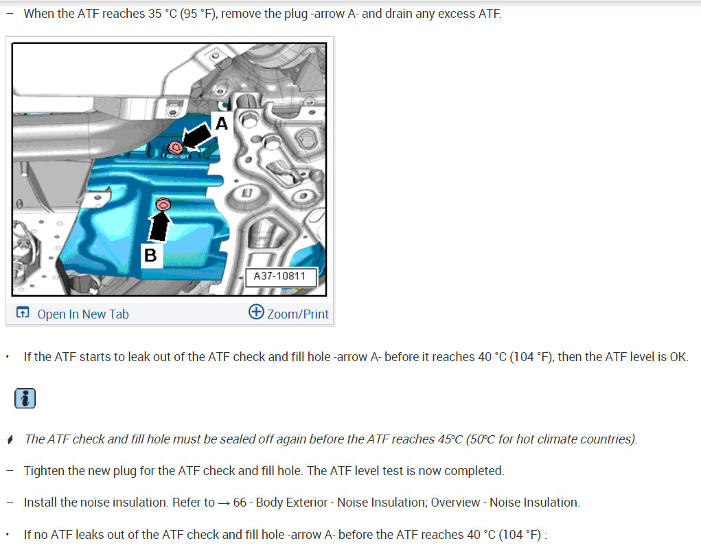

Yes, thanks for asking, so what happens is the transmission fluid breaks down and will not allow the clutches inside the transmission to release. I would scan the car for codes in case any are stored which can help us see what the problem is, this guide can help:

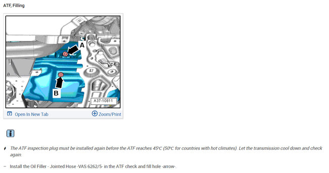

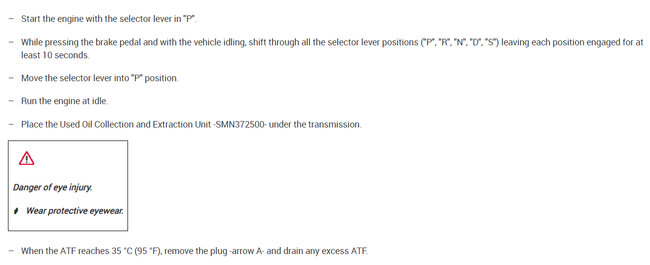

If no codes are present here is how to change the transmission fluid out so you can see what needs to be done.

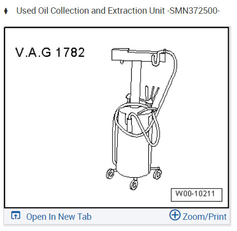

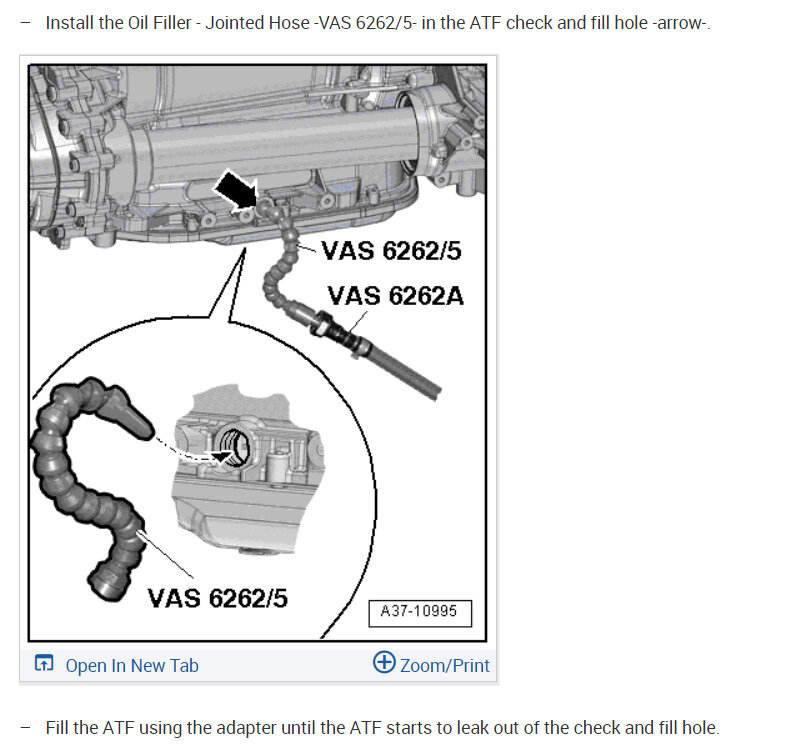

Fill the ATF using the adapter until the ATF starts to leak out of the check and fill hole. So, this transmission has a fill hole on the side like the old standard transmission did. It is are many steps to remove the fluid pan so I would rig a suction device and tube to stick into the fill hole and drain as much as you can and refill with new fluid, if the transmission does better you might what to have a flush done by someone that has the flush machine.
For Automatic Transmission (S tronic / DSG)
Type: Audi recommends using Genuine Audi DSG Transmission Fluid.
Part Number: G 052 182 A2
Capacity: Approximately 7 liters for a complete change but check the vehicle's manual for the exact amount needed.

Hey Ken, appreciate the quick reply. I have fully drained the transmission fluid already when I replaced the DSG mechatronics unit. The car does not have any codes, so it makes it much harder to determine.

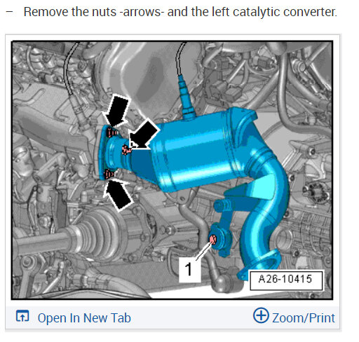

Yep, you got all new sensors and shift solenoids then, the only other thing I can think of as the car gets hot the catalytic converter can become partially clogged up which will low the vacuum of the engine which the PCM will take as you are going up a hill, even coming to a stop. There will be no codes in this case as well. How is the engine power output normal? If not let's use this guide to check the cat flow and performance:
If one of the catalytic converters has fallen apart. It will cause low vacuum. Check out the images (below). Please let us know what happens.

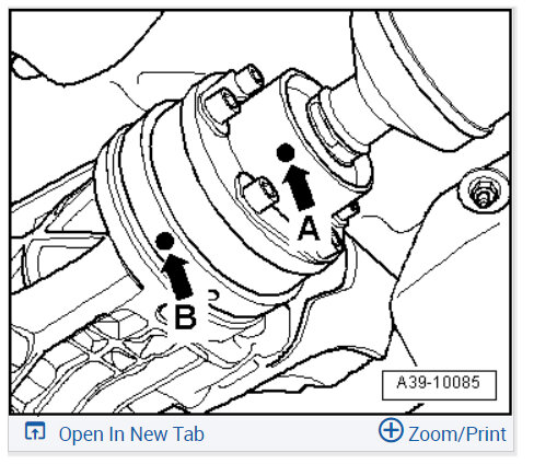

Also, to reiterate, those videos were taken after driving the car for approximately 20-30 minutes. The longer you drive the more violent those shakes and noises get. The car drives and shifts normally until it’s been driven for about that time and slowly gets worse and worse but when it’s cool it’s normal.
Aug 21, 2024 at 12:59 PM
  • 55,770 POSTS

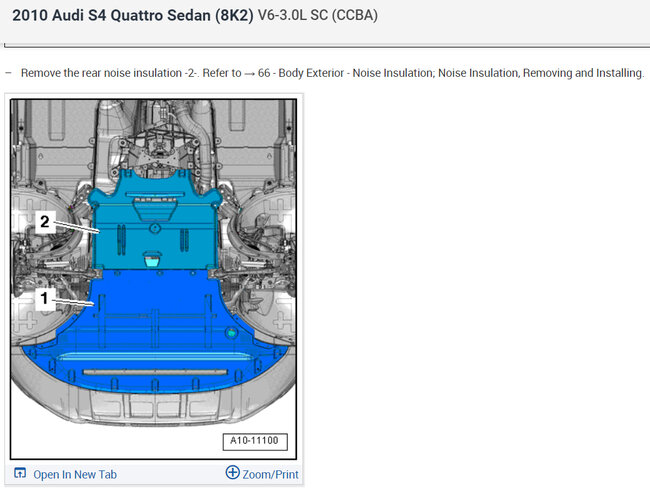

Wow, yep, to me that looks like a driveshaft needs to be replaced or something is loose, the car will need to go on a rack with someone inside to shift the gears like you do to watch from underneath. Here is the area I would look at. Thanks for the videos, they help. Check out the images (below). Let us know what you find.
