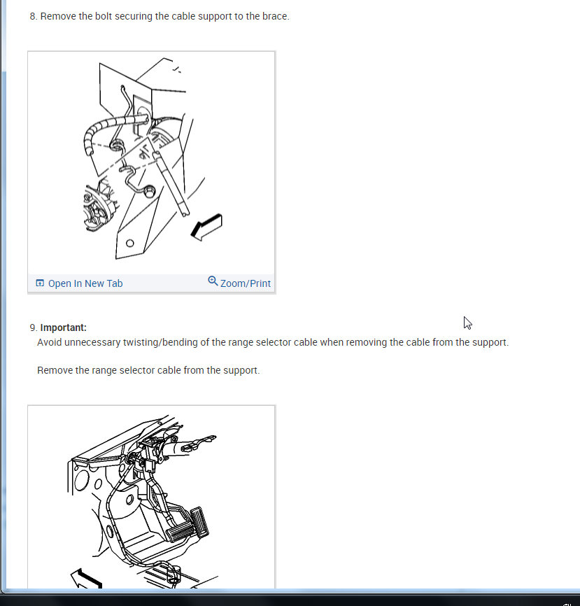

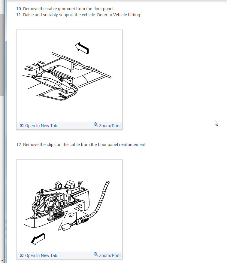

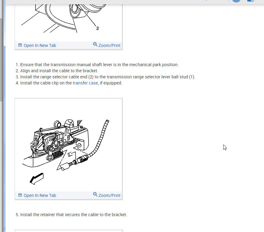

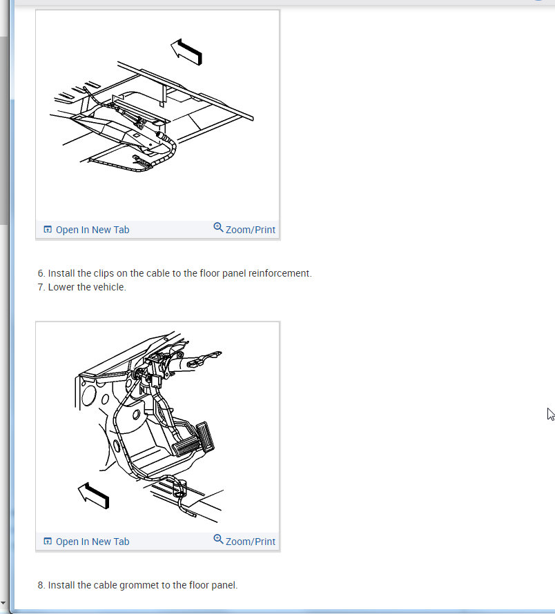

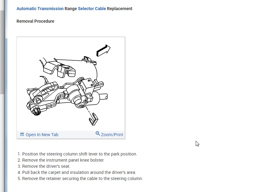

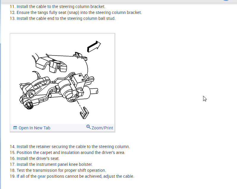

619SHOER

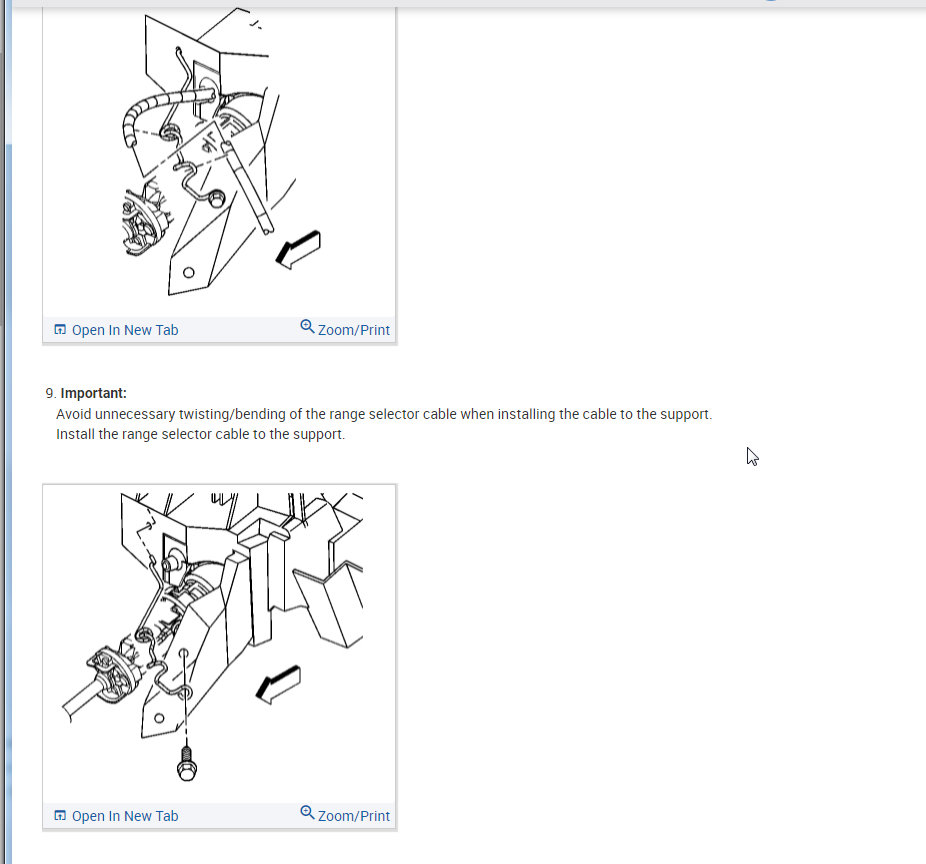

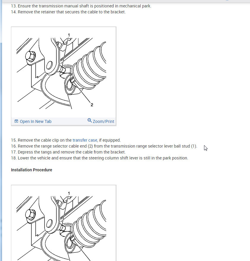

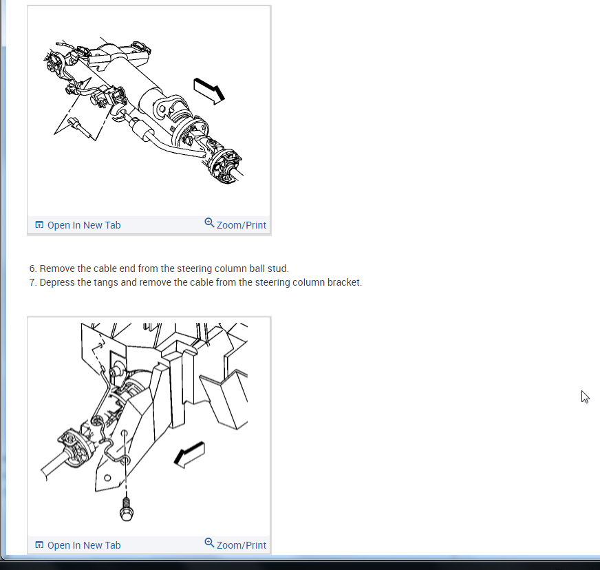

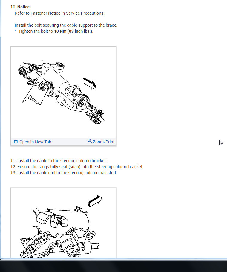

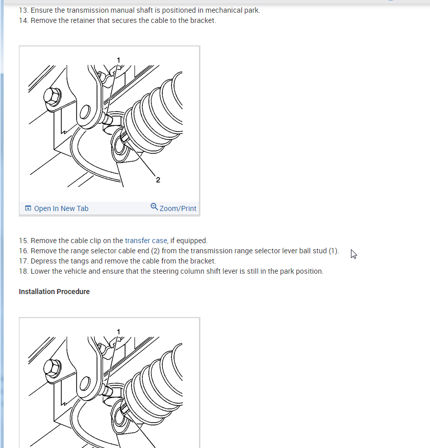

The truck was working fine, I was backing up to a dock, and put it in park to get out and check where I was, got back in the truck and went to put it in rev. and shifter would not move. I jiggled the shifter and pulled down on it. It moved down but feels disconnected now.
May 6, 2021 at 3:41 AM (Merged)
It does sound like the cable has broke or come off so I would suggest we start with replacing it unless you get in there and just find you can reattach it.
Either way you are going to have to open it up and find out what is going on in there.
Let us know what you find but here is the process from the manual that will help with this.
