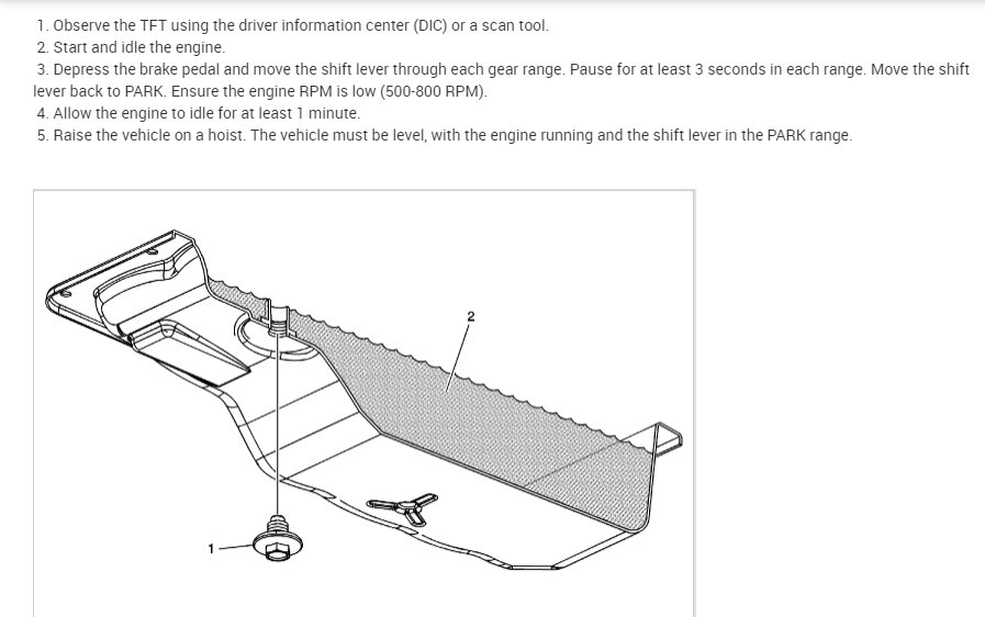

Could you let me know if this is 4WD or not and if it has the 3.6L or the 4.6L engine? I need to know to determine the transmission that is used.
As far as the fluid, you can't see inside the transmission, so it is really based on how bad the fluid looks. If it is very dirty, then it would be worthwhile checking.

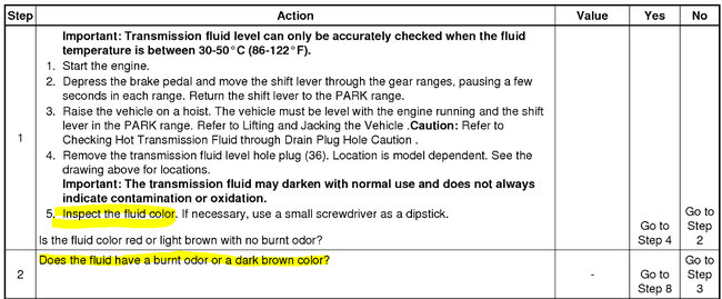

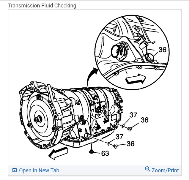

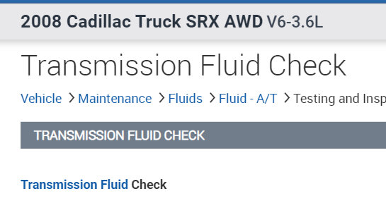

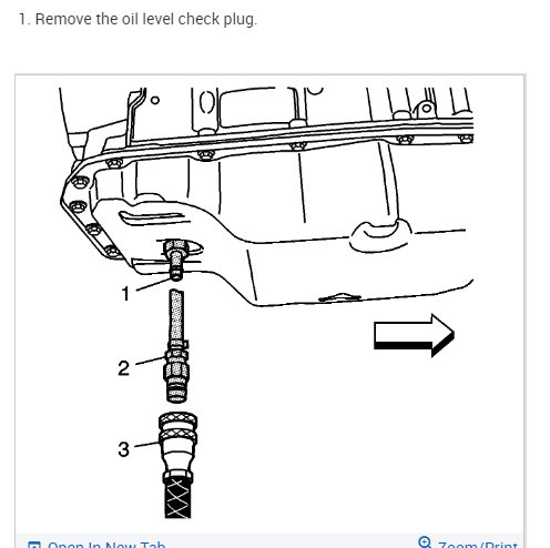

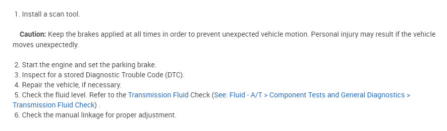

Okay, I attached the directions below for checking fluid level and condition. Take a look through the directions and let me know what you find.
Sep 18, 2023 at 1:24 PM

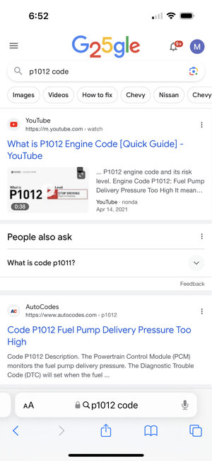

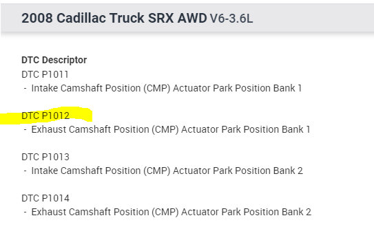

I finally received the scanner you recommended. After updating the OS on it, I found no transmission codes and only one engine code, P1012, high fuel pressure. I’m going to assess the transmission fluid tomorrow. I had to get a T45 socket, mine came up missing. Will update you tomorrow.

The code you have is related to a camshaft position sensor. See pic below. Where did you find the high fuel pressure definition? I'm curious because my manual has been wrong in the past.
As far as the transmission is concerned, let me know what you find when you get a good look at the fluid condition and condition.

I just goggled the code, p1012, all the results came back as high fuel pressure. I didn’t search it vehicle specific.
Sep 26, 2023 at 8:52 PM
GSXR11001990
  • 24 POSTS
Here’s a sample.
Sep 26, 2023 at 8:53 PM

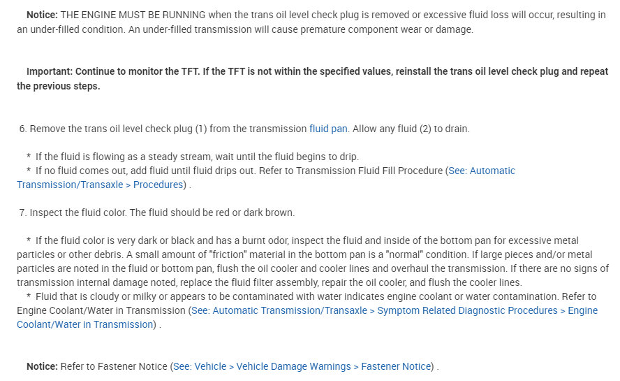

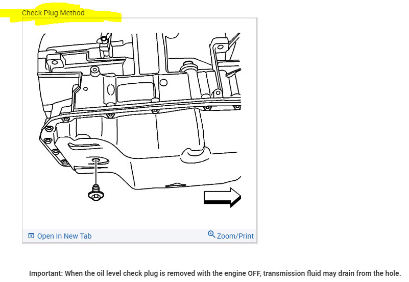

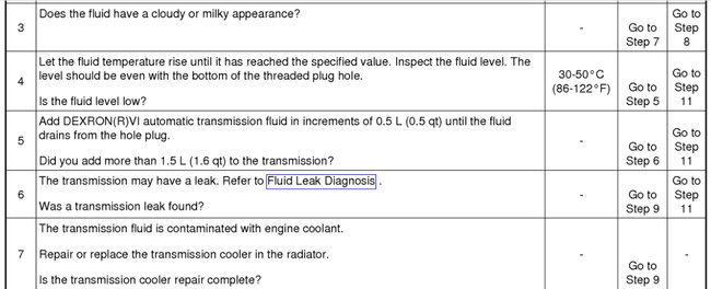

I checked the fluid this AM. I didn’t do it precisely as the instructions said to, that was my error. Instead of getting the vehicle up to operating temperature before opening the drain plug, I opened it before I started the engine. I’d say about a pint or two of fluid promptly drained out. At any rate, I followed the rest of the directions perfectly. Vehicle to operating temperature, moved gear shifter through the range of selections, pausing on each one for a bit. I checked the level with a screwdriver. Fluid was just below the drain hole. No more fluid leaked out after initial opening, even after turning off the motor and during cool down. Transmission fluid looked normal. Red, slightly brownish, didn’t smell burnt and wasn’t foamy. My only questions are what’s next and is it normal to have that much fluid come pouring out, even when the engine was cold?
Sep 27, 2023 at 12:34 AM
  • 110,248 POSTS

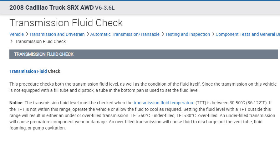

The reasoning behind having the fluid at operating temperature is that it expands when it gets hot. Now, if you shut the engine with the plug removed, the fluid should have come out. If none did, it's low. You should actually have a trickle coming out while the engine is running, and the system is warmed up.
Let me know if no fluid came out when the engine was off. Also, was the vehicle on a level surface?
Sep 27, 2023 at 12:05 PM
GSXR11001990
  • 24 POSTS
Like I said previously, nothing came out while running. nothing came out after I turned it off for at least 15-20 minutes. I checked fluid level with a screwdriver both while running and 20 min after shutdown. The level didn’t appear to change. Both times it appeared to be full and level with the drain plug hole. The only time I lost fluid was when I first opened the drain plug, engine and transmission cold, I lost at least a pint maybe two. Vehicle was level the entire time.
Sep 27, 2023 at 8:59 PM
  • 110,248 POSTS

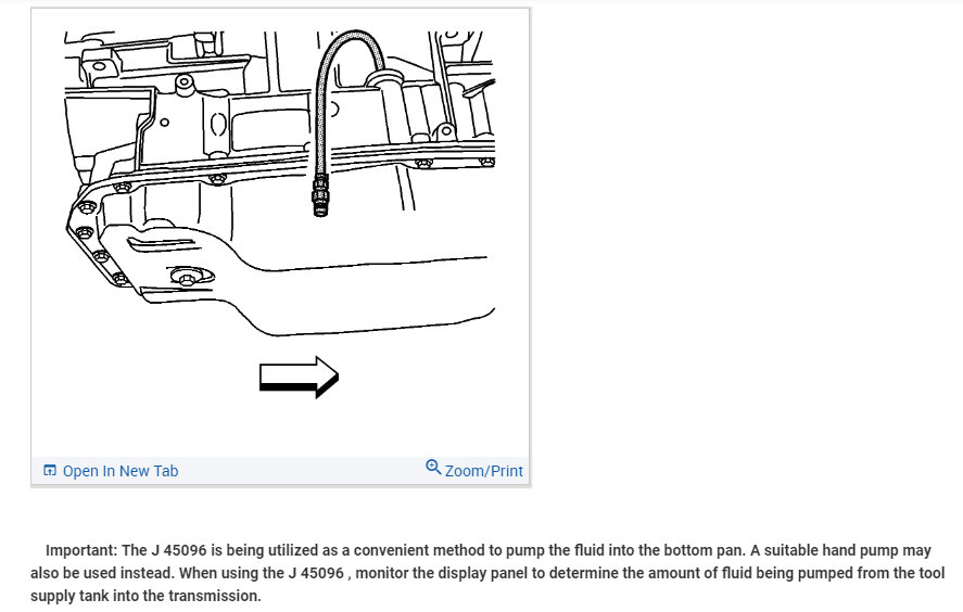

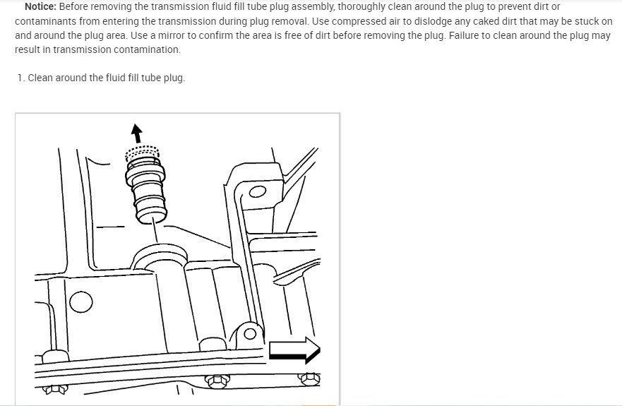

Okay, if that is the case, you need to add fluid to it until it begins to trickle out. As before, this needs to be done with the engine running and both at operating temperature.
Sep 28, 2023 at 1:04 PM
GSXR11001990
  • 24 POSTS

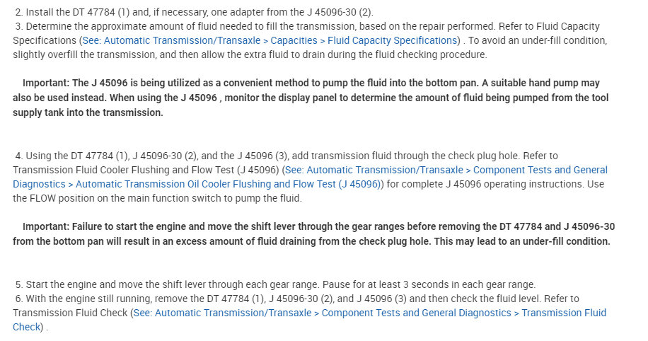

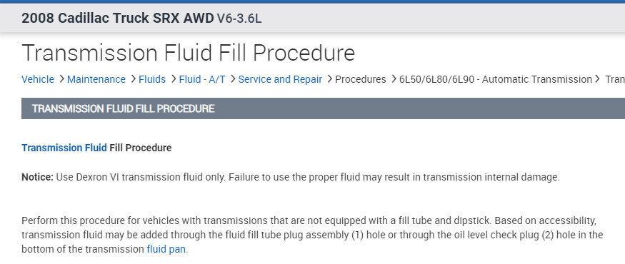

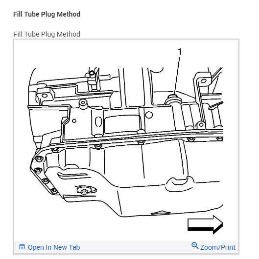

Okay, what is the procedure for filling the transmission? Is there a spot to add transmission fluid or do you add at the same hole as you drain from?
Sep 28, 2023 at 9:02 PM
  • 110,248 POSTS

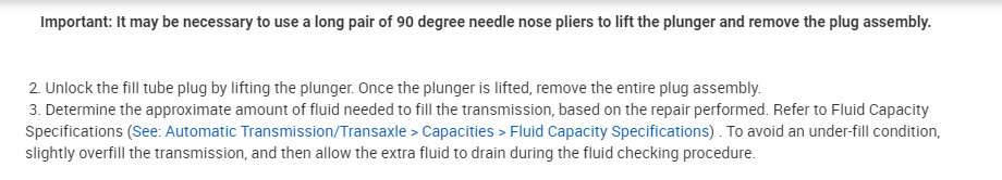

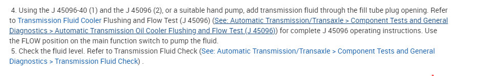

There is a fill tube at the top of the transmission, or you can fill it through the check plug.
I attached the directions below. The last pics are the directions for checking the fluid level. Let me know if this helps.
Sep 29, 2023 at 2:56 PM

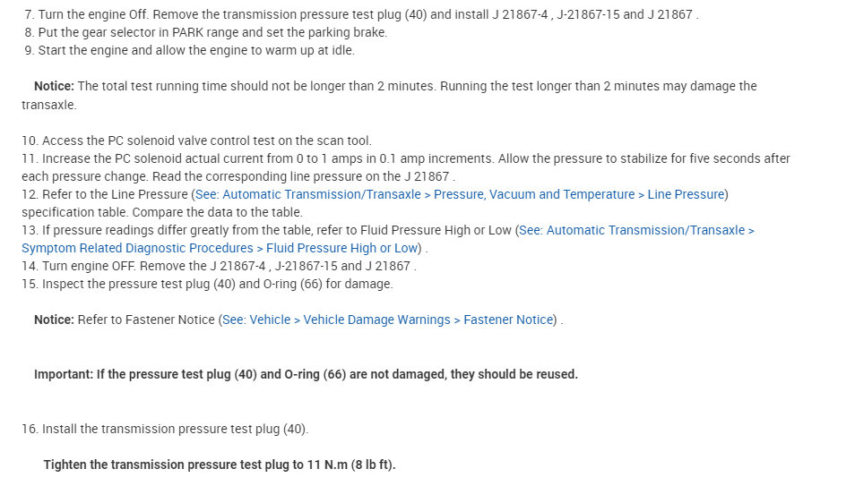

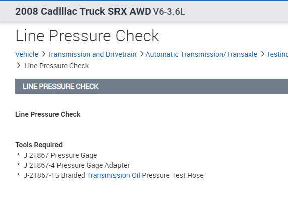

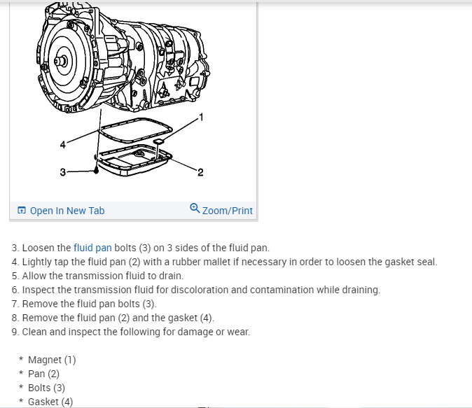

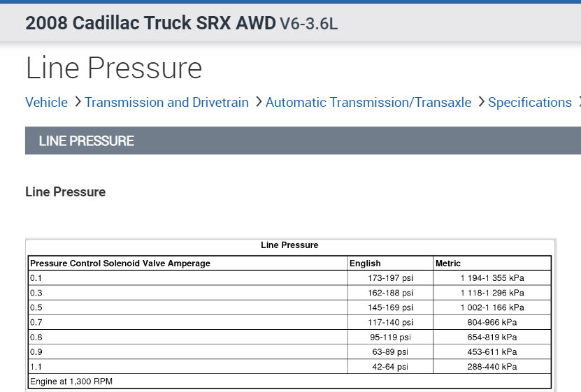

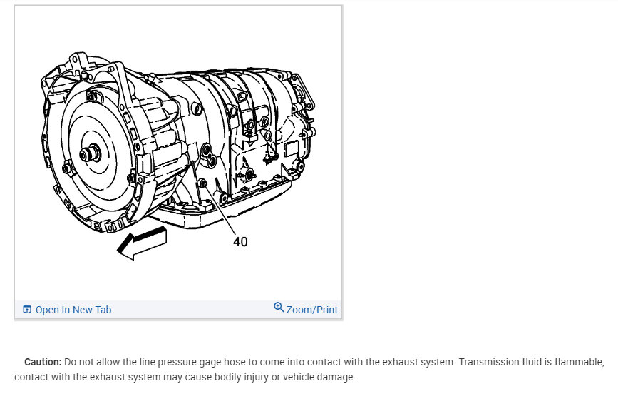

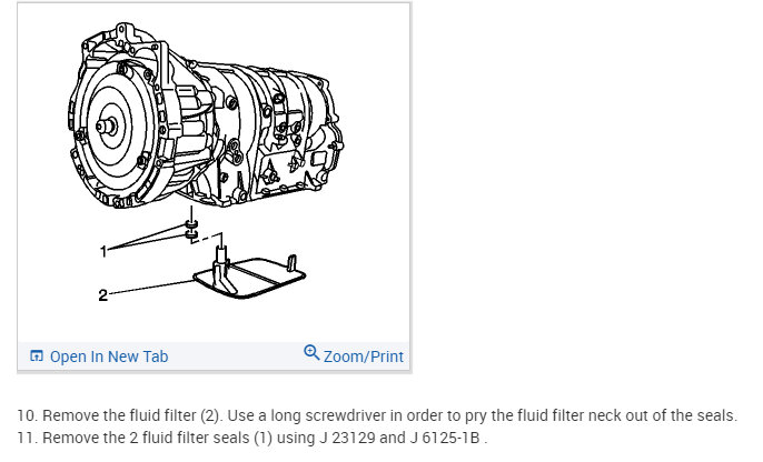

Did you ever remove the pan to inspect the filter for dirt or obstruction? If you have and it was okay, then we need to check the line pressure to see if it is within the manufacturer's specifications.
I attached the procedure below. Let me know if it is something you are comfortable performing.
If we find this is low, it may be the pressure control solenoid valve sticking or damaged.

It’s not that I’m not comfortable doing this, I don’t have the tools required. The scanner you advised I buy doesn’t have the capability to perform that test. The other tools I need cost a lot of money even if I go the cheapest route. They are also not available to rent at any parts store in town. I even tried to consult a bunch of mobile mechanics who could come out to perform that test and none of them could or will.
It would be cheaper to just replace the solenoid myself and see if that fixes the problem. At this point, it’s either that or just tow it to a transmission shop, which I’m trying to avoid.
Also, I never pulled the pan to check the filter. I assumed since the fluid didn’t look particularly dirty or smell burnt, it was unnecessary. What’s your opinion/advice?

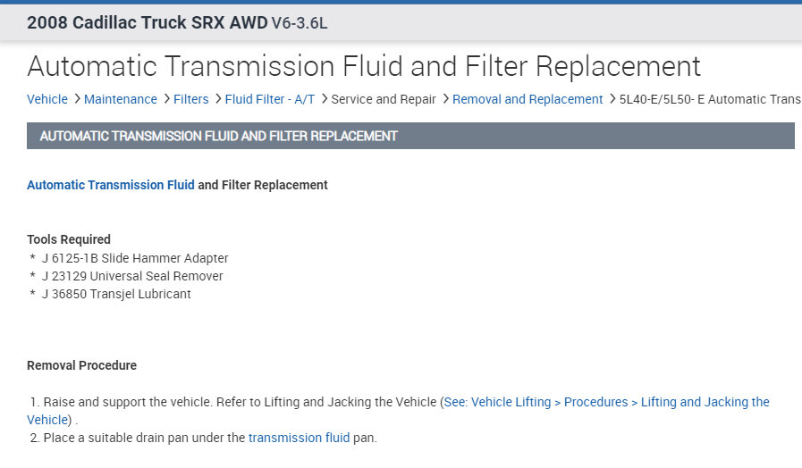

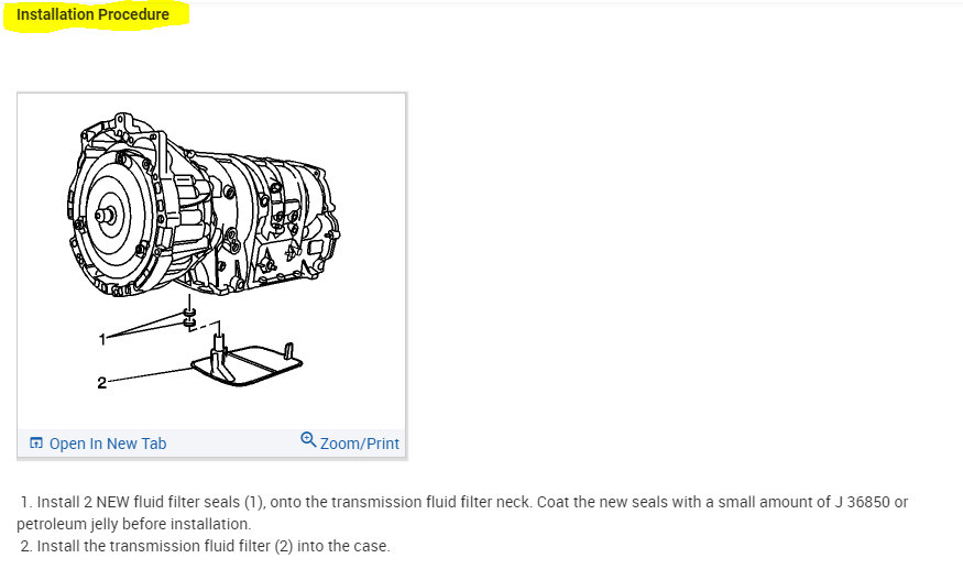

As far as replacing the part, I'm not a fan of doing so without clarification, but that one is your call. I just don't want to see you spend money and not be any further.
As far as the filter/pan, I attached the directions below. When you do this, there is a rubber O-ring at the top of the filter, where it attaches to the valve body. Make sure that it is removed and a new one is fully installed before installing the new filter. Lubricate it with trans fluid to make it a little easier.

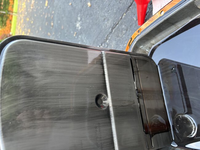

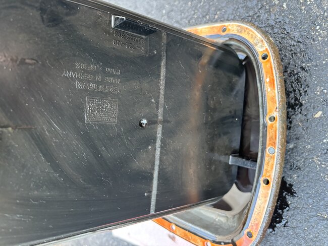

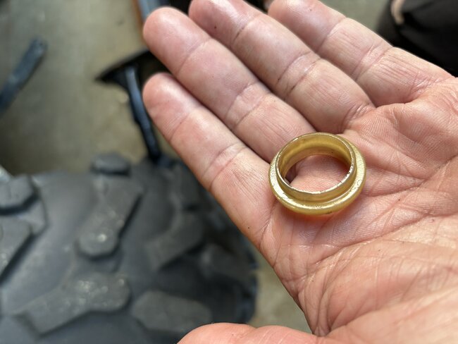

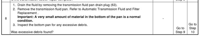

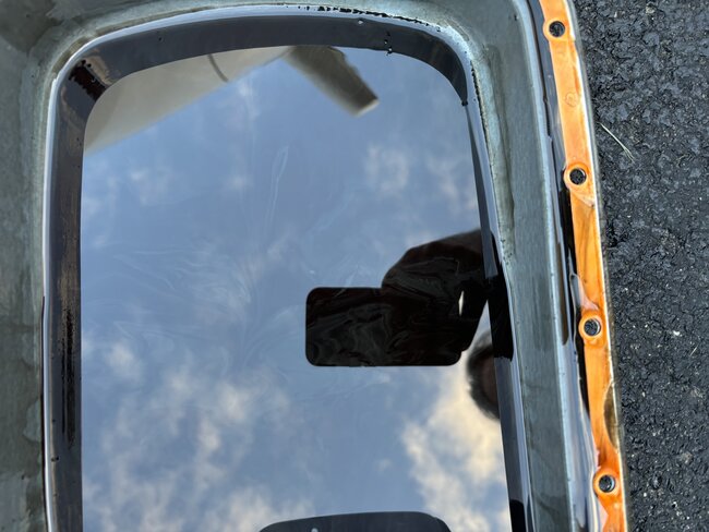

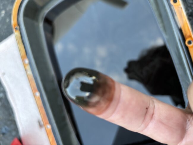

Okay, I removed the transmission pan and filter. I will enclose pics of what I found. My questions are as follows. Is any of this normal? There is a layer of trans fluid/black sludge at the bottom of the pan. What’s the best method to clean it up? Solvent? Brake cleaner? Carb cleaner? The filter itself is supposed to be black plastic on one side and silver metal on the other. Is it normal for the silver side to be black with sludge? The filter itself appears black, is the normal color supposed to be white when new? Lastly, one of the enclosed pics is of a white round plastic ring which was on the neck of the filter that attaches to the transmission. Is this the o-ring? I was expecting something rubber for an o-ring, but found nothing on the filter or left behind on the transmission resembling an o-ring. Thanks in advance. I already plan on replacing the filter and trans fluid that came out during removal. Please advise.
Oct 20, 2023 at 8:38 AM
GSXR11001990
  • 24 POSTS
Here’s the pics. Another thing, do you know the torque for the pan bolts when I reinstall?
Oct 20, 2023 at 8:41 AM
  • 110,248 POSTS
That is all dirt from clutch plates and old transmission fluid. When I clean these, I first wipe it out with a shop rag and then use brake cleaner.
Next, yes that is the o-ring. When I replace them, first make sure where it is positioned in the transmission is clean. Next, I lubricate it with transmission fluid and install it fully in the transmission first. Then, I lubricate the filter (where it goes into the o-ring) and with the palm of my hand, I bump it into place. Make sure it is fully seated.
Also, you asked about the sludge on the filter. No, that shouldn't be there. The fluid is very dirty and there is a chance what I originally mentioned (the filter plugging) could be the problem. I just hope there isn't too much damage to the clutch plates.
Let me know how things work out for you or if you have questions.

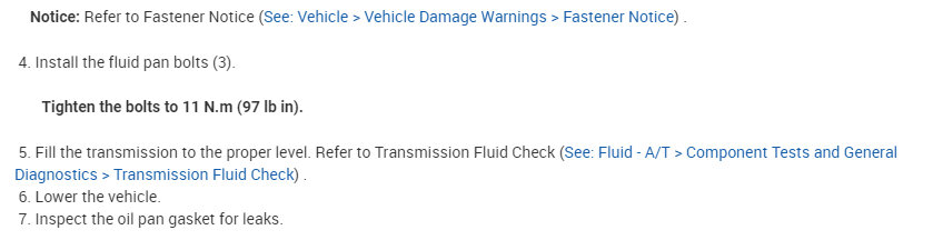

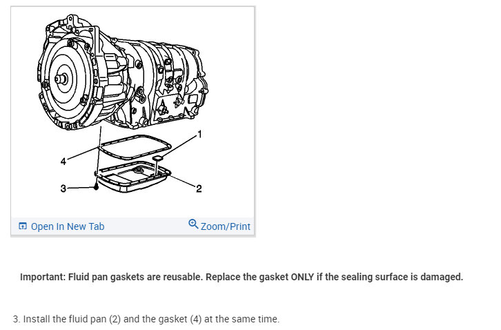

Okay, you may have missed this question. Do you happen to know the torque for the pan bolts?
Oct 20, 2023 at 9:33 PM
  • 110,248 POSTS
They were in the directions above. Tighten them to 8 foot/lbs or 97 inch/lbs which is the same torque.
Let me know how things work out.
See pic below.
