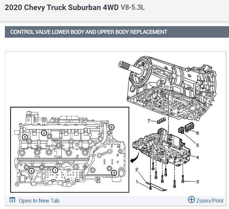

Original Transmission failed; suburban would not drive at all. had a dealer replace it with a remanufactured one, which I supplied. Within 10 to 20 miles of driving with the new transmission it started acting strange, erratic RPM spikes and harsh shifting at low speeds. took it back to the dealer, they claim it's the valve body, $$$. My original invoice shows only 5 quarts of fluid, i can only assume they did not flush the entire system before installing the new transmission. Otherwise, it would be 11 or so quarts. Question, would this lead to the new transmission acting this way? thanks

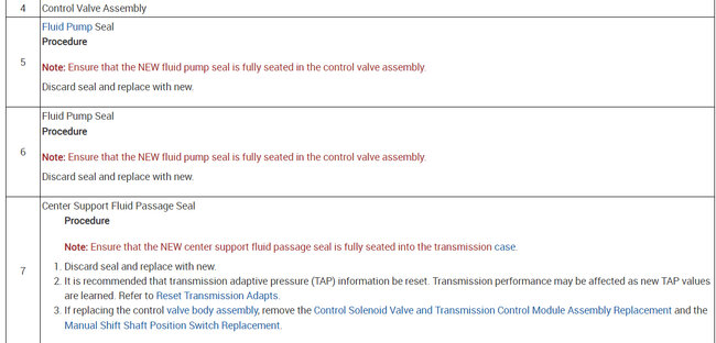

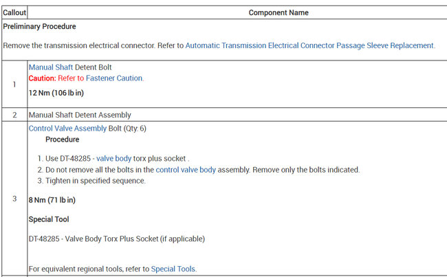

You are correct on the fluid volume; it should be about 12 quarts of fluid. Did the dealer give you any codes that they found to determine if the valve body is bad? Here is how to change it out in case this is the problem. Check out the images (below). Please let us know what happens.

This can be because of the switch or the low fluid pressure due to a clog. The location of the switch is inside the valve body, this is probably why they said you need a new one.
