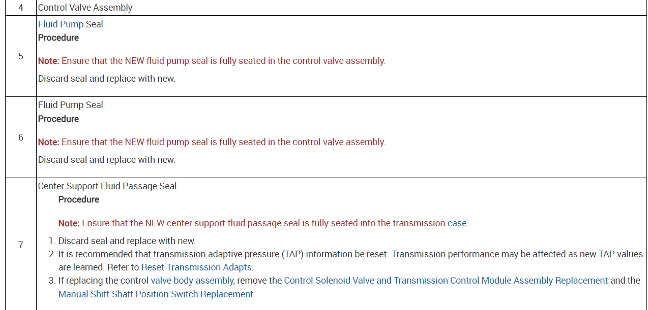

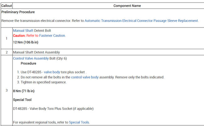

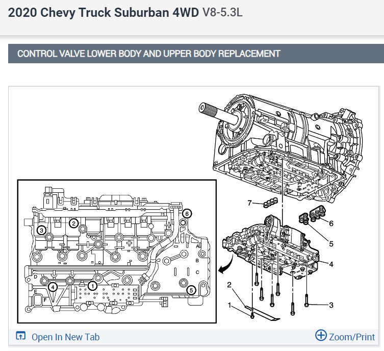

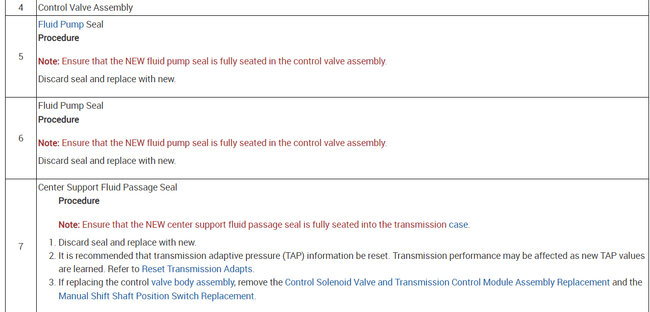

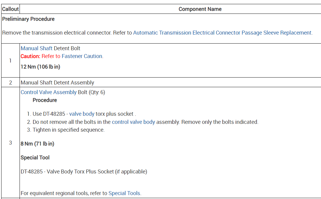

You are correct on the fluid volume; it should be about 12 quarts of fluid. Did the dealer give you any codes that they found to determine if the valve body is bad? Here is how to change it out in case this is the problem. Check out the images (below). Please let us know what happens.
