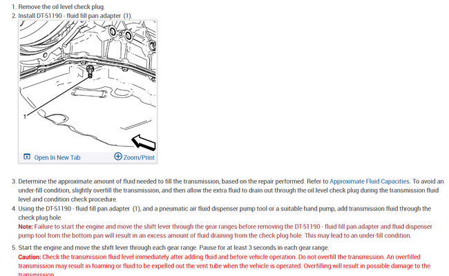

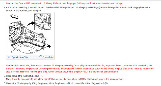

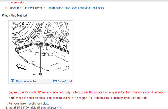

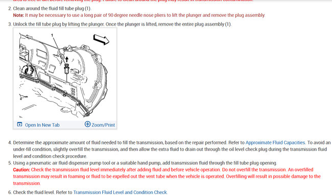

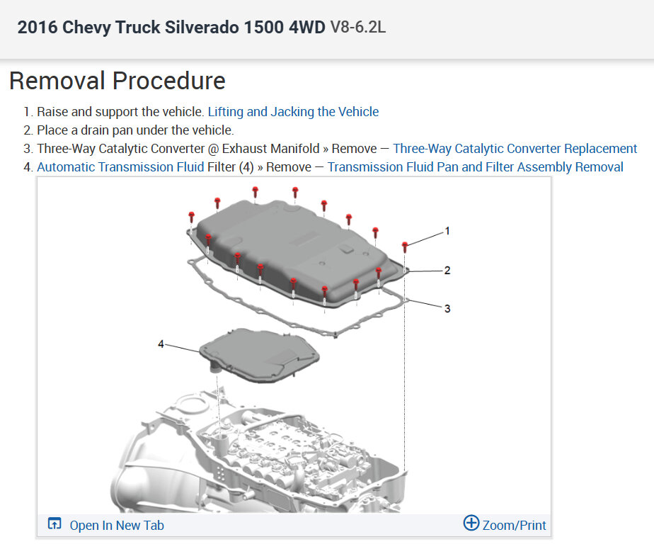

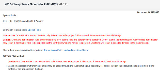

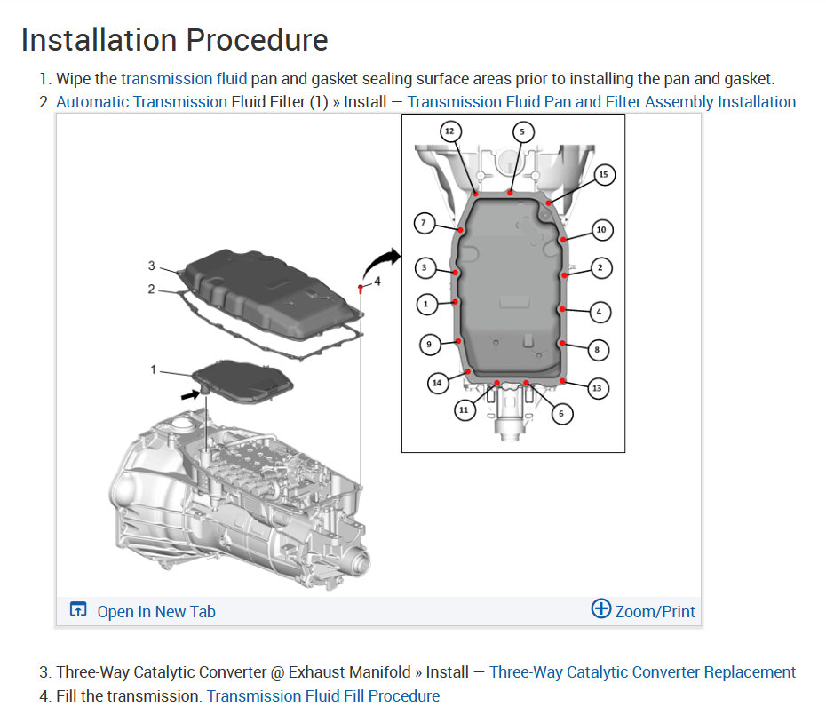

I would start by checking the transmission fluid level and condition and if you have not serviced the transmission, I would give that a try first and then clear the codes.

Already did a transmission flush and installed new filter but still no luck I've noticed it'll go into gears fine but once you put in drive it sounds like it goes into limp mode it just doesn't sound the same and I'm noticing the transmission temp jumps for about 127 to 154 not sure if that's bad but every now and then the d gear on dash will start blinking.
