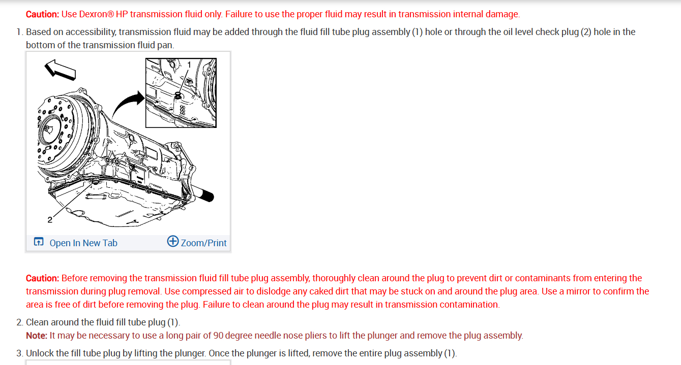

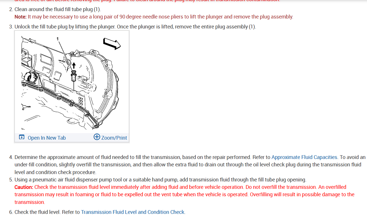

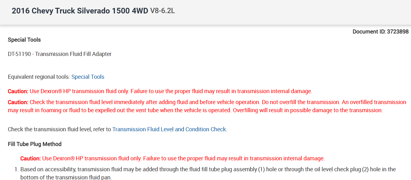

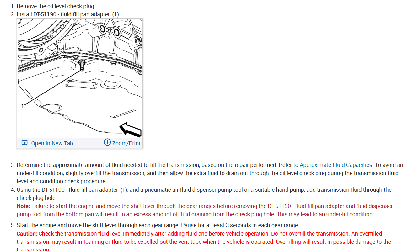

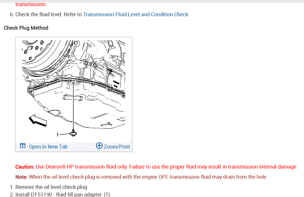

So it looks like you have three problems with the truck. Please start new threads for the 02 sensor and the oil pressure issue. We will work on the P0700 code on this thread.
P0036 - HO2S Heater Control Circuit (Bank 1, Sensor 2)
P0138 - O2 Sensor Circuit High Voltage (Bank 1, Sensor 2)
P0141 - O2 Sensor Heater Circuit (Bank 1, Sensor 2)
P0523 - Engine Oil Pressure Sensor Circuit High Voltage
P0700 - Transmission Control System Malfunction

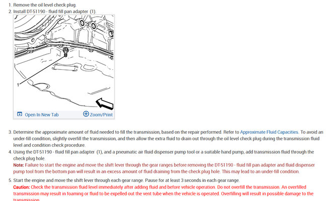

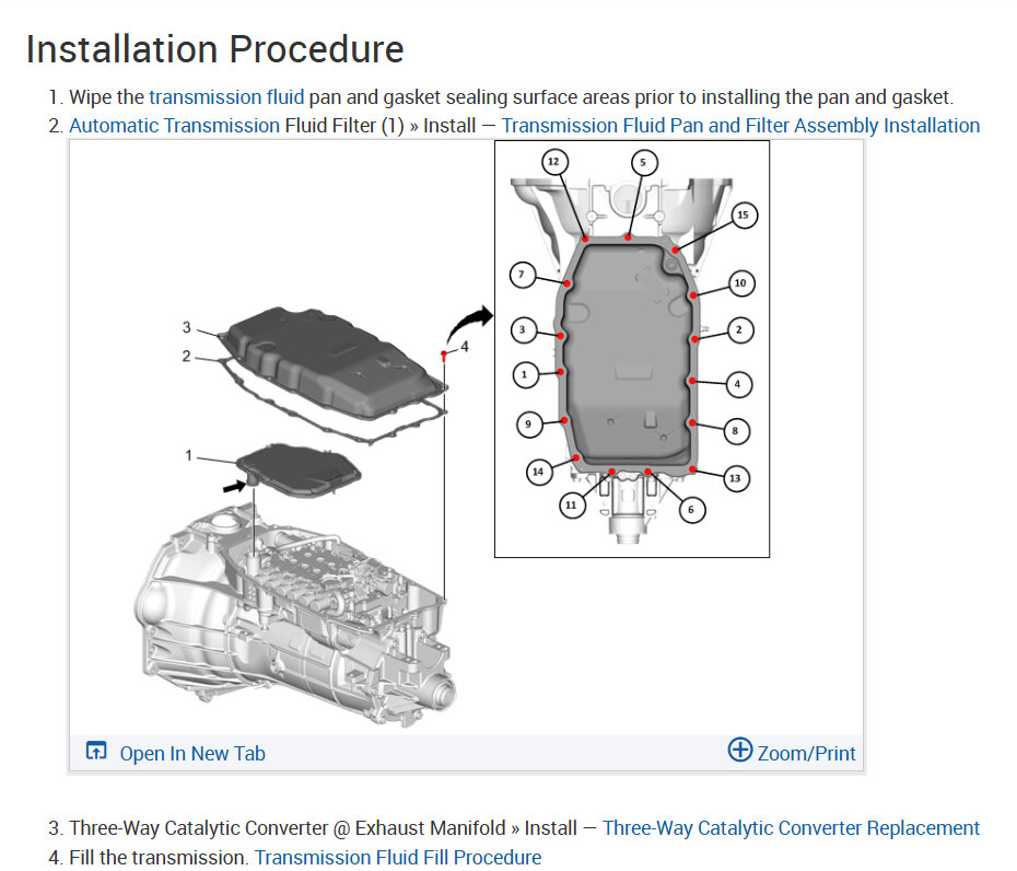

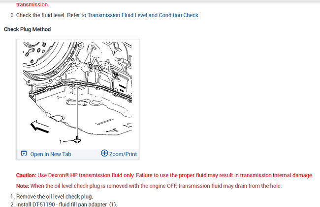

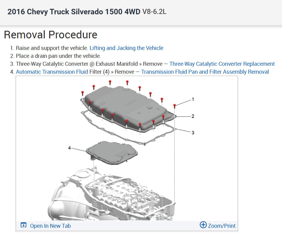

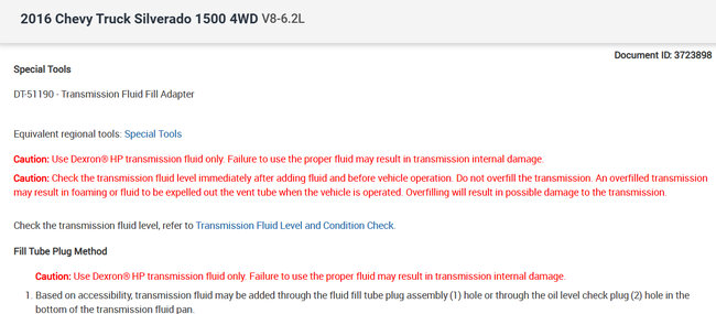

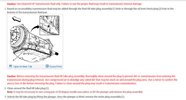

I would start by checking the transmission fluid level and condition and if you have not serviced the transmission, I would give that a try first and then clear the codes.
