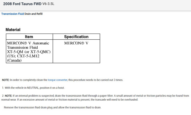

After driving at highway speeds continuously about 15 miles a wrench sign begins to display if highway speeds are kept eventually transmission fluid is spilled from the dipstick whilst driving as well as the loss of power due to transmission overheating, I think.
Jun 25, 2025 at 8:52 AM
  • 55,865 POSTS
We should start by checking the codes, this guide can help:

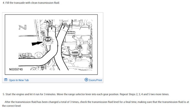

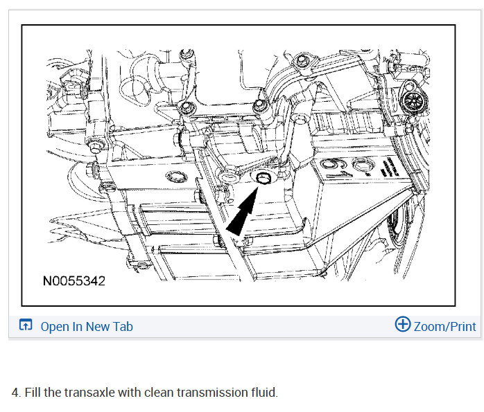

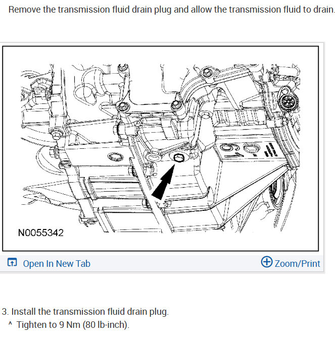

If the fluid is worn out it can make the transmission slip and overheat, this will foam the fluid and force it out of the dip stick, I would try servicing the transmission. Here is a guide to help with instructions below to help with your car:
Please go over these guides and get back to us.
