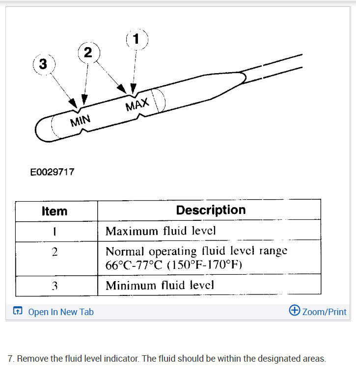

To me it sounds like the transmission needs to be rebuilt. I would check the fluid level and condition; this guide can help:
https://www.2carpros.com/articles/how-to-check-and-add-transmission-fluid
Here is how the job is done on your car. Also, you must use the correct transmission fluid.
Type .................... MERCON V XT-5-QM or equivalent
Check out the images (below). Please upload pictures or videos in your response of any problems so we can see what to help you with.

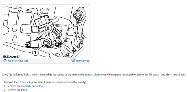

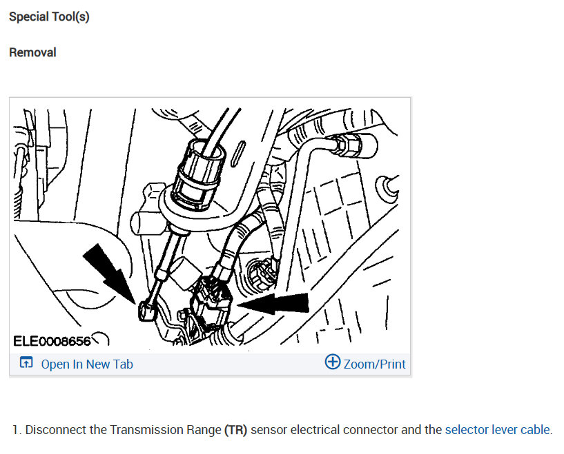

Okay, I'm back. i changed out the tranny filter and a new vss. reset PCM. started and let idle for relearn. then went to shift to reverse and that works. went to drive and it engaged but about 30 seconds later it disengaged. i watched the Ancel scan tool and the solenoids opened and closed through each gear. When engaged in forward gears the torque slip went to 0 then disengaged and went to idle speed. The speed sensors read no faults and also the solenoids at no faults. now I'm at a loss. i have live data info if you need any info from it. idk why it's still giving me the same symptoms as a bad VSS. help lol
Dec 7, 2024 at 11:59 PM
#TEAMGIBSON
  • 8 POSTS

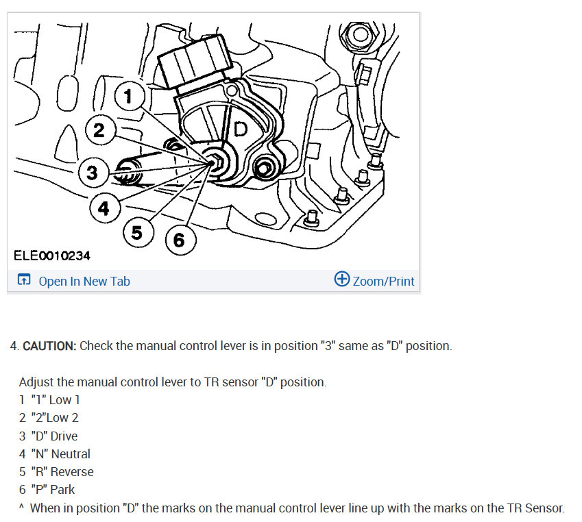

also, when it still was engaged in drive for a few minutes i gave it a little gas to move forward and it like stalled out. and i went to restart in neutral and it wouldn't so i had my hand on shifter and slightly moved it while in neutral with key to start then it started. seemed like the switch was a tiny bit off alignment like just a little bit.. could it be the neutral safety/range sensor just off alignment ? i know how to align it.. shift it to drive and the lever has a notch line up to the spot on the sensor itself ?
Dec 8, 2024 at 12:05 AM
  • 55,732 POSTS
Yes, this can cause the transmission to have issues if the gear range sensor is not aligned correctly or if it is going out. Here is how, so we are on the same page. Check out the images (below). Please let us know what happens.
Dec 8, 2024 at 2:14 AM
#TEAMGIBSON
  • 8 POSTS
its a new Ford OEM range sensor just installed last month but i will adjust it tomorrow morning and let you know. If it's not that, what else could make it be the same? as i mentioned before, after replacing parts i drove it a few times and it drove great. great shifts both up and down great acceleration and such then reverted back.
Dec 8, 2024 at 3:03 AM
  • 55,732 POSTS
Yep, this can cause the problem, the only thing we can go on is codes and the fluid level and condition. If everything is okay, you may have something inside the transmission that has broken like a main drum or clutch pack that is having an issue. Please let me know what happens.
