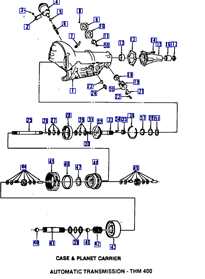

Transmission not shifting out of first gear

Transmission will not shift out of first gear.

It sounds like you have a shift modulator that is out or the vacuum line going to the modulator fell off. The part the vacuum line must go to is #4 in the diagram below
