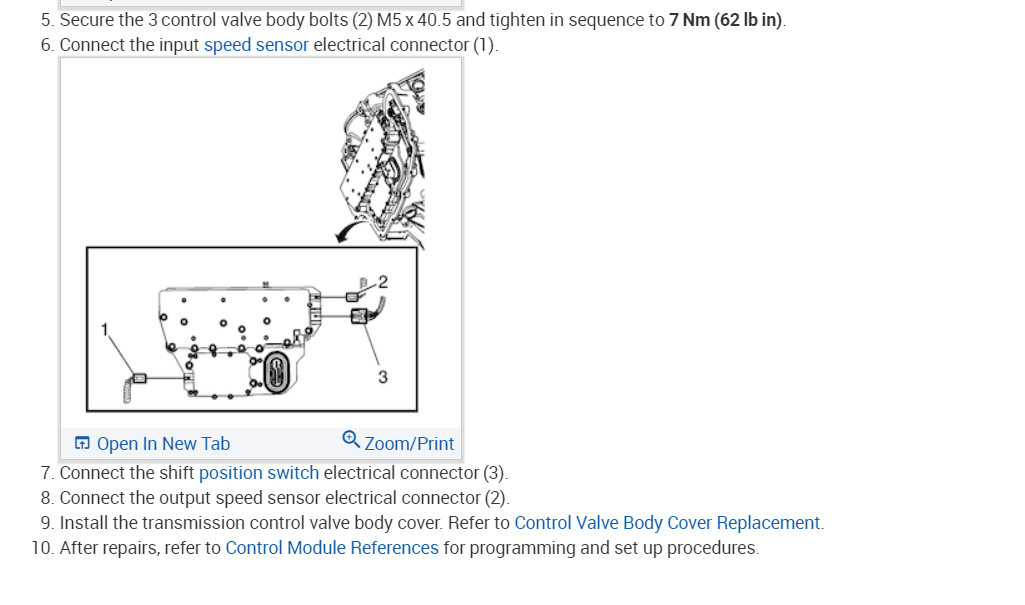

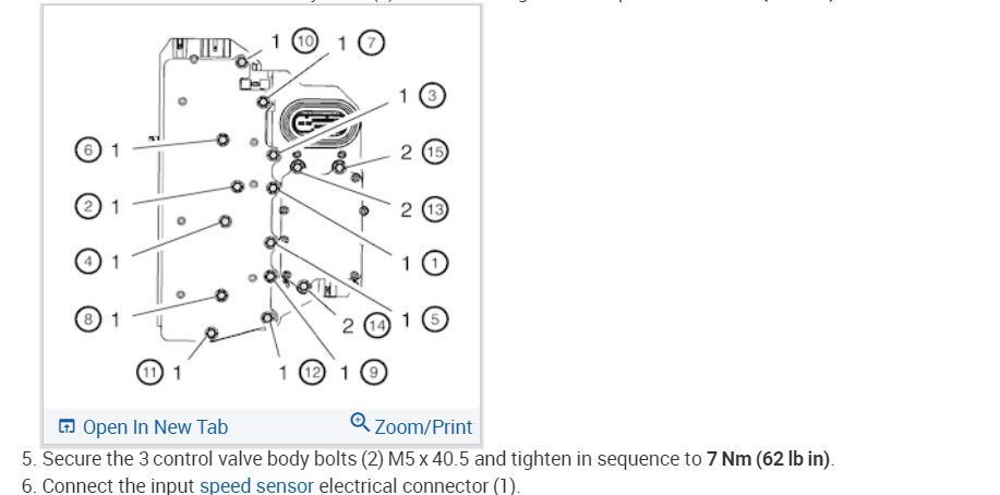

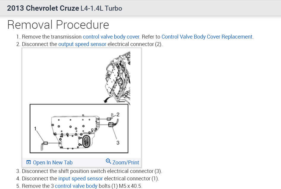

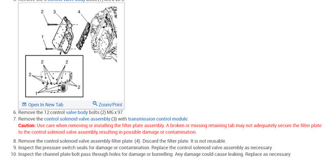

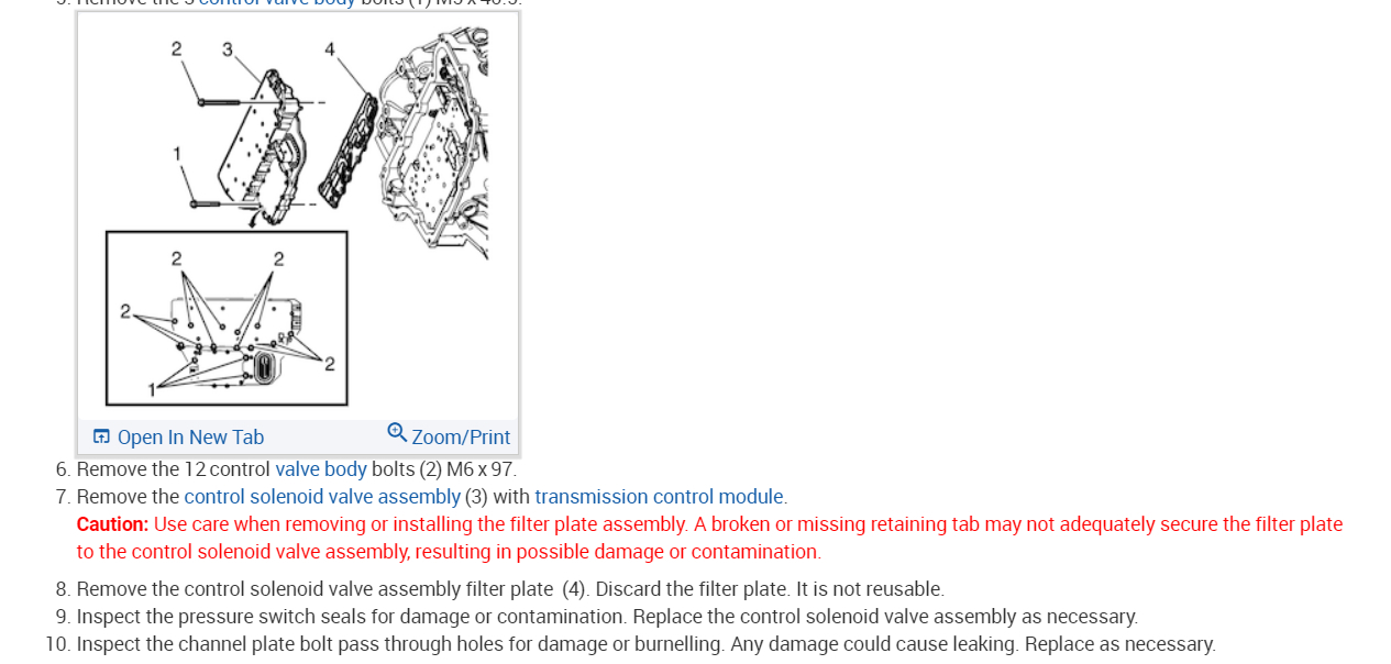

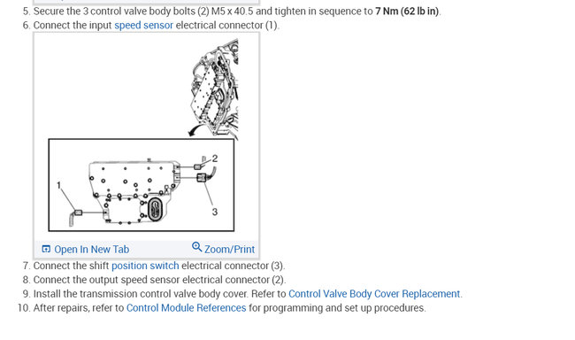

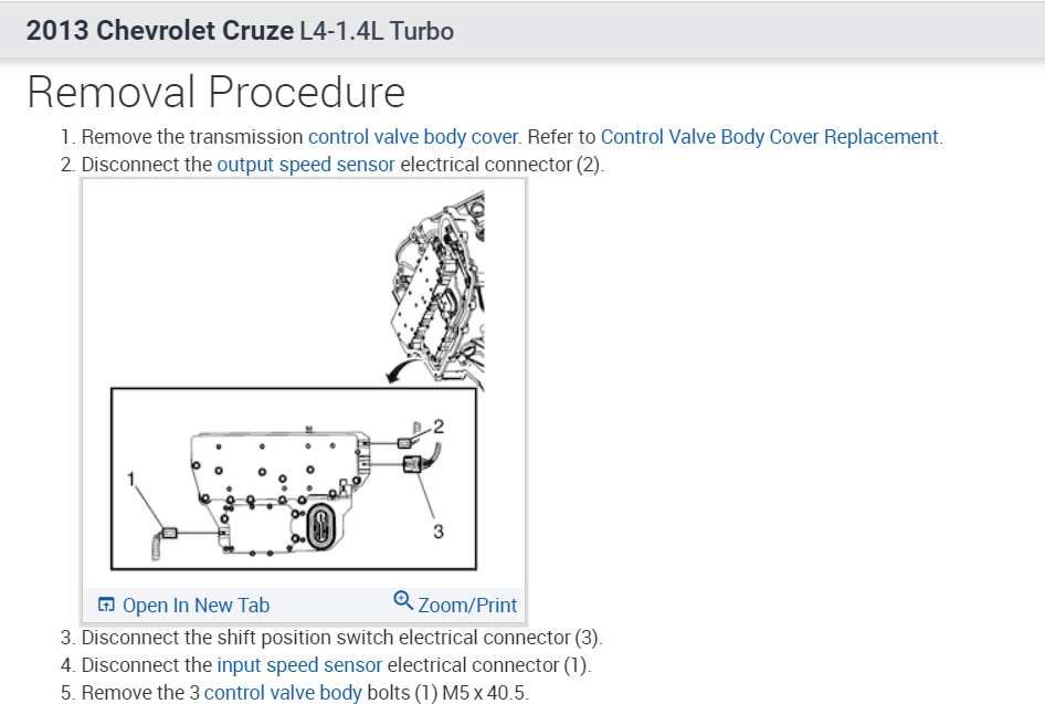

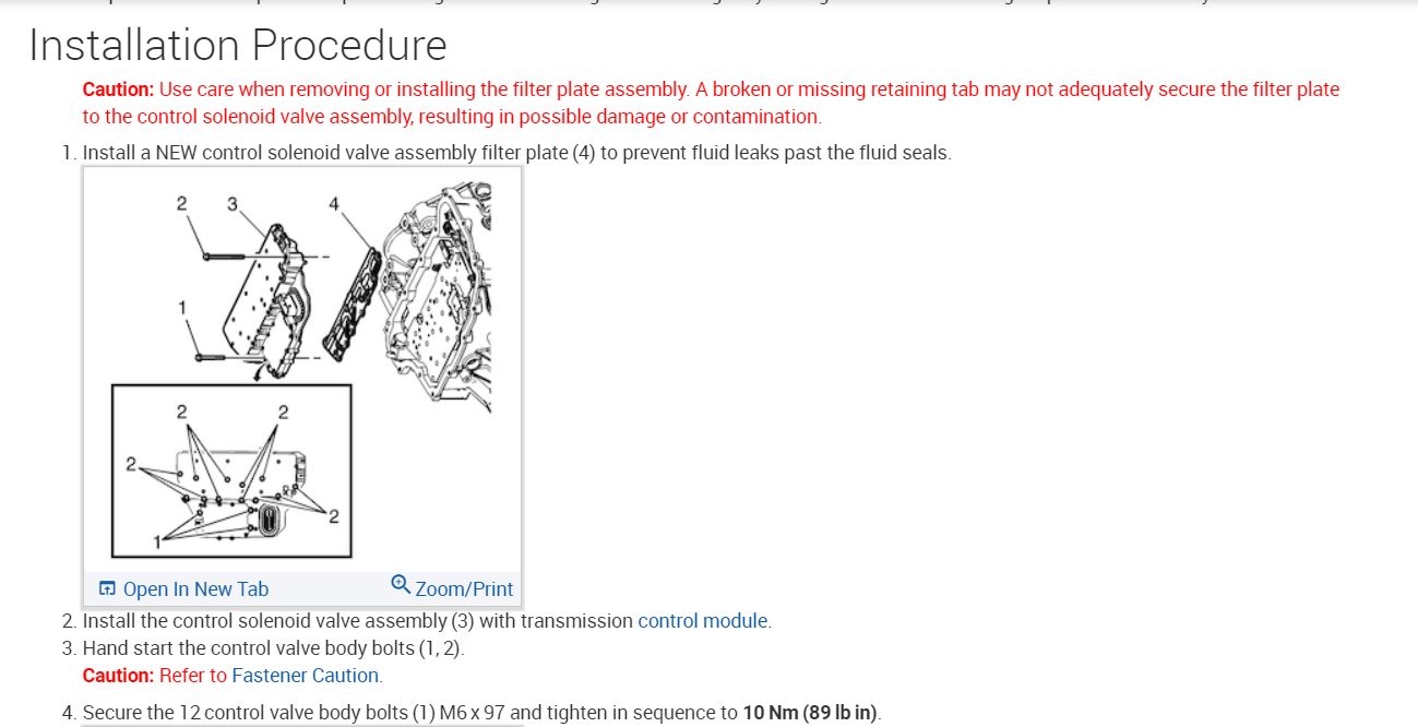

It sounds like the transmission is not shifting. We should run the codes to see what comes up. Can you tell if the engine is revving higher than it should?
Codes reader are inexpression now about $30.00 on Amazon. Can you please shoot a quick video with your phone so I can hear the engine noise? That way I can tell for sure what's going on. You can upload it here with your response. I would say the valve body may need replacement with a rebuilt or new unit. Just in case I have left the replacement instructions below. Please let me know what happens.

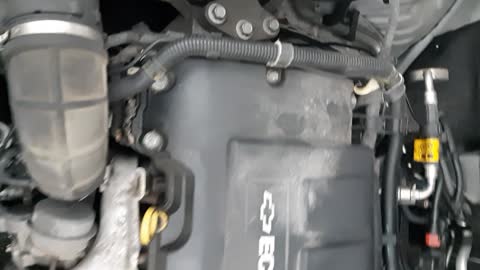

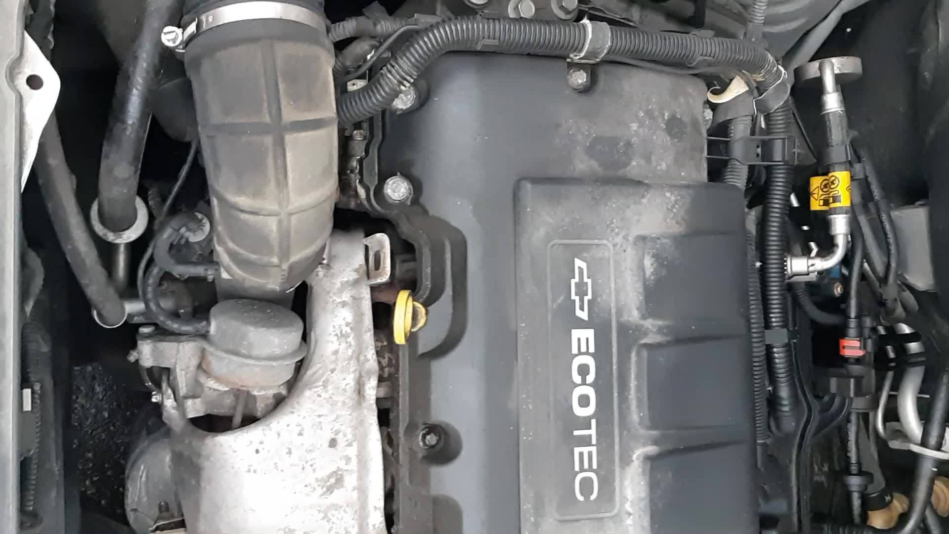

Here's picture of engine it should be a little video:

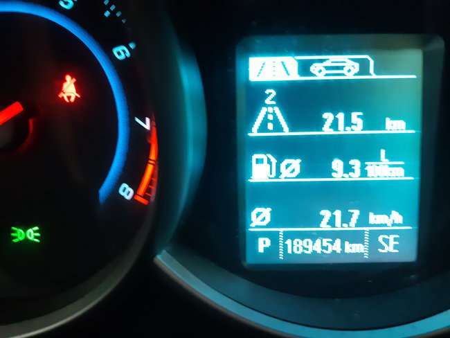

One thing also concerning my gas mileage, this picture shows a circle with a cross through it where my gas says 9.3 L per 100 km can you tell me if you think that's right, and can you tell me what that circle is with the cross through means if possible?

Thanks for the videos and images. Did you get a chance to run the codes? This seems like you have a problem with the car's PCM. That's why there is a zero with a line through it. You can get a CAN scanner from Amazon for about $30.00.
https://youtu.be/u-4syLc-ifQ
Here is a scanner link:
https://amzn.to/3o41KcZ
This will tell us for sure what's going on.

Yeah, I just did a bit of research and I think it means the circle with the line through it is European and it means average. I don't know if that's for sure but that's what I've come to know. I still don't know why I'm getting terrible gas mileage. Any help?

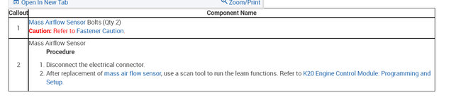

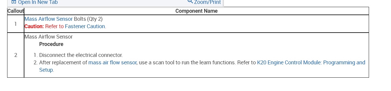

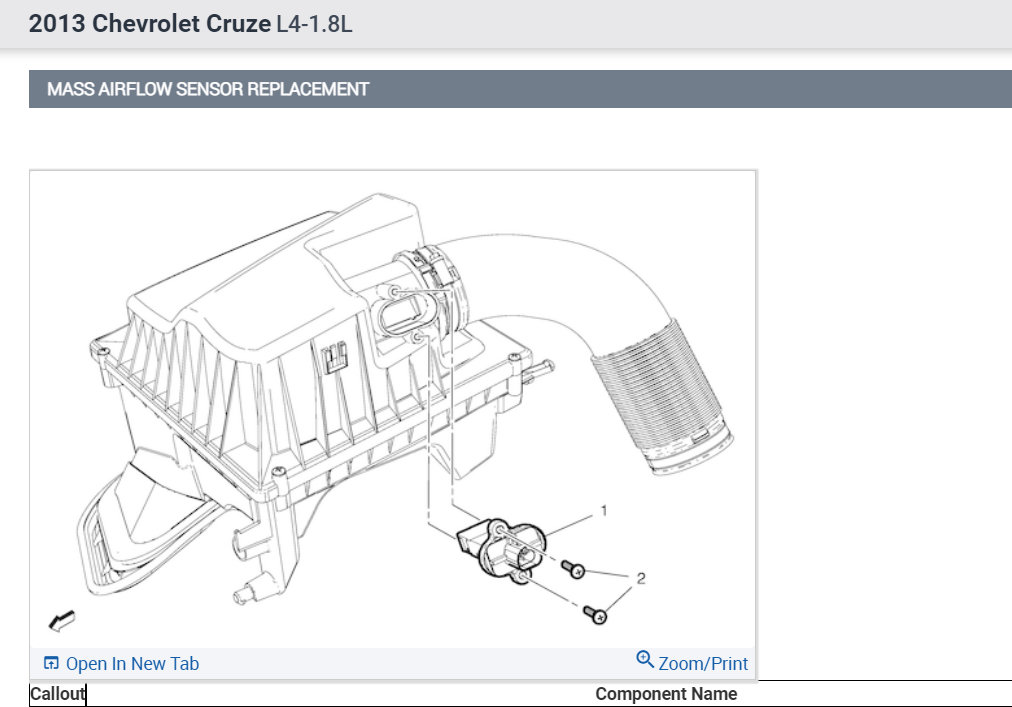

Okay, that makes sense, so this car has a MAF sensor that can be dirty was causing it to be off and tells the computer to dump too much fuel into the engine. Here is the location so you can replace it. Also make sure the tires have enough air in them. Also change out the air filter, it is dirty. Check out the diagrams (below). Please let us know what happens.

Hi Ken, I went out to my car, and I started it up open the hood, unplugged the MAF electrical connection and the car didn't turn off and then when I plugged it back in it the engine light came on, the code p-0097, p-0102. From those codes I think it suggests that I need to get installed a new MAF sensor. I got two other codes one was 60300 and the other one was negative 12,000,2 times for last code. The first two like I said suggest an MAF replacement for the other codes I do not have an idea. I did try cleaning the sensor I had no other luck. I was wondering if there was a way to reset the MAF to see if it is working or if I should just go ahead and get a replacement sensor, I'm still getting bad gas mileage.

Yep, once the sensor gets to a point cleaning will not help it, also, when the sensor is unplugged, the computer will substitute a default value which might be better than what the MAF sensor is outputting.

Hi Ken, Nathan again, that mass air flow sensor did the trick, the car is running really good. Now I'm getting about approximately 11 km per liter. I mean it's not a lot better but a little better. I was just curious if you thought that was fair or not, again thank you for all your help.
